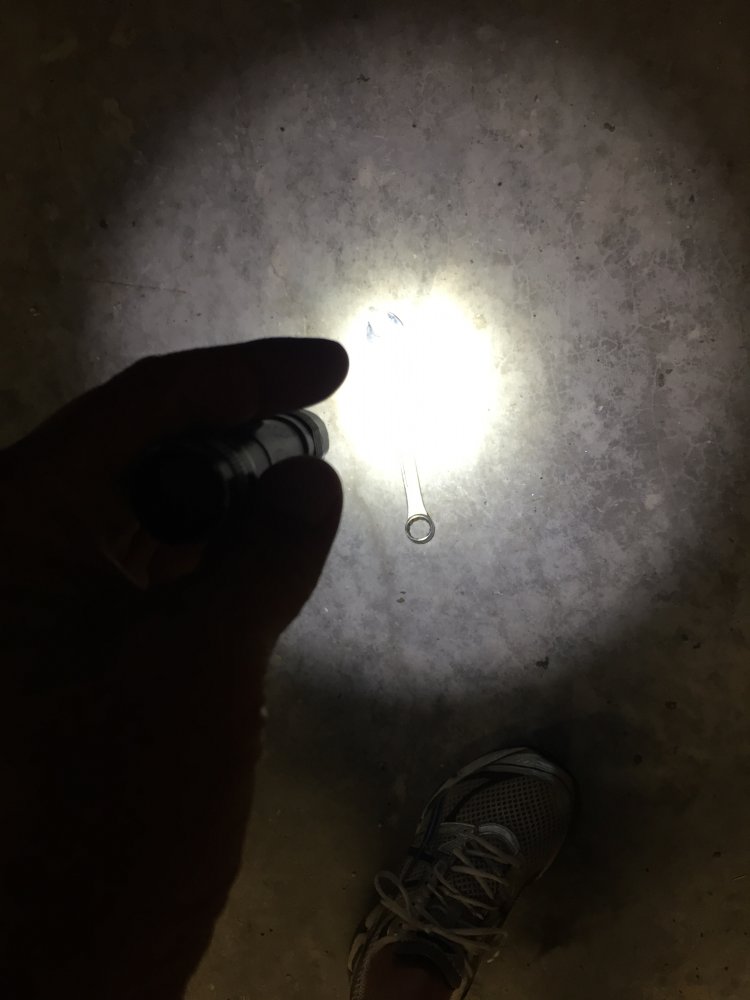

A very bright, $$, compact brand of flashlight. This is mine shining on a wrench on the floor of my well lit garage.

Any decent LED flashlight is just as bright, I wouldn't have spent that much for a flashlight it was a gift from a former boss-I tell the people on my team at work that the only good thing he ever did was give us those lights!
