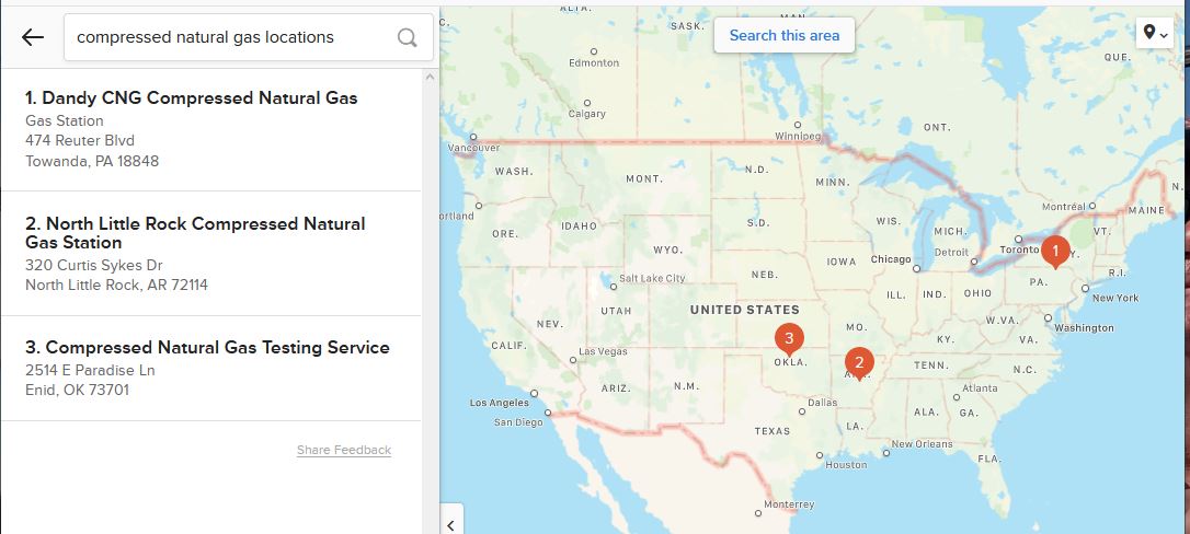

24,640
Here is what came up in a web search.
Not good for a cruising boat.
