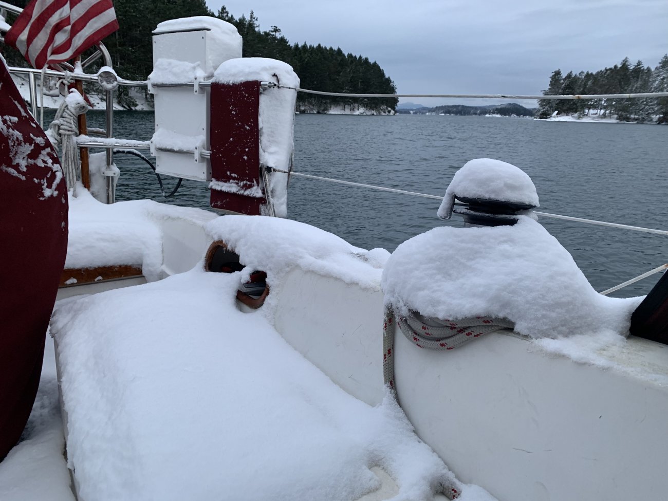

May 20, 2016
3,015
When I bought Mahalo it had 2 6lb tanks hung off the stern in fender holders. Very ugly - I made a holder out of 1” Al angle and pop riveted starboard to the outside then hung from the push pit. Looks so much better!! It goes with the white of our winter cruise
