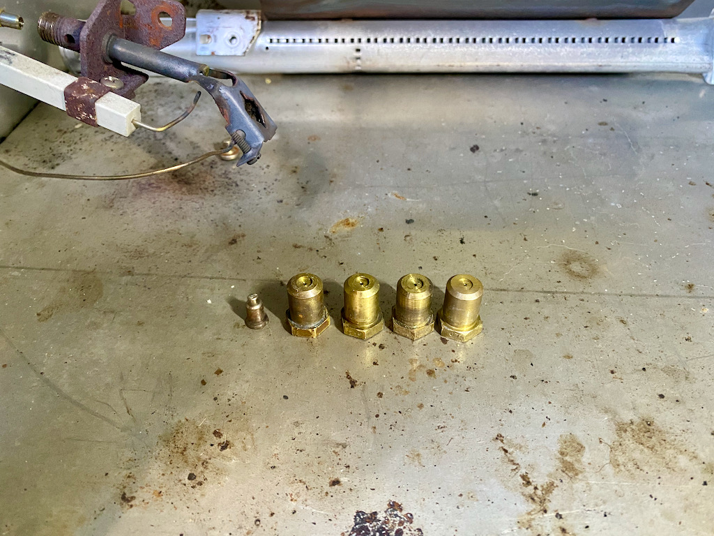

Dave is right, I doubt you'll find the kits that were offered when most of the CNG stoves were set up. That being said, I easily found the parts to convert my Tasco 3 burner and oven that was set up for CNG, new, in the 90's.
Most of the stoves used generic burners and other parts so your needed orifices will fit many marine/RV stoves. What I needed was available online from a marine stove outfit; 3 top burner orifices, 1 oven burner orifice and one pilot orifice.

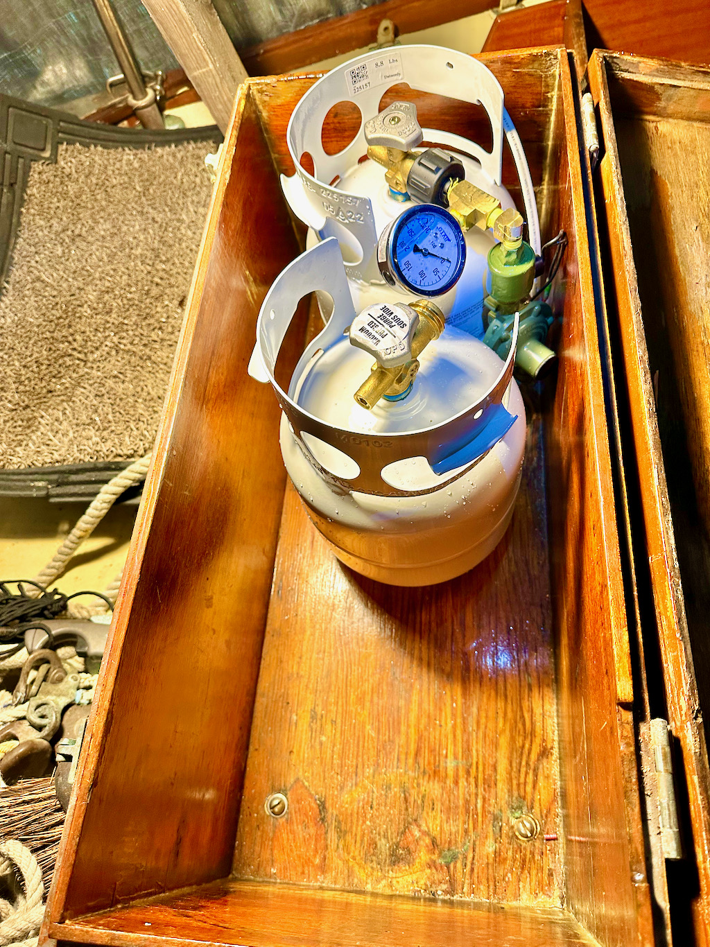

It was a cheap conversion for my situation. I had a deck box mounted (above decks) and found 5 pound LPG tanks fit easily inside.
We spend about 40 days and nights onboard in season. The first tank lasts nearly until the end of the season for us and we use the stove 2-3 times a day, even bake quite a bit.
Now I fill the 5pounders at home from 20lb tanks (correctly and with the right equipment). It's a breeze (compared to chasing CNG -supply-tank inspections-etc), and the savings for us being in Maine (150 and need to truck from Mass), paid for the conversion in the first season.
