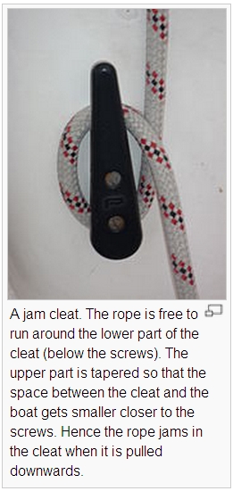

Replace the cleat with a Jam cleat
Never use a horn cleat for jib sheets or any sheet if you want to release in a hurry. Should replace them with a Jam cleat. You can run the bitter end backward to assist release.
I have self tailing winches. For the main and the jib, I always run the bitter end in reverse. All you need is to pull and it releases itself.
That's was a good story.
See picture.
I like that idea, I don't have self tailing winches.

If one properly uses the horn cleat It will not jam. I should, in deference to my friend Larry, point out that he wanted the furl in the jib before the gust hit, but I did not think it neccessary. Had we furled in when Larry suggested, we would have been OK. Had Larry tied a proper knot we would also have been OK. I share the blame for this fiasco. Both Larry and I are experienced and, once in the conundrum, we both responded well. There was no yelling and shouting. We both knew what had to be done and got it done.
