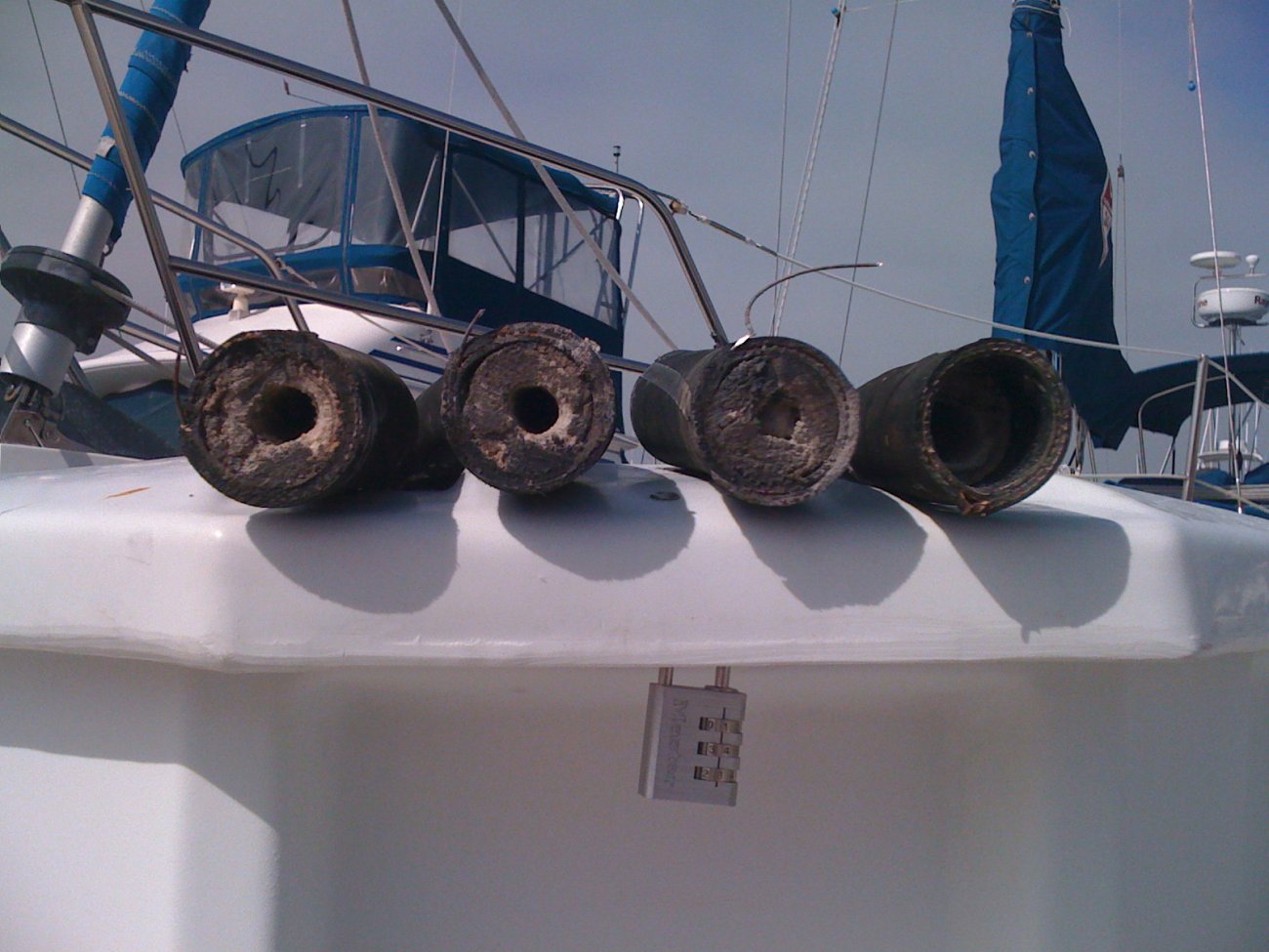

Not to bring up an old post, but you never mentioned what actually clogged your hose? Seemed unlikely that scale clogged it completely shut without some help from an object dropped into the toilet. Just a guess!
You'd be amazed at how much scale can reduce the diameter of a hose...see attached photo...and I've seen worse than that. In warm waters, which have a lot more sea water minerals than cooler water, scale can reduce the diameter of a 1.5" hose to 1/4" inch in just a couple of months.
Crusty mineral deposits from years of use. Combination of sea water flushing and human waste, some of which never made it into the holding tank at the end of a cruise would remain at a low point in the hose until the system became active with the next cruise. I place a lot of blame on the PO. I've been very diligent about flushing fresh water through both toilets at the end of each cruise. But it is what it is. New hose works great.
