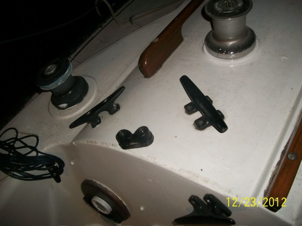

Last year (as purchased) I ran them to a moveable track, then back to fixed block... to winch and tied them off with a standard cleat hitch...
I was playing around with the idea of an open cam cleat to back up the stock cleat...Pull secure thru the cam and hang the line on the stock cleat...
I did however pick up some nice bulls eye swivel cams (in the correct size for the sheets) when I got some small ones for the traveler...
Would there be any advantage to removing the open cam and stock cleat shown above and just use the swivel cam for the sheet (off the winch) and then just hang the extra sheet/line off the cam between tacks...??
Disadvantage...? Just stay stock tie on cleat hitch...?

Don't use a captive style cleat for your winch aided sheets. You can use cam, clam, jam or simple horn cleat.... but no bullseye fairleads....why.... because you need to be able to throw the sheet off the winch quickly.... the line must not be captive in anyway. The blue "winchers" are not self tailing devices, but you can use the "jaws" to secure a line on a winch.... in any event I would never use them for a jib sheet applications. You'll note that I had them on my halyard winches in the first picture..... they were removed after awhile... I hated them..... and have since been replaced with rope clutches for each line.... way, way, way better.
The swivel cam cleat in the picture would be a disaster, it has a bullet fairlead... no, no, no.
The flat, horn style cleats in your picture are not properly positioned for the winches. The normal method is to install a "jam" cleat at a 5 or 10 degree angle to the line's exit from the winch. A jam cleat looks like a horn cleat, but forward side is able to pinch the line after you take a wrap around the back side. The cheapest, and most common way to secure a lin coming out of a winch is to use a "clamcleat''.... ronstan's version is called a vee cleat......... but, again, use the open, non-captive styles so you can quick release you sheets. Here's a pic of my set up:

Makes perfect sense not to have the "eye" to deal with when tacking...
Looks like the open cams are the right choice...
Just need to rotate the horn cleat a few degrees for proper alignment
