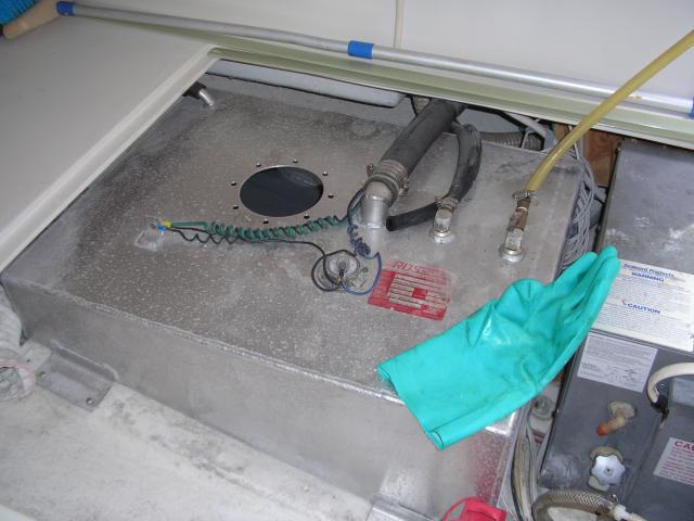

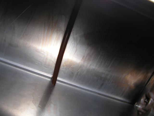

I cut an access hole in my tank. At the end of each season I drain the diesel, open the cover and wipe it clean with a little acetone on a cotton rag. I visually check inside just before re-commissioning in the spring.

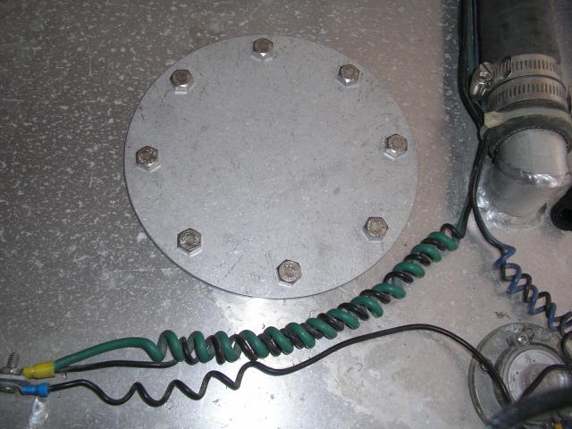

If you do not have a clean out port it is a good time to install one (assuming the tank is in good shape). I would have it inspected to be sure that it will last another 10 years before you install the inspection plate.
