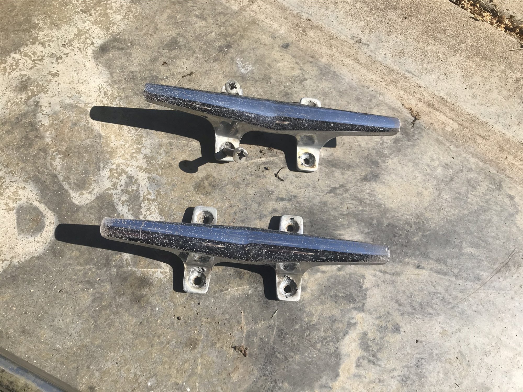

I am using these cleats to replace the forward port and starboard cleats on my Mac. Thought I would take the opportunity to clean them up before mounting them (crazy right?). Any suggestions on how to go about cleaning them up? They are from a 75 powerboat and are very solid and just have those minor bumps.
If you have a reason why, feel free to chime in with leave them as is and mount them as well.A9609ABD-D075-4247-B972-0121AA131C33.jpeg

If those are stainless steel cleats, then a buffing wheel and buffing compound for metal will clean them up nicely.
However, if they are chrome plated or nicely plated bronze, buffing them may remove the plating. On the bottom of the cleat, scratch the plating to see if it bronze or stainless.

I tried scratching with a nail and with a stainless screw and couldn’t make a dent in it, so I’m going with the buffing wheel and compound. Pics to follow.

They look plated to me. You can use polish, but the pits are there to stay and will grow. But they don't hurt much.
The question is whether they are bronze (good) or Zamak (bad).

Personally. I’d try some metal polish, like Flitz. I always have a tube on hand. Great stuff and safe even on anodized aluminum.
If the Flitz cleans them up, I'd follow with Collinite metal wax. My SS cleats look like chrome with it even after a winter.

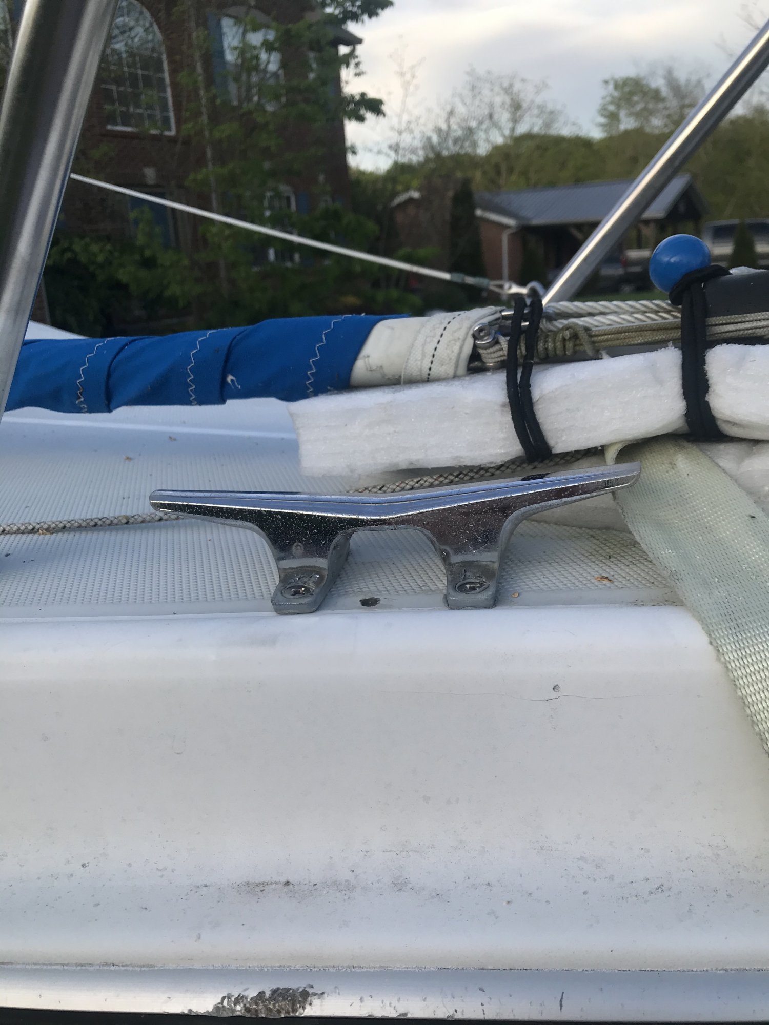

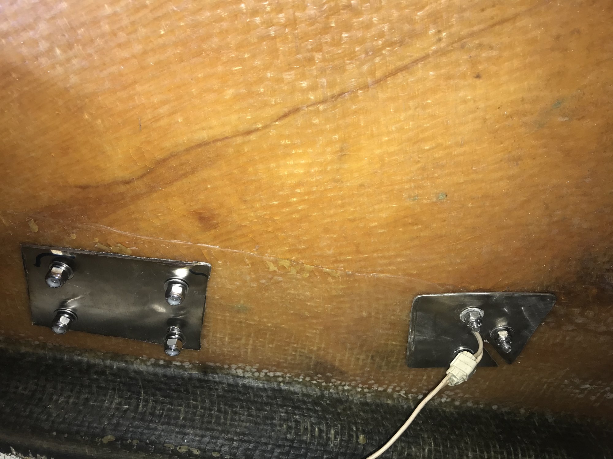

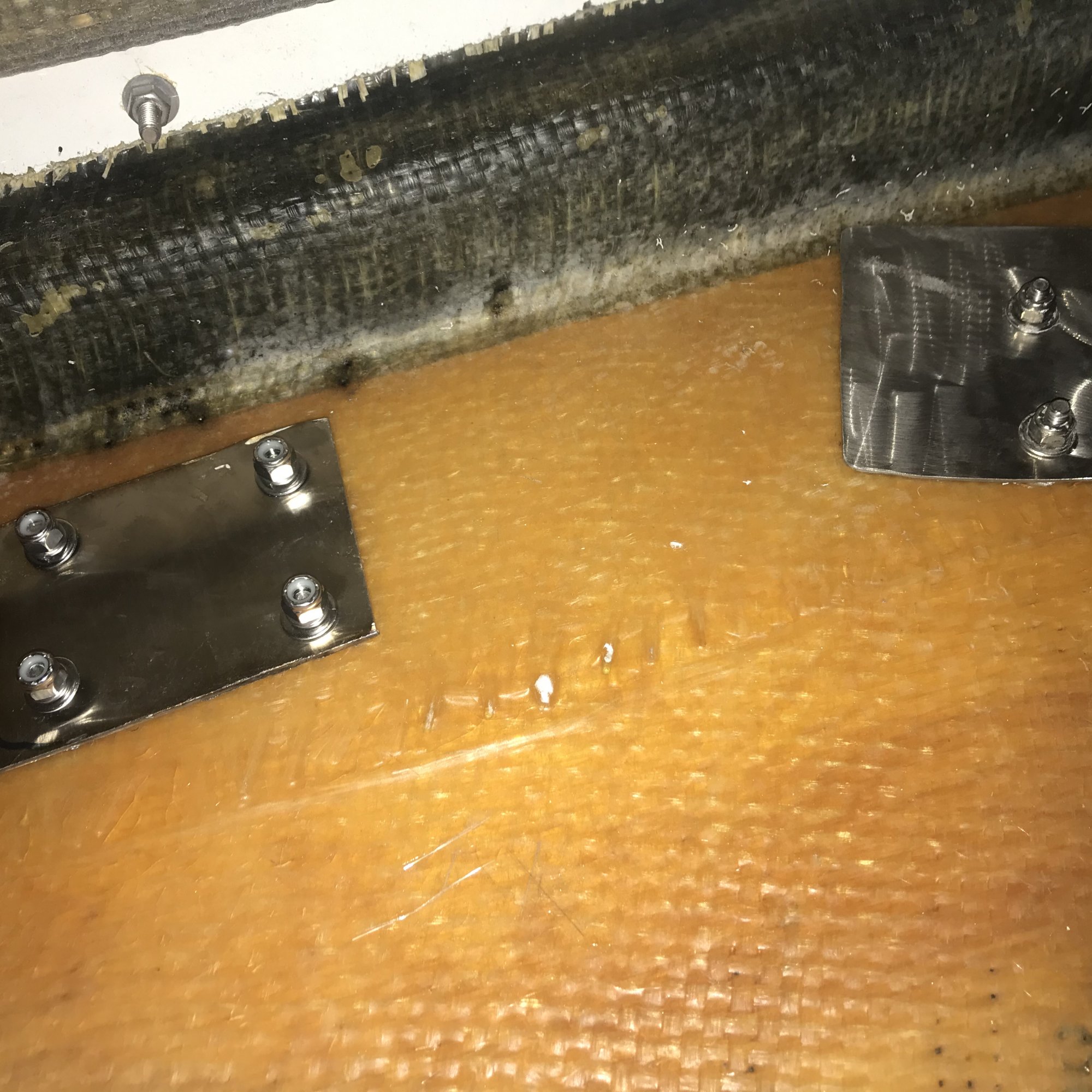

Ok, have the forward cleats replaced. You can see the backing plates I used for these. The other backing plates are from when I rebedded all the hardware. The one with three holes and the wire is the starboard pulpit.
The backing material is industrial stainless. I picked up several stainless steel “tea dispensers” for .06 each. Received the normal, “What are you going to do with those question?” The answer, cut them down and making backing plates for everything!
The dark spot under the cleat is the 2nd hole from the original cleat that I have filled. I need to put some grey color on top of the filling to come close to the non-skid to make it not as obvious.
