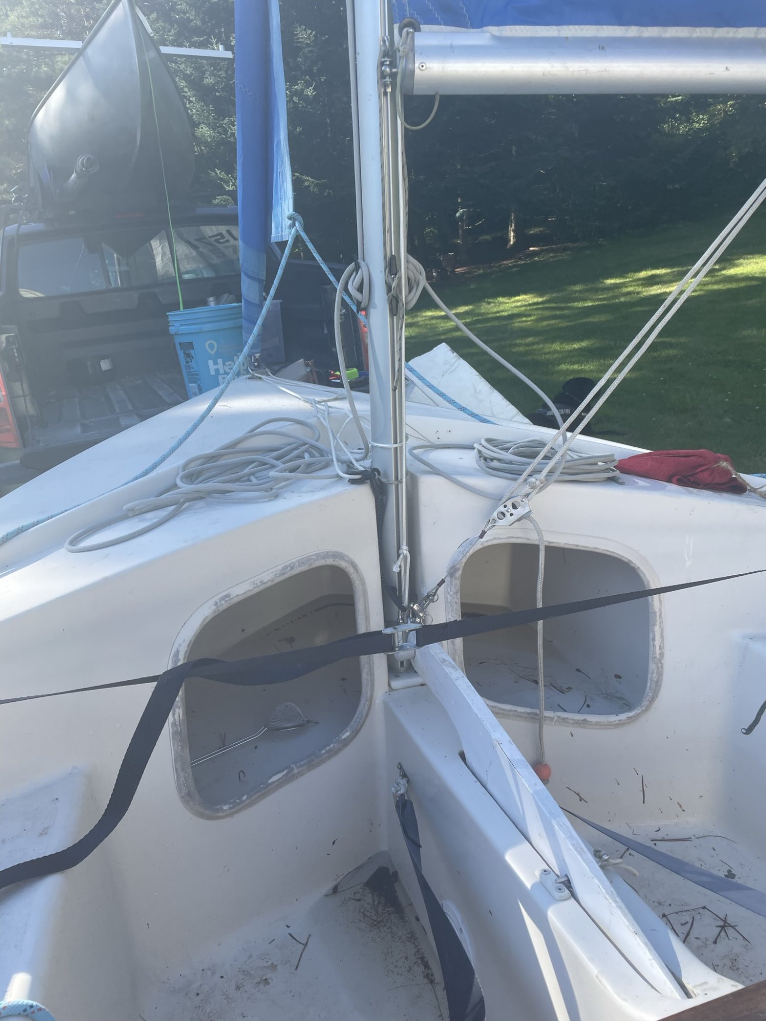

The image helps. It appears the mast sits on the center board frame. That should be pretty easy to raise, while in the boat or with the boat on a trailer. Looks like you have a furler for a foresail. I’d consider adding a line to use for hoisting. Attach a block 2/3ds up the mast. Run a line up to the block and down to the forward base where you mount the foresail furler. Standing beside the boat a person could pull down on this line while you lift the mast forward into place. Holding your lift line you could then fasten the furler to the forward base. When the mast is raised just tie off the line to a cleat on the mast Ready to use when you want to lower the mast.

Looking at the picture, my mast setup is identical, but as you noticed mine is set for pivoting. The only difference I see is the lack of a bolt going through the fibreglass and the mast. This should be easy to fix with a drill....
At the base, my mast has a plastic connector which slides into a groove in the boat. I can comfortably raise and drop the mast by myself, with some muscle work tensioning forestay. I will improve over time as suggested by jjsailem. No rush on that, the boat is in the marina on dry but with the mast up. My goal is to be self sufficient in launching, sailing and retrieving the boat.
