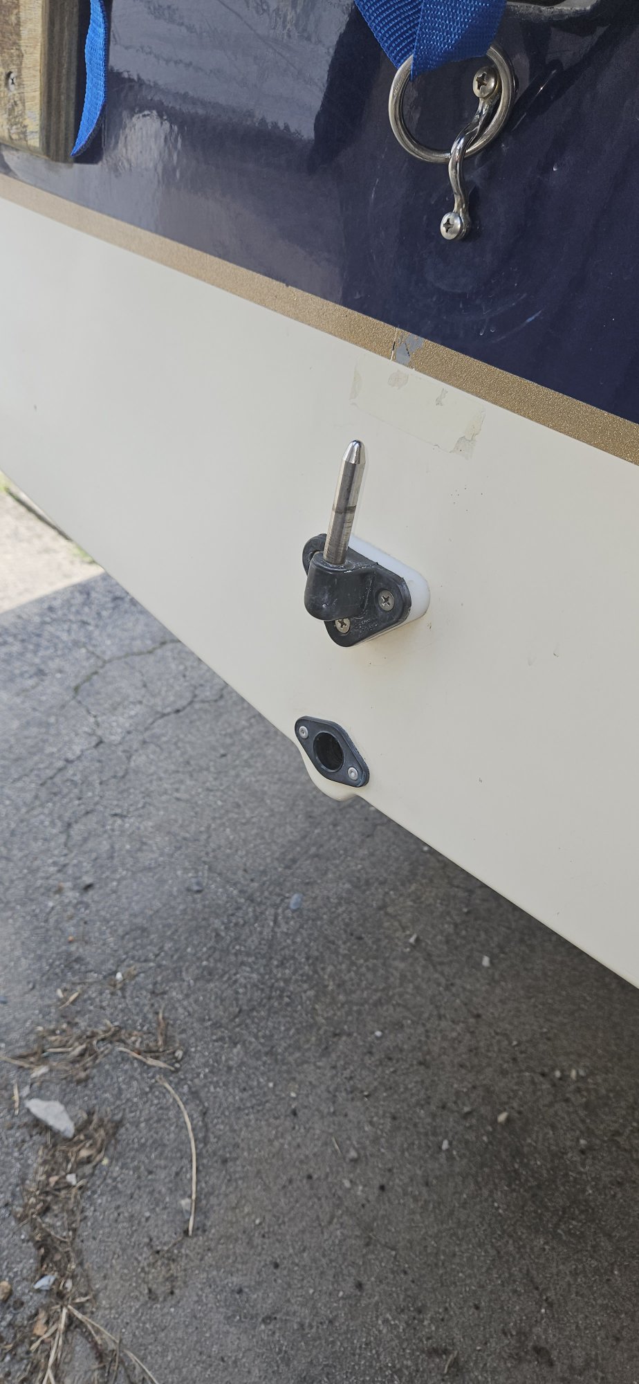

Another question: it seems that I don't have any plug in the transom. The plugs from the inside drain to the outside.
Since the outside plug is missing, the centre of the boat would not stay full of air, thus getting lower and allowing water to fill it. Am I reasoning correctly?

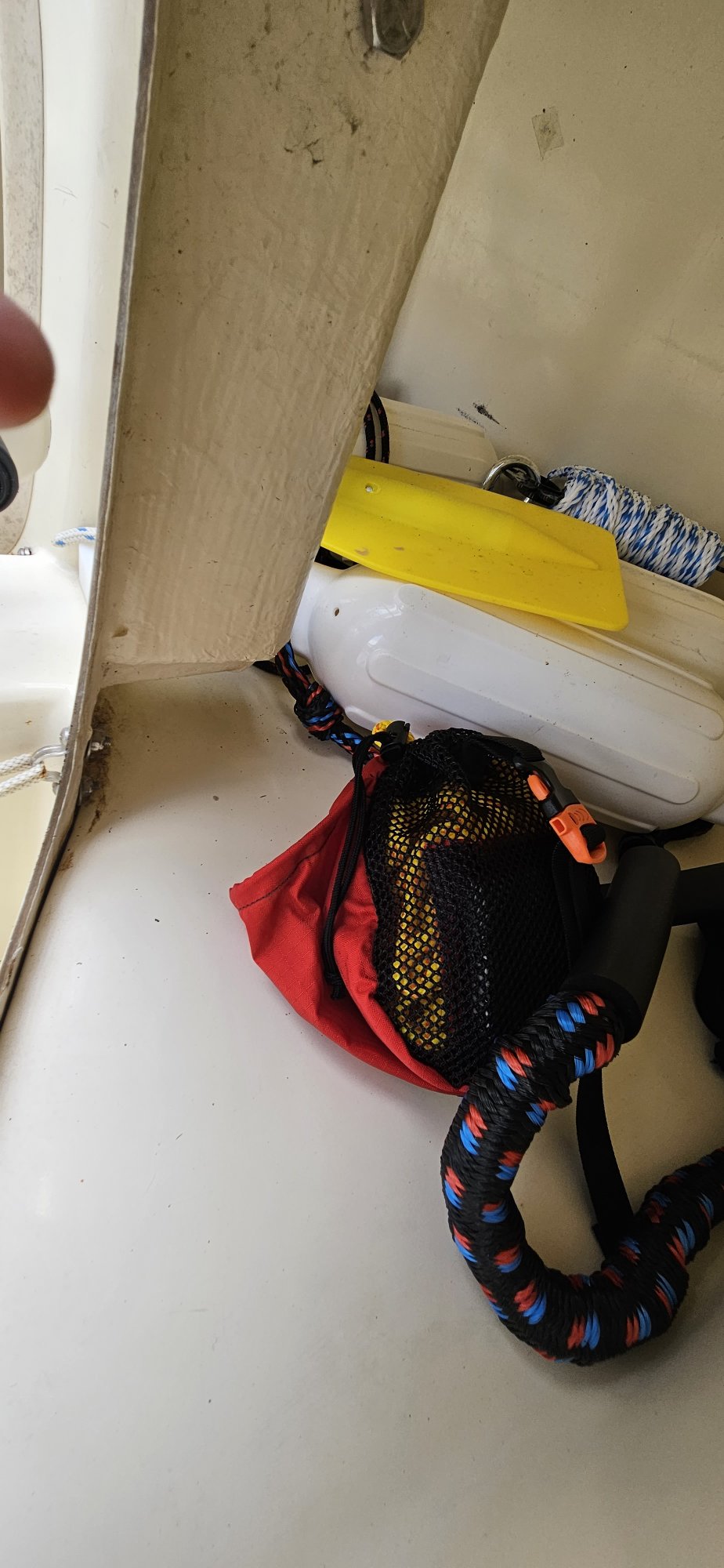

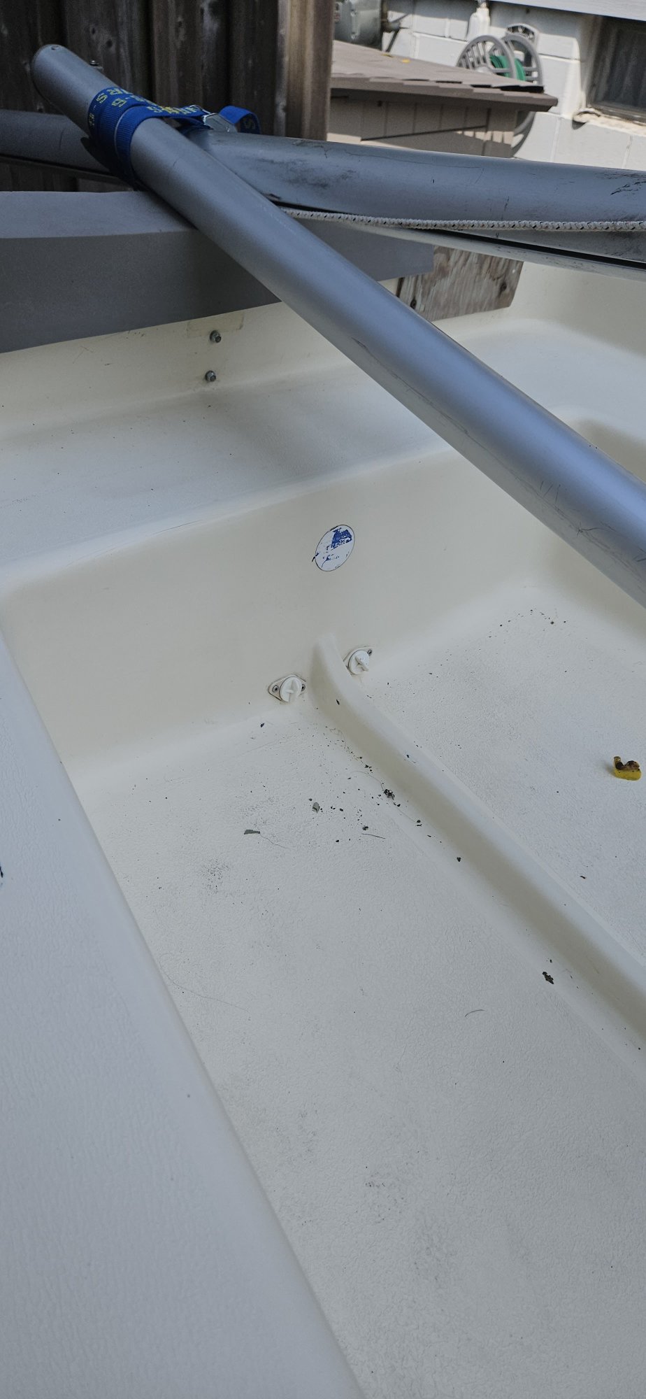

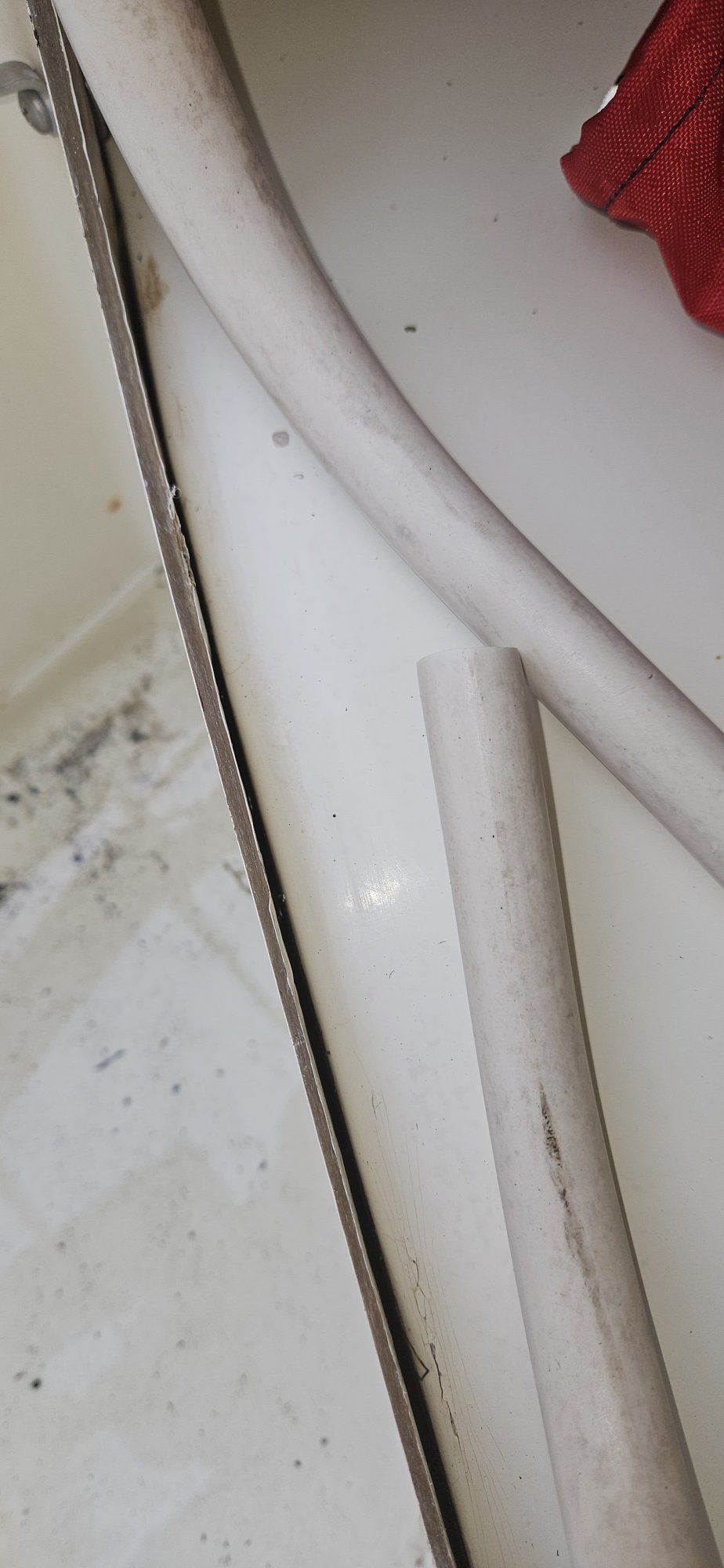

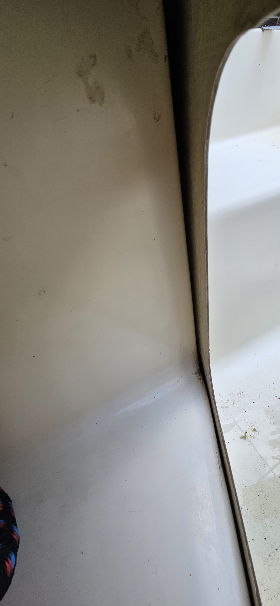

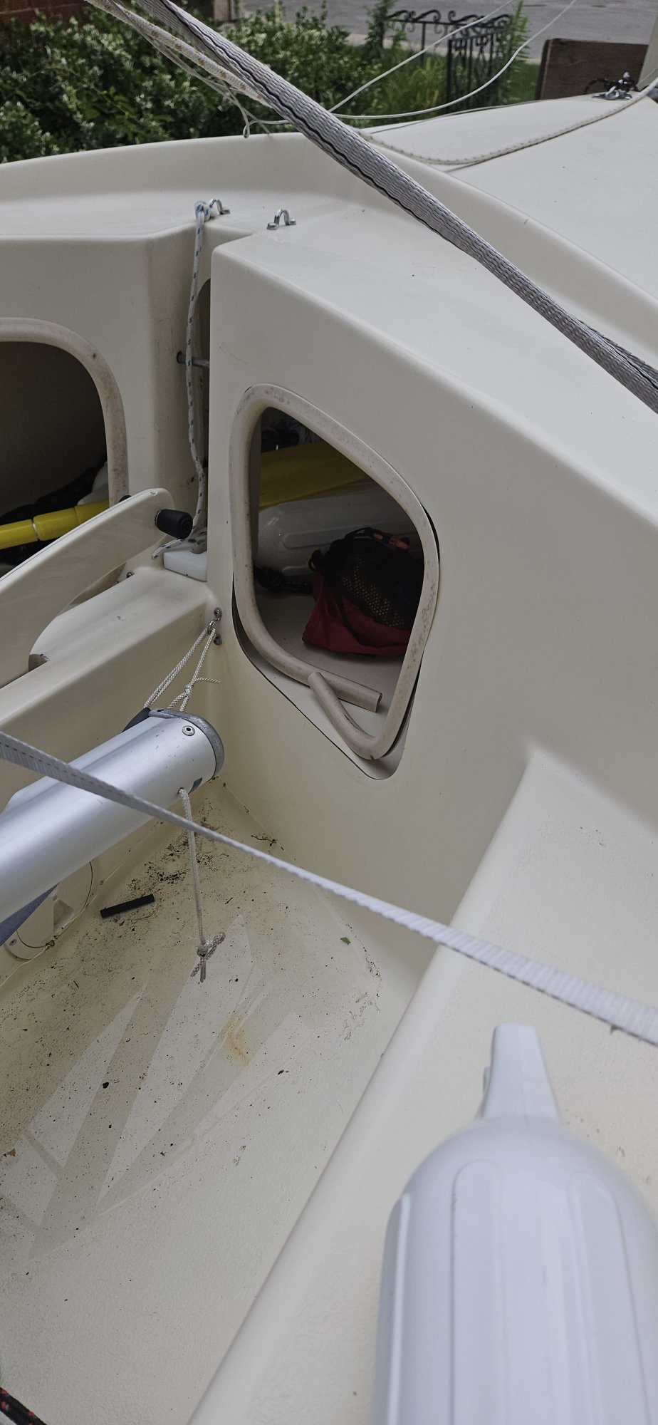

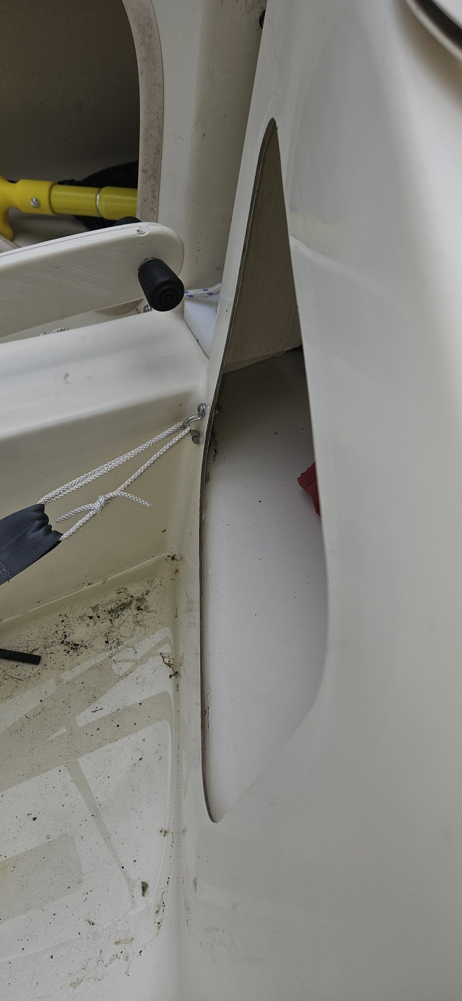

Last pictures show the gap between the front gap of my storage and the storage floor. All water from there goes directly into the hull. I am not sure I understand tow this is supposed to work in a capsize situation?

Your two first photos show the drain plugs used to empty the space between the two hulls that form the boat. They have to be closed before putting the boat in the water. Only the bailer in the bottom of the cockpit may be open.
If you have water coming out when they are opened outside the water and on the trailer while tilting the boat, then you have water entry between the hulls and it should be traced and repaired because your boat is not waterproof and water getting in will make it heavier and lower on the water, and eventually sink it and you along while you sail.
Your third photo does not tell me anything, and the fourth shows the space for putting spinaker and other safety stuff or watever you want aboard on your sail trip. This space has to be water tight too.

You were right with your reasonings. I just did not read you twice before replying. But what I wrote still stands!:)

And the gap between your storage ans storage floor should not exist. As I wrote, no water should go between the hulls!!

Sorry couldn't get a better angle on the third photo, but I think your explanation confirms what I suspected. The place where you store the spinnaker leaks water into the hull, and the photo was taken from the inside of the storage. Maybe the next few photos will explain better.
The connection of the storage floor with the front wall where the mast is stepped look like have no seal of any kind from factory. When I cleaned the storage with the pressure washed it happily drained out of the transom ad fast as I filled it. I cleaned out lots of leaves and dirt from that gap.
It makes sense that this space should be watertight and form a nice air bubble when capsizing.

To seal I would dry out the gaps with an hair dryer and after, apply a generous bead of urethane sealer like the ones used in construction with a sealer cartridge gun. Or if the gaps are too wide, inject expandable foam in them, then apply bead sealer. The true work would be bonding the hulls and gaps with epoxy, but that is a lot more work!
To verify for other leaks I would take a vacuum cleaner (the side that blows air) and blow through one drain plug with the others two in place, and check all seams with a solution of soap and water, sprayed on the suspect areas.
Remember to only apply a low pressure air to the inside of the hulls not to make them bulge under pressure. When you are finished and the boat floats superbly on the water, you will need a good beer to celebrate your hard work!:thumbup:

Thanks! I was thinking along these lines. Epoxy may be a bit of a problem because cleaning that gap properly for adhesion may be impossible because I cannot verify if it is clean. I am also not certain which kind of epoxy to use.
Buy I like the idea of doing it really well, even if I have to work on it like a mule.
I am still puzzled that there is no sealer from the manufacturer?

Probably it was bonded together at factory but the joint let go over the years! Maybe you can try to reduce the gap by placing screws at different points but it's up to you to decide what to do.

That is quite possible, because there is no way to see between the members.
Also, a friend who owned a cl16 ( local copy of the wayfairer) told me that his compartment was sealed. The construction of the front of both boats is identical, which leads me to believe that someone dealt with his as it aged.
The gap is rather tight all around, a thickened epoxy should have no problem with joining the parts.
