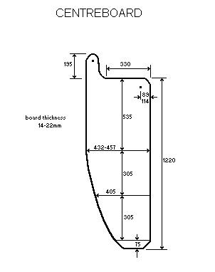

Can anyone help me find a centerboard for a CL14? Perhaps someone has an idea what are its dimensions so that it can be made?

Thanks @jssailem , I gave that a read and then further found that they are still out of business so I figured that making a new centerboard from scratch is the only option. So far I am looking into the racing classes that the CL 14 design seems to be related to. The "Enterprise", "National E" or "Lazy E" boats may share very similar parts (I saw this claim informally on other forums) with the CL-14 and I did find plans for the centerboard on those class association websites which seem to be roughly the correct height. If I actually get the boat I will be able to confirm whether those centerboards will fit the CL 14. Here is the diagram that I found. At the very least its a rough starting shape of a professionally designed racing dinghy.

That is a good-looking shape. Dinghy centerboards are not overly complex. The fit is important. Validate the proper thickness using the boat trunk.
From sailboatdata, we find that the centerboard sticks out 3ft below the hull
Max Draft:3.50 ft / 1.07 m
Min Draft:0.50 ft / 0.15 m
You would need to measure the distance from the hull bottom to the pivot point in the centerboard trunk. Then add a couple of inches to that to finish the top of the board.
