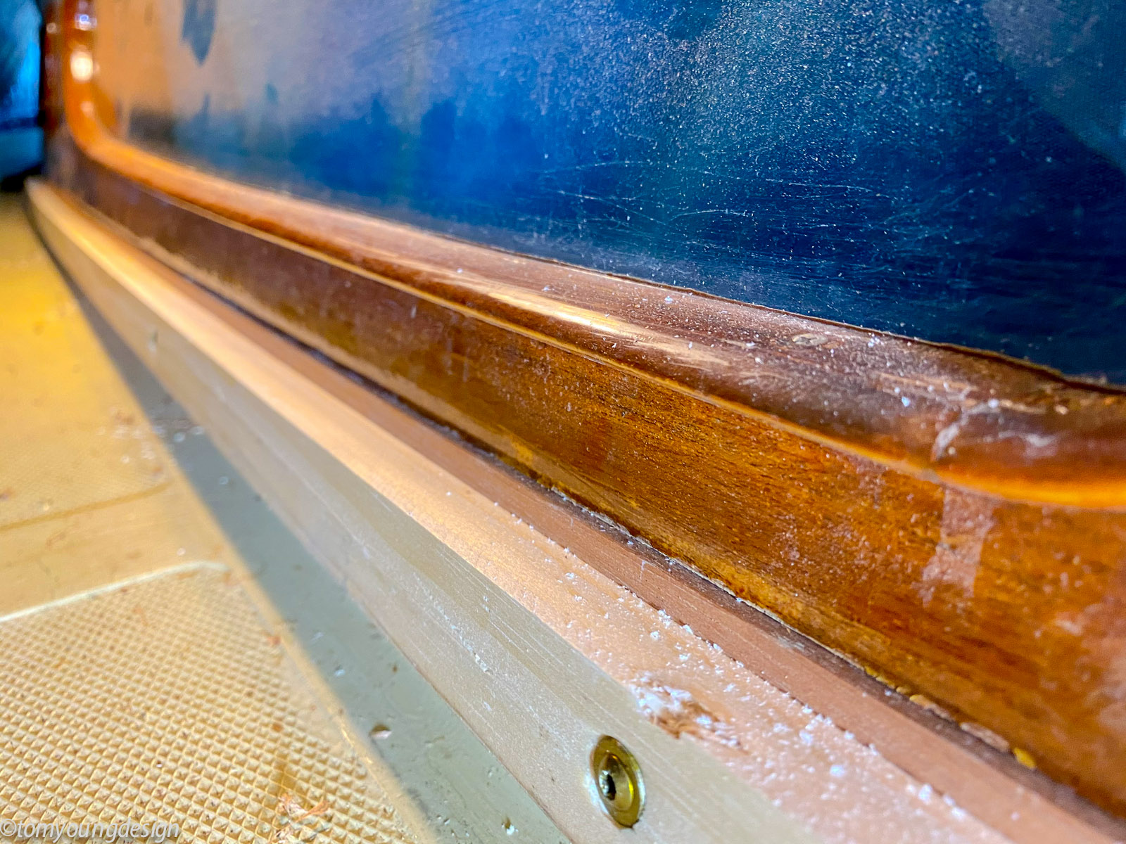

I understood: Removal meant cutting the damaged (by moisture and rot) wood out. I was already prepared to fit another 'Dutchman patch' to the old house. The only tricky part is, the narrow patch is nearly 20 feet long.

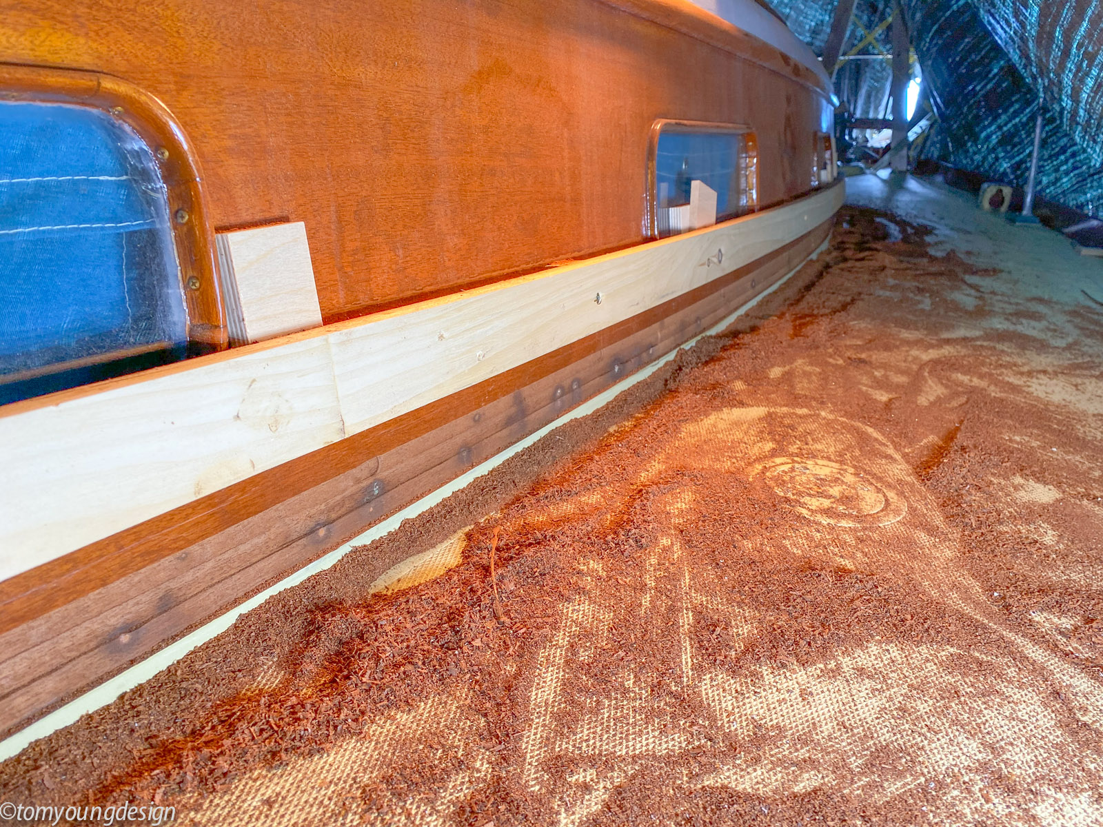

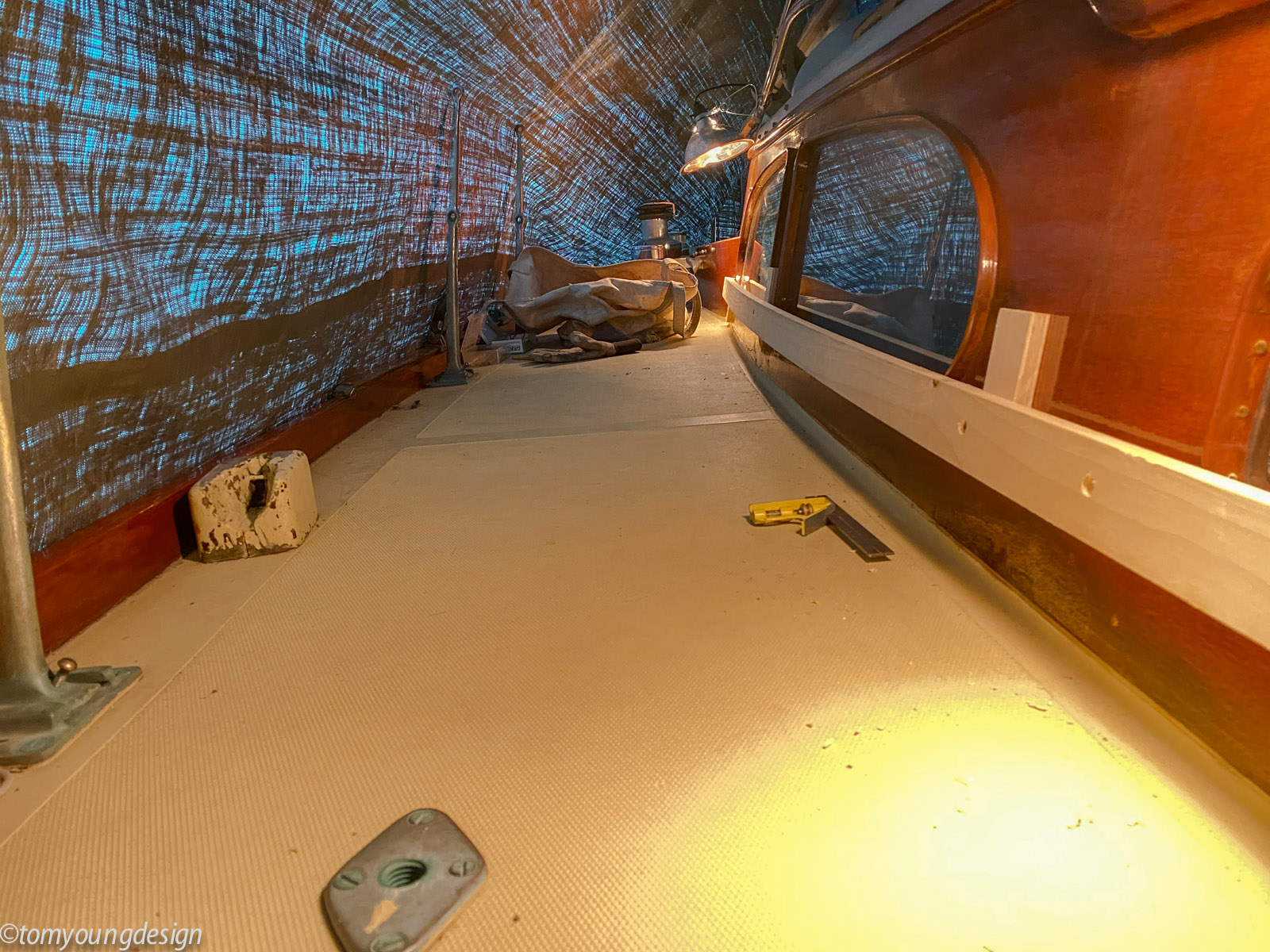

She's turning 60, it's time to fix this area once and for all. I scarfed a long straight pine 'track' together with epoxy and mounted it along the house: A boat yard probably would have removed the port trim but that was all reset about 10 years ago and tight as a drum. This made it tricky to get the track a uniform distance away from the cut area. But with spacers and a few shims, I got it.
The track is a rail for my router with an offset bit and fence to ride. It took a little courage to throw the switch and 'start riding'.
A few minor adjustments in depth and set, and water darkend wood started flying. I'm all in now.

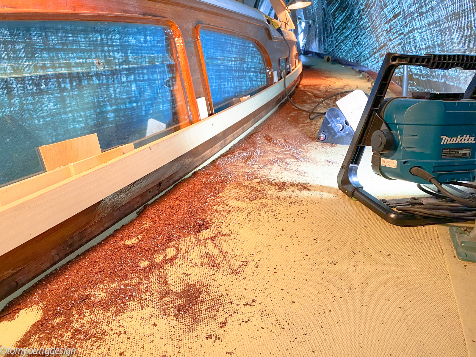

I decided to go three passes for a total 1 1/2" patch.
This revealed what I suspected from some a similar process I did on the front of the house: Above the house to deck joint, the screws from that mount the interior handrail are within an 1/8" of the woods exterior surface. Some thinning of the house is expected after 60 years but thanks to experienced care in the past the house thickness is still ample. The screws for the interior handrails were overset 60 years ago. So with carbide bits, I nipped off the points of the bronze screws as I plowed the wood off.
See the water stains around the interior handrail fasteners? Water makes wood move, expand and contract. The screw points so close to the surface would part the wood grain invisibly to the eye. In short order a little water finds it's way in, expands, dries and contracts.

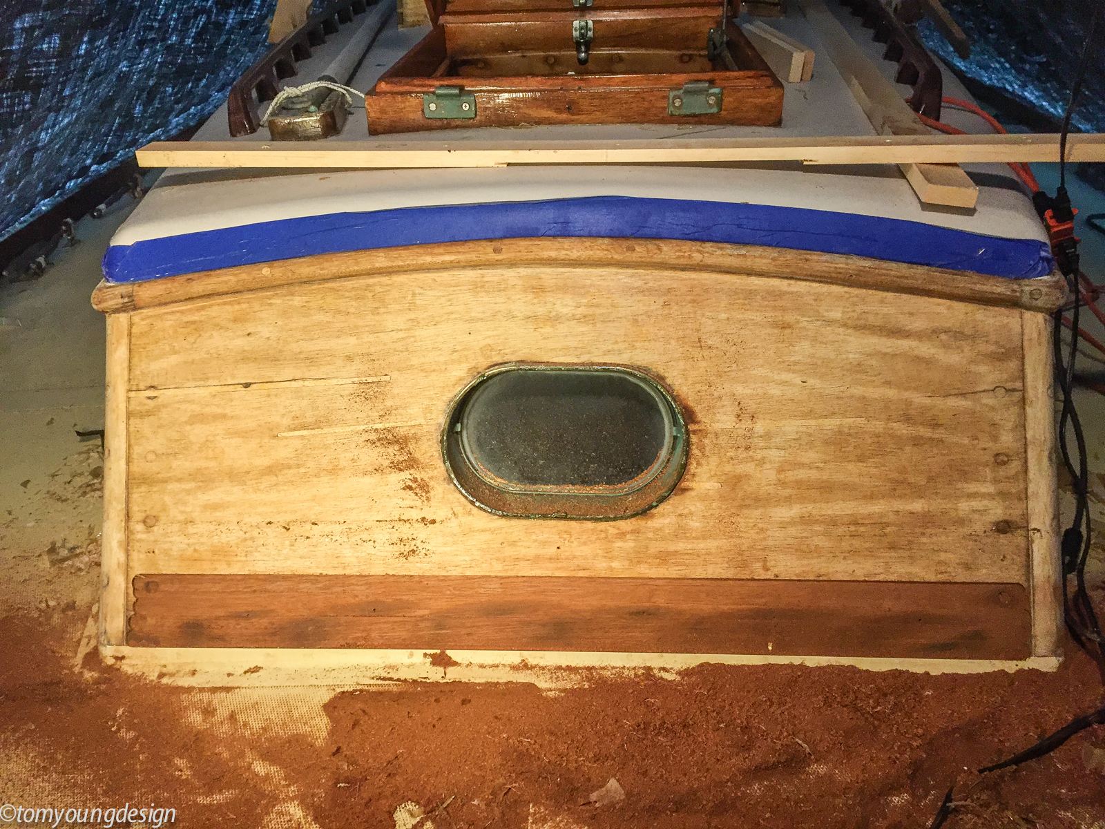

The depth for the gain is 1/4". I believe the screw points, blunt wedges, eventually open tiny cracks to the surface as wood 'moves' seasonally. Years before I uncovered this repairing the house front. You can see the moisture stains tracing the cracks in the grain here. And these screw points were not as close to the surface.

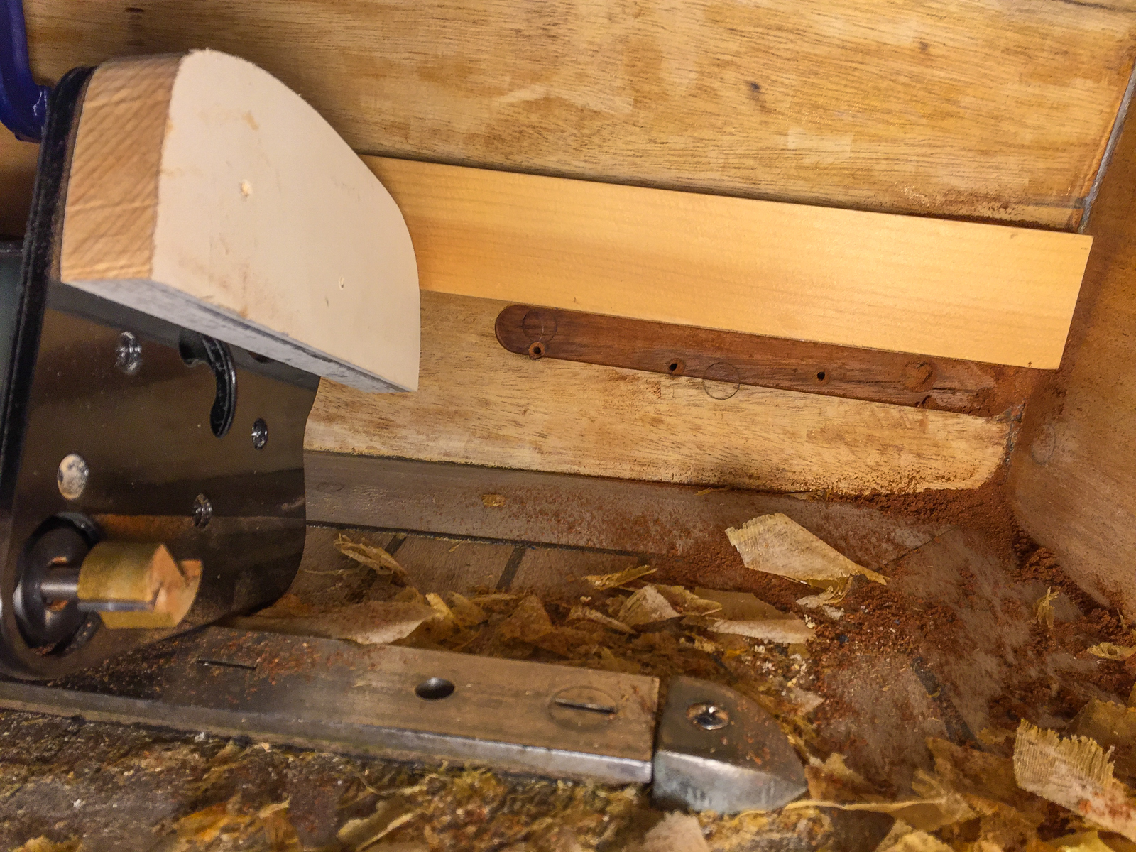

Thanks, Larry! An offset router: A router base that has another mandrel run remotely, via a small cogged belt, from the main router. You can rig a fence of wood through the extra base holes. This is the only use I've ever found for it. :) With a larger diameter bit, you can cut to the edge of the plate.

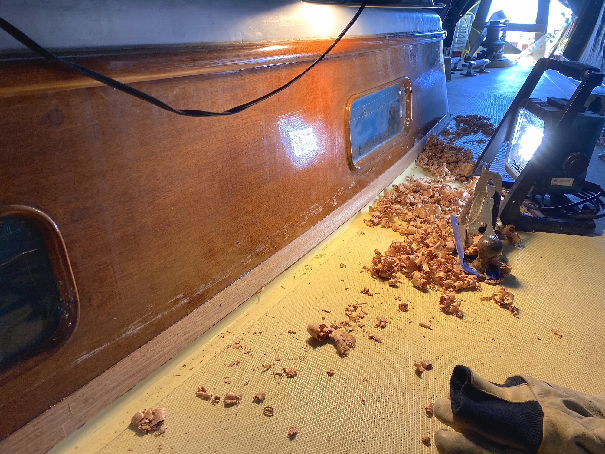

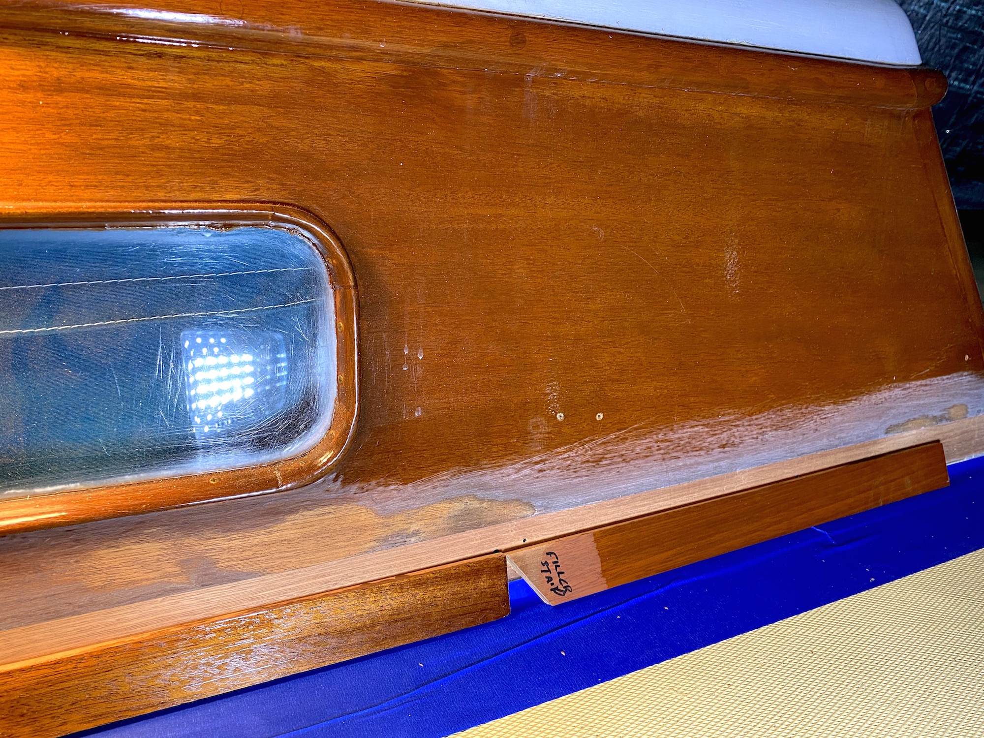

Back at the house: The surgery was a success! Straight epoxy, tinted brown, was brushed into the gain and the patch. Then the epoxy was thickened for any deep dings and putting a thickened layer on for the bond. It all went in place easily, 1 piece at a time. The strong backs were then re-fastened into the same holes, and all tightened down.

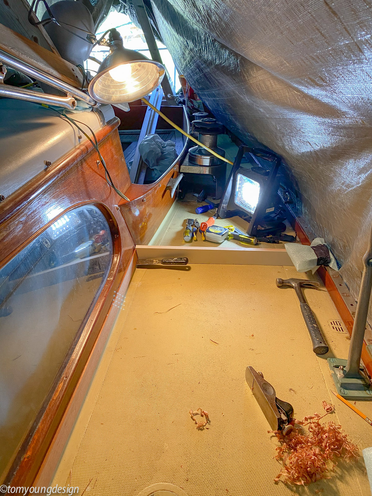

I revisited most every cutting tool I own and settled on this old (rusty) plane. With a super sharp blade and a couple layers of painters tape on the edges of the planes sole I went to work bringing the patch down to the house level. I made several trips to a whetstone and water bottle (for both of us) in the cockpit.
The plane rode on the deck below and on the house above to follow the curve of the house.

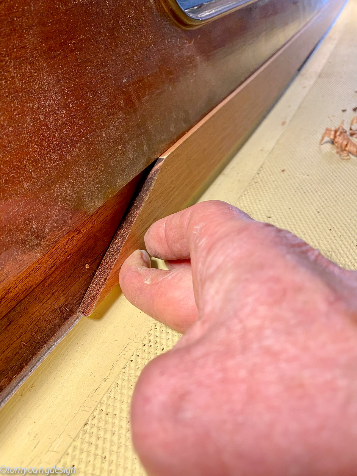

Once down flush, sanding with 80# grit: This was mostly done with a hand block and dust attachment. The paper was cut undersized to just overlap the patch (see the paper on the sanding block). Tight spots I used a detail sander. Once I reached the end I switched to 120# grit for the final pass.
The fit is good. It will be a challenge to get a close match to the existing house finish. It's still in good shape and I should get more years out of it before 'wooding'.

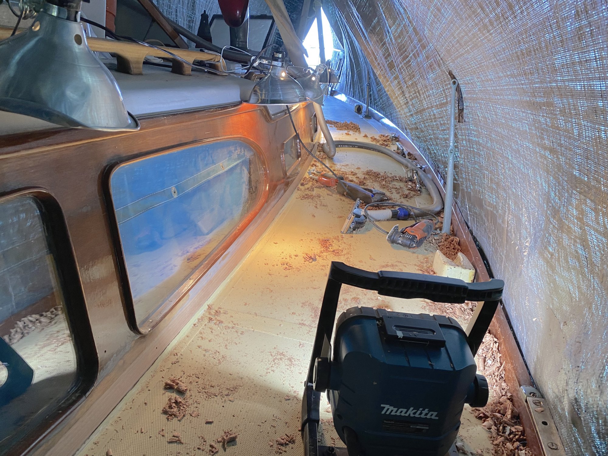

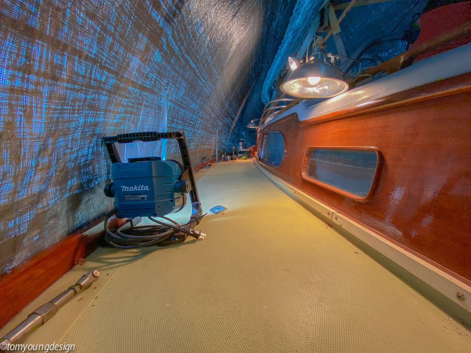

The elbow surgery slowed things down for a while but I'm back at it.
Teach a kid how to paint, you'll get it all back and then some.
We taped off together, then started painting on the foredeck; I painted down the port deck, Mary Jane on starboard. We met on the aft deck. You can't tell who did which.

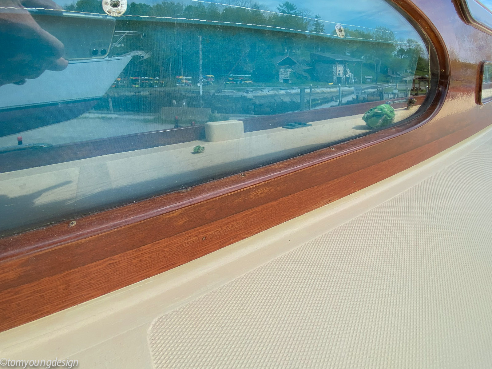

You can see the Dutchmen patch of course. But the next time the house is 'wooded' (varnish removed), I think the mend will blend in nicely.

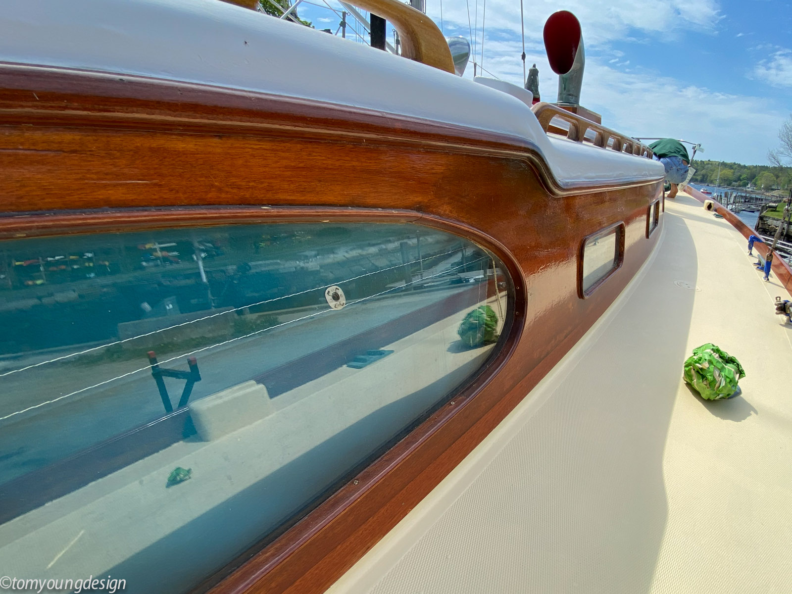

Close up. Good for another 60 years.
Last fall at haul out time. Wood, amazing stuff.
