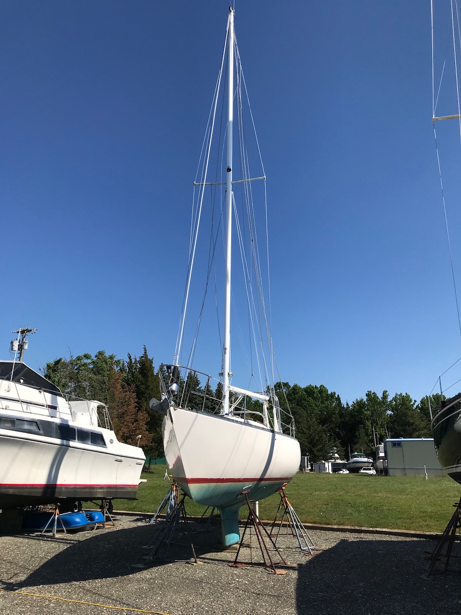

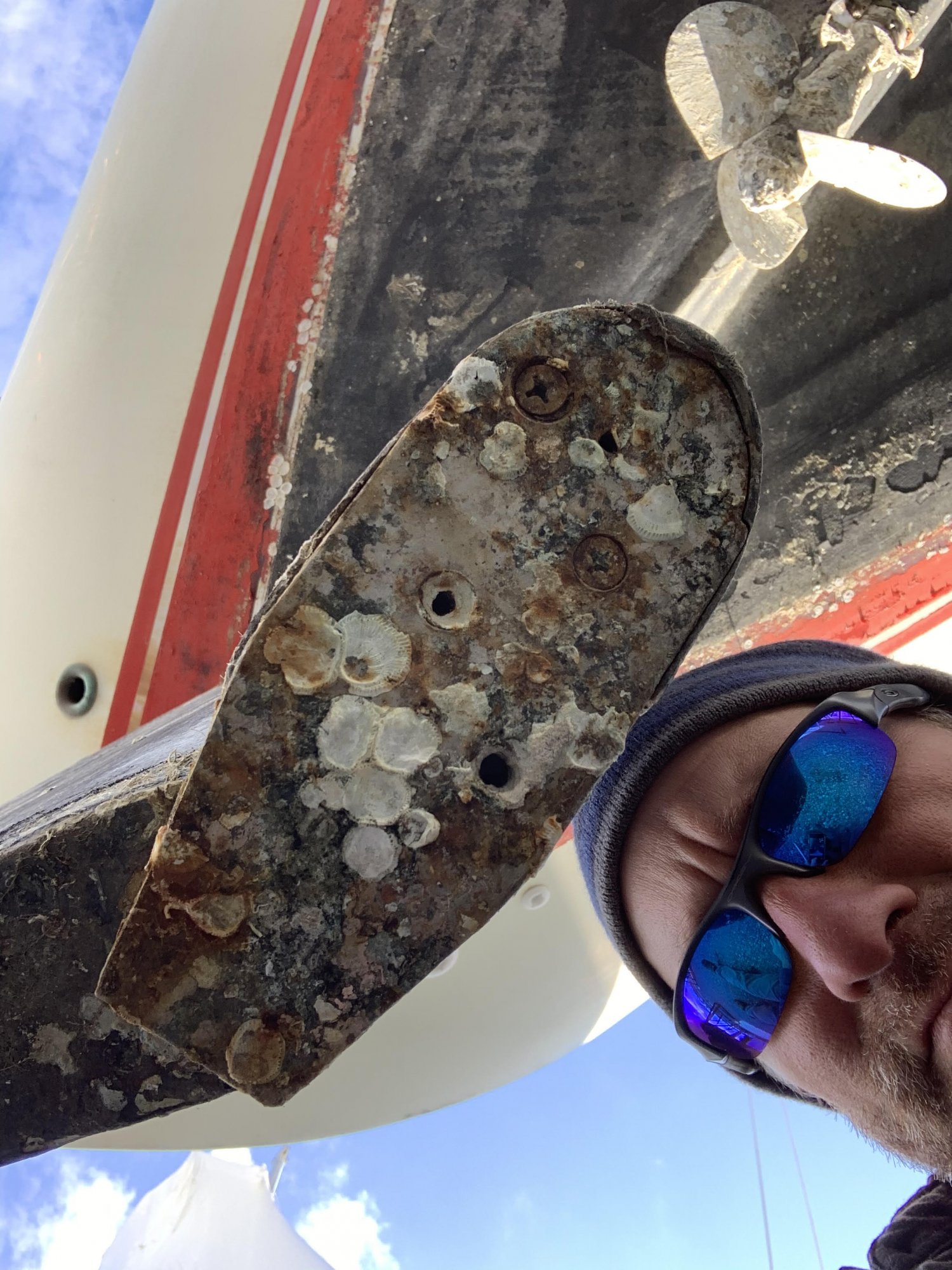

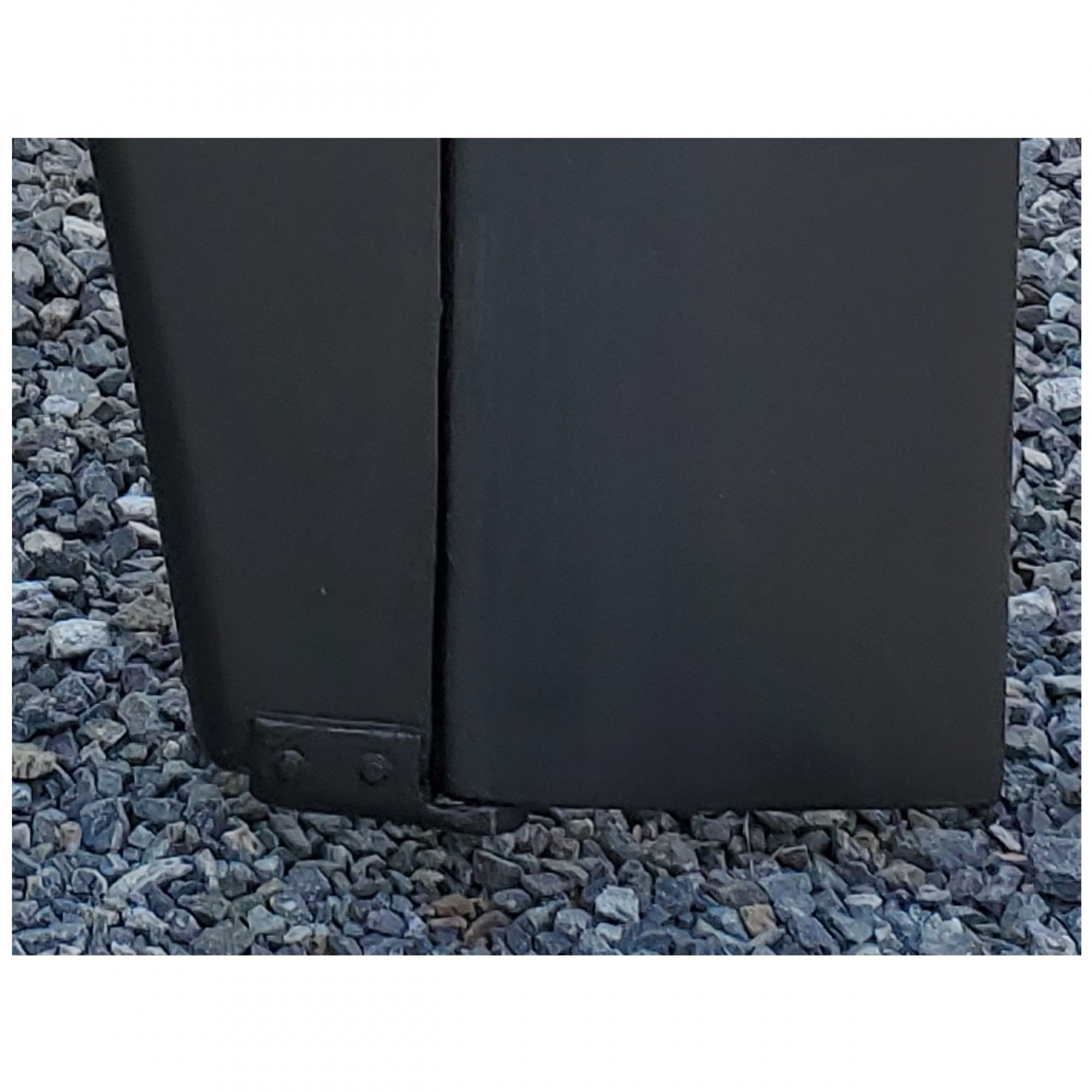

Hey folks. After I pulled my boat this year I noticed that I lost the shoe/plate which secures the lower pintle of the rudder. I have a feeling it was knocked loose during launch. I doubt that anyone has a C Raider 33 since there were only 30 made. But if anyone could steer me in the right direction that would be great. The set up is different than anything I have seen before.

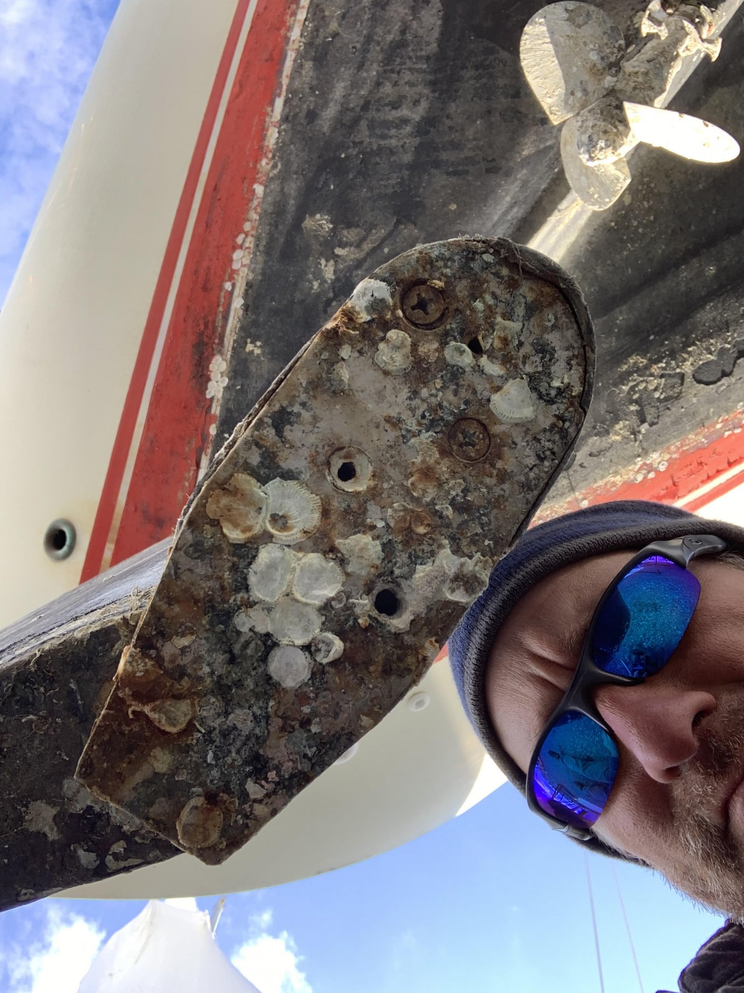

You are 100% correct. The first image is when the shoe was in place. The second is a side view after I lost the piece. I wish I had the forethought to take more pics when the piece was in place.
14,055
You will probably have to make a pattern and have a machinist make on for you. However, if you contact Cherubini they may have the shop drawings or may be able to fabricate on for you.

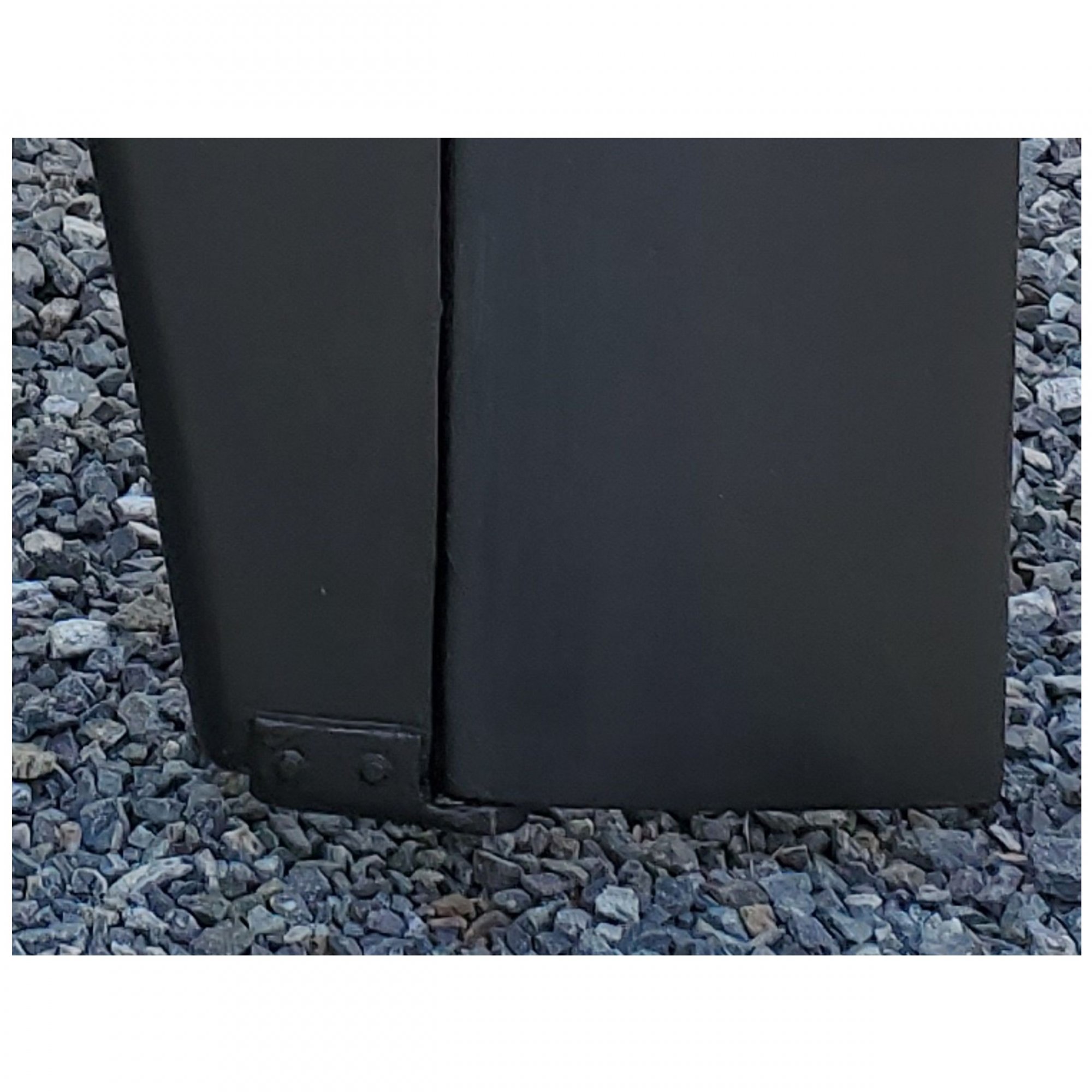

Hi Wulf71,

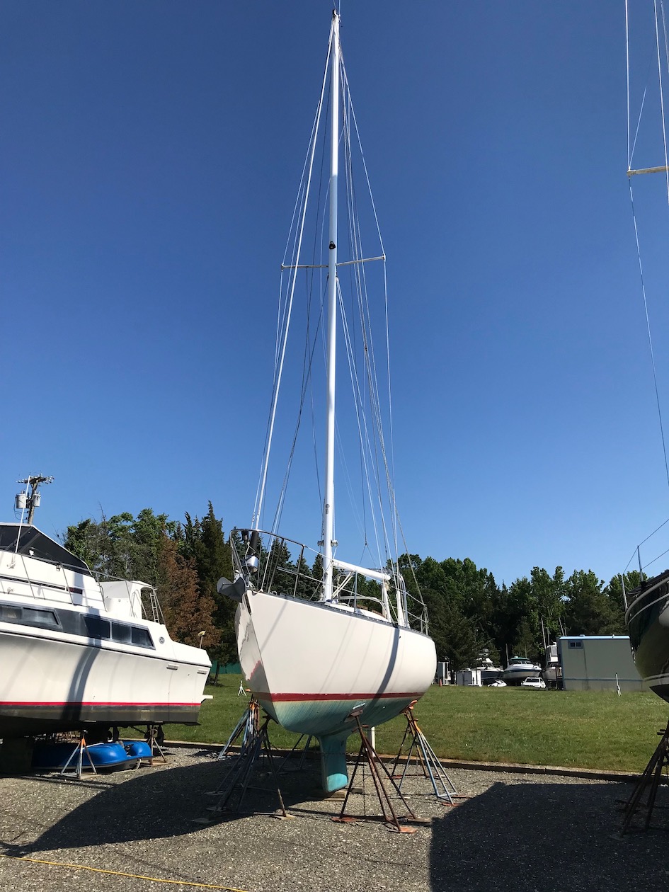

Actually, I have a Raider 33, # 23 of 29, Calamay, sailing out of Middle River Maryland.
I have attached a picture but my shoe is a one piece cast, so I'm not sure it helps you.
If you have any questions, I'm happy to help!
Bob

It certainly looks like the 'shoe' on my H30C from 1979.
Good chance it is. Over the years I've learned that boat builders don't like to reinvent the wheel or the rudder shoe. If it works for one boat model, then use it on another.

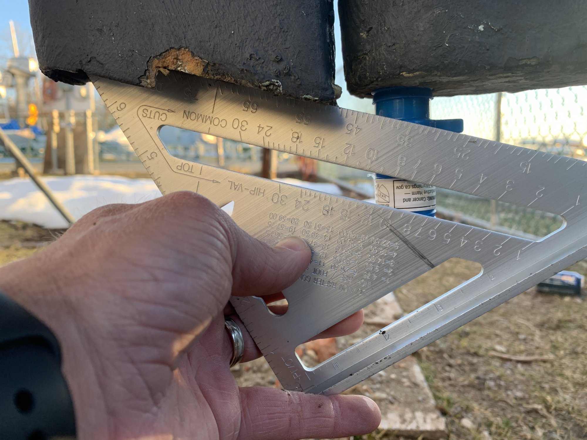

Thank you so much for the picture. That is very different than what I had on mine. There are not many Raiders out there.There were actually 30 of the Raiders made, I bought #30 from the original owner who had it delivered in 1985. I will probably, eventually, have a traditional shoe made with the through bolts. For now I am fabricating the bottom plate and have it screwed up into the skeg. I am going to glass it as well which will make the removal difficult when I want to drop my rudder next year.
I would advise not 'glassing it but attaching it mechanically. When I repaired one of these after Superstorm Sandy I bolted the original skeg back into the hull (with sufficient backing plates) but these became inaccessible bolts - had to cut 3" round hole in skin of skeg to hold them with wrench. When the hole was 'glassed over it made no sense to retain the accessibility and so the whole skeg was 'glassed to the hull.
I would recommend a structure by which the fiberglass skeg is permanently 'glassed to the hull and the metal 'shoe' is stuck to the bottom with 5200. This shoe should have an SS rod, with threads and a nut on bottom, going straight up through the skeg to the inside of the boat where it is retained by another plate and another nut on top. This could as well be a blade too, with more than one nut; but then it would not be removable for inspection and repair (with my way you could drop the rod out the bottom of the skeg if you lift the boat high enough, such as by TravelLift). Make the rod about 5/8" or 3/4". Use only US-made type-304 stainless steel. Paint all the underwater SS surfaces in epoxy paint and be sure to fit a cotter pin (a heavy one) to the bottom of the shaft. This will entail some drag; which can be compensated-for by a little thin 'glass cover tacked over the end with sheet-metal screws.
I would not worry about keeping water out of the skeg - though SS immersed in seawater is never good - but would provide a drain hole in the bottom of the fiberglass skeg so it can be drained. If you were really cool you'd provide a drain plug at the top end too and flush it with fresh water from the garden hose every haul-out. Still, the SS will need constant vigilance and should be removed and inspected maybe every 6-8 years - hence my insisting on the nuts for the rod, rather than threading it into the SS plates - or, worse, welding it all as one.
Now; if you could have the whole thing made in marine bronze.... ;)

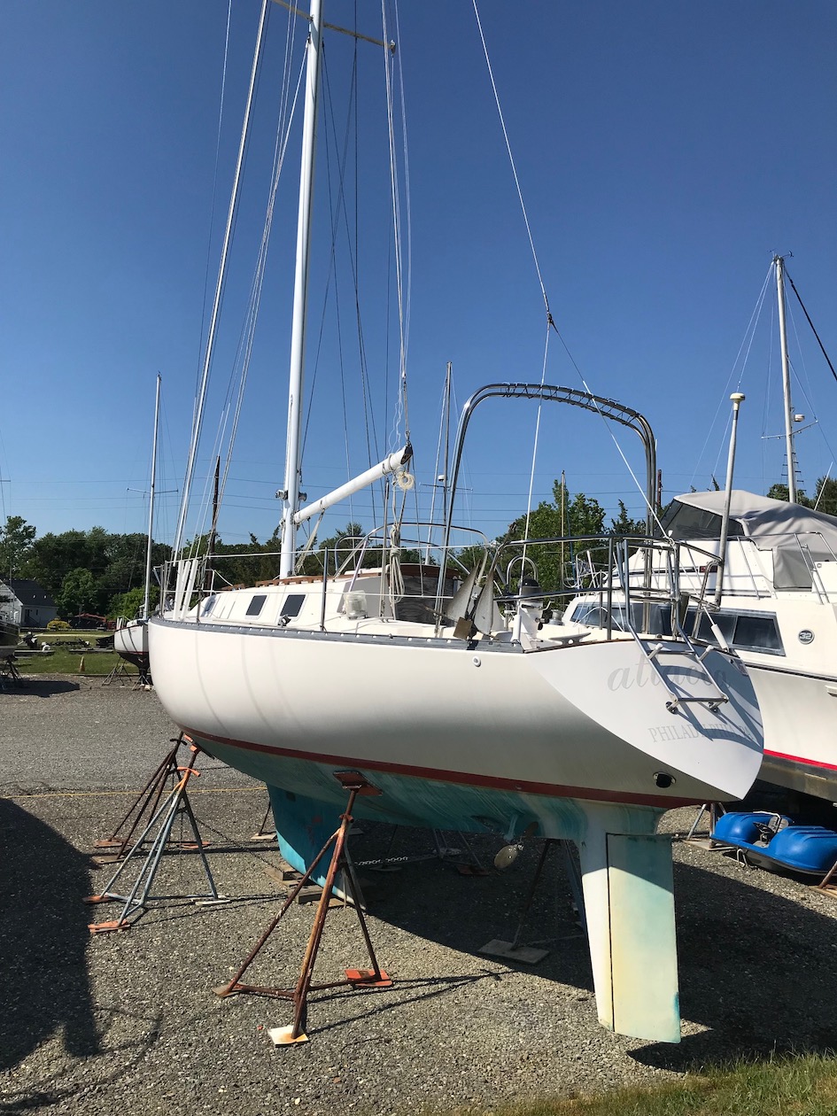

There is no forum here for Raider 33s but I would contend that Raider-related posts could be posted in 'Cherubini Hunters' as the boats are, in many ways, interrelated. The Raider is NOT a Hunter boat, and was NOT taken from the H33 or any others; but many of the structures were, for cost reasons, sourced straight from H30 and H33 production models.
Pics are from 7 June of a R33 at New Gretna NJ. Note (if you can see it in these pics) the deep molded bilge which permits use of H33's shoal-draft cast keel - which actually works very well as the boat is then nearly 5 ft deep and all of the weight is way down low. More stable than H33 as well as being lighter overall. Given a true deep keel (as my dad's boat had - 6 ft), the boat becomes a storm-reliable rocket ship, definitely pointing as sharply as the molded bow, which Ferenec Mate called 'like a razorblade', would suggest.
