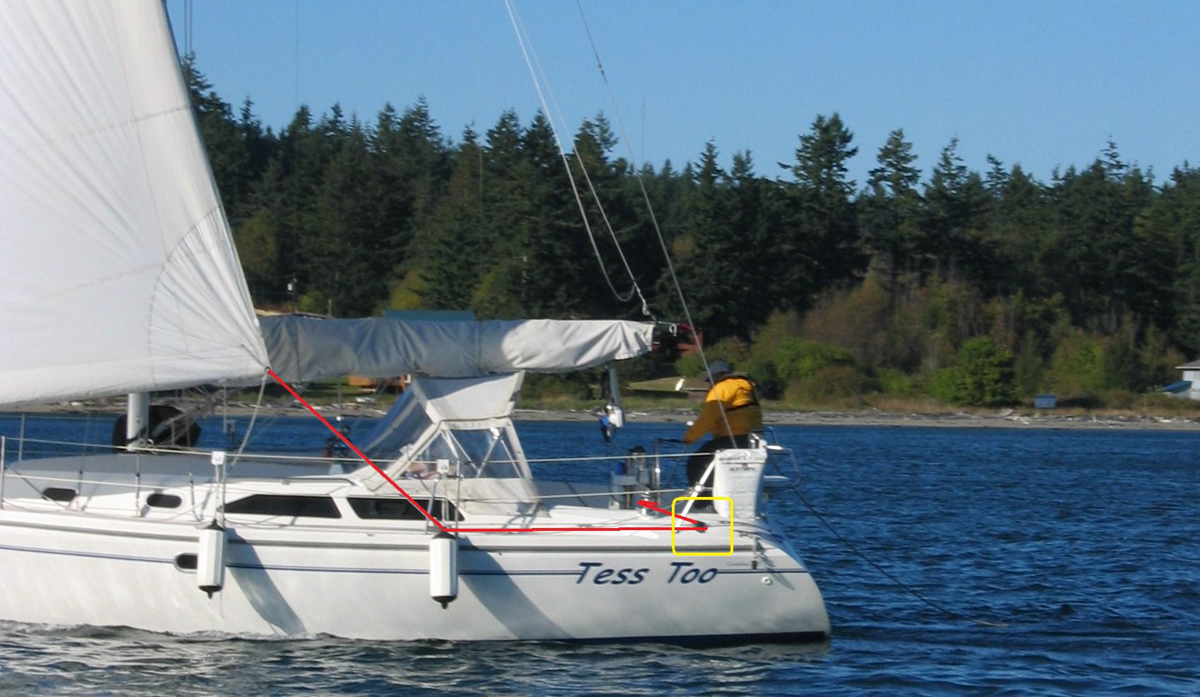

Added a cheek block to tame those forsail and asym sheets.
It's a lot easier now.:dance:
Block added in yellow box.

Details??
Paul
What model cheek block did you use?
Any detail pics?
What did you use for backing plates?
Catalina dropped the ball in this area. Their solution for the port jib sheet was an extra fairlead at the back of the track.... sucks as a solution
I would appreciate ay help you can provide on this
Thanks
Peter

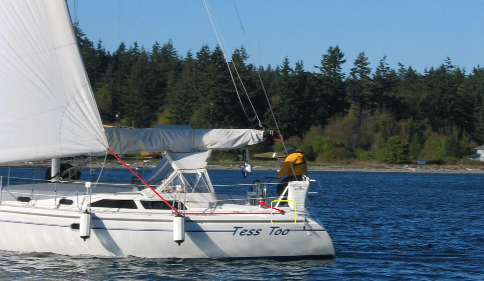

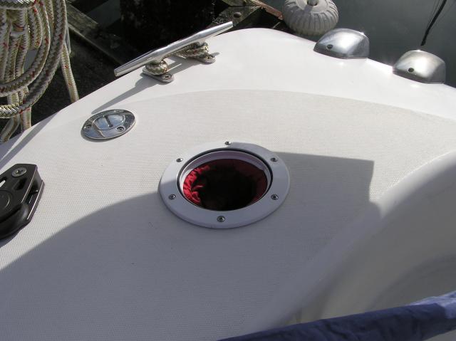

Why the inspection port on the stbd side?
dave
Dec 25, 2008
1,580
catalina 310 Elk River
I was wondering the same thing. At first I thought you were kidding But no, this is for real. Great idea, but not so secret anymore, don't worry I won't tell. I'm trying to think how you would otherwise access this area, guess pull the hot water heater.

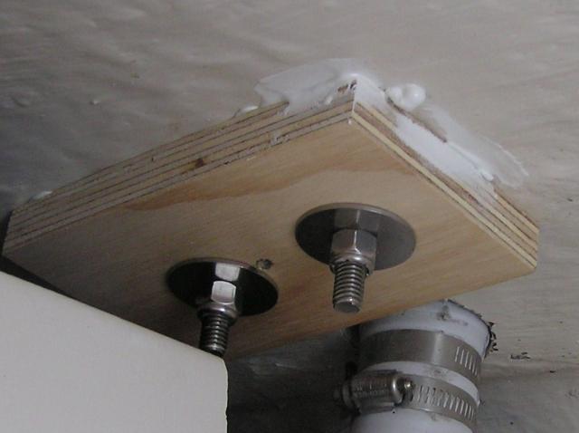

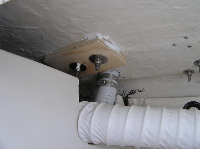

Paul,
Did you use any washers or spacers underneath the blocks? Does not look like it but a little hard to tell from the pic.
paulj
Mar 16, 2007
1,361
Catalina 310 Anacortes,Wa
I used RTV under cheek blocks for bedding only on the upper deck.
Marine plywood 3/4" for backing blocks and 3M 5200 for attaching.
Stainless steel nylock nuts, bolts and washers.
That is what I used........ and as always everyone should use the method and materials you feel most comfortable with.
paulj :troll:

Paul, how are these working out? Seems like the sheets are rubbing on the deck, and the leed to the winch is at a low angle. Could the blocks be raised?
paulj
Mar 16, 2007
1,361
Witzend
Paul, how are these working out? Top drawer.
Seems like the sheets are rubbing on the deck. Yes they are.
the leed to the winch is at a low angle. No problem.
Could the blocks be raised? Yes.
