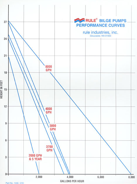

Your're wrong.Check valves have absolutely no negative affect on the bilge pump. Pumping water is based on head which is the total vertical rise you are pumping the water. The head is the same weather you have a check valve or not.
Without the check valve you would have the pump turn on based on the float switch and pump water until the float went down, shutting off the pump. The water in the house, in the case of a Catalina 310 about 1 gallon, will then call back into the bilge, probably causing the pump to cycle back on.
Don't remove the check valve. Use Brass instead of plastic. And use a "flapper" style instead of a spring style. The flapper style has a clean out opening that can be removed so you can clean the flapper and the shelf it sits on.

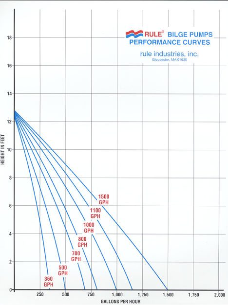

Head is head for pumps. If it can pump the water out without a check valve then it can with. The pressure required to open the check valve is the same as the pressure required to push the water column without it.Your're wrong.
Can't tell you the number of boats I've been on where the check valve on a bilge pump caused it to fail.
It does so for 2 reasons:
The force on the check valve is greater than what the pump can generate to open the flapper when the entire pipe is filled with water.
This is mostly owing to boat builders fitting marginal bilge pumps.
As well, if you have a check valve, and you get an air lock between the pump and input to the check, the pump will not build up enough output pressure to break the check valve open.
This happens a lot with boat airco pumps as well, when they put a check in the output.
I'm sure you know a lot about pumps. But I've seen many instances where a check is mounted outside a pump where it will block the output.

JK none of this applies well to the crappy centrifugal pumps we use for bilge pumps. If you want to put one on a considerably more expensive diaphraghm pump, go ahead, but I would never advise a check valve on a Rule style pump, even to my worst enemy.Check valves have absolutely no negative affect on the bilge pump. Pumping water is based on head which is the total vertical rise you are pumping the water. The head is the same weather you have a check valve or not.

Just different applications. In theory the data you present is fine, and quite accurate, when the variables are met. In the real world it does not account for bilge chemicals, oil, etc. softening the seals, or the corrugated hose or low voltages, or elbows, reducers etc....They work in big industrial pumps, used to be a rep for Zoeller, but on boats they can be a true danger.Well, clearly I stand corrected.
This just shows that experience trumps all. And my experience with construction/industrial equipment is not as good as experience with marine applications.
Very disappointed to learn that Rule puts out false pump curves. Also I am disappointed that Catalina would put a check valve in with the information you have cited.
I am now making plans to rip out my Rule and replace it with something better. Any suggestions?

My original position, which was clearly backed up is that "stay away from check valves on bilge pumps"to the main question No
JK, I always assumed that Catalina put the check valve in the bilge pump circuit because it shares the outlet with the manual diaphragm pump. Without the check valve, the manual pump would be pumping water back into the bilge through the Rule pump. Does this make sense?Well, clearly I stand corrected.
