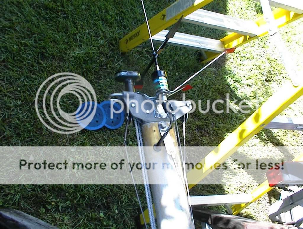

Where is the antenea usually mounted? My mast?
Seems like there is a LOT stuck to the top of it...... the anchor light, wind direction indicator, antenea........ There is only sooo much room up there........................

My mast?
Yep. At the very top.
I have the same problem, so I got a windex (wind direction indicator) that actually slides onto the antenna. Perfect.
