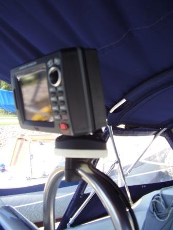

I went with the Standard Horizon unit. Also in a home made mount, which I am looking for the photos of. I like the unit because it has a slightly larger screen and, with the addition of a dome I have Radar in my Chart Plotter.

I just received my Standard Horizon CPF190i yesterday. Good prices on these units now. I plan on moving the compass on my H30 and mounting it in it's place. The compass will be relocated.

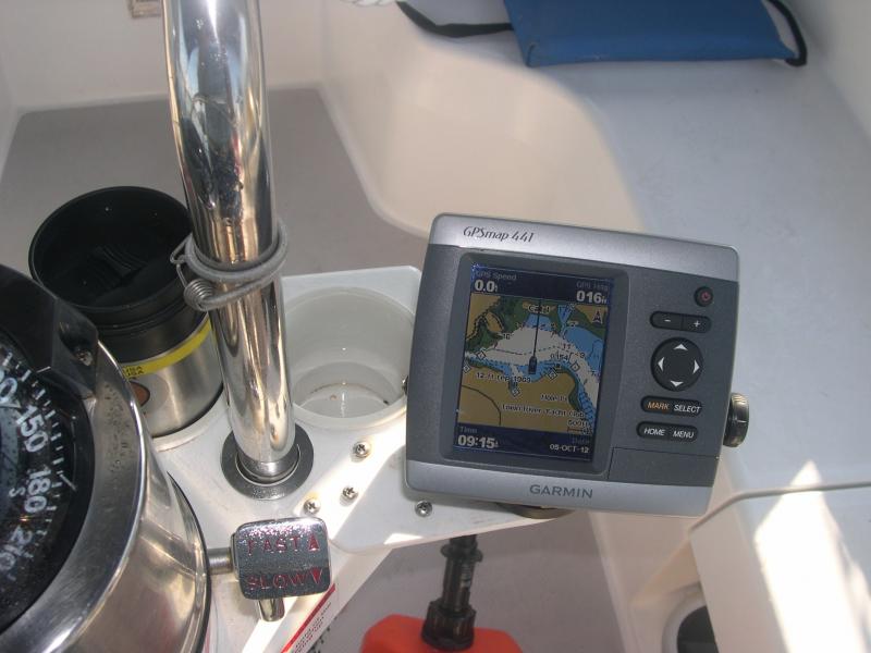

try Garmin 421 (especially if on sale). You can get one for about $300. And it can accommodate depth (if it is 421s). And if you go for 431 or 441, you will get the maps of US waters included (inland/coastal respectively).

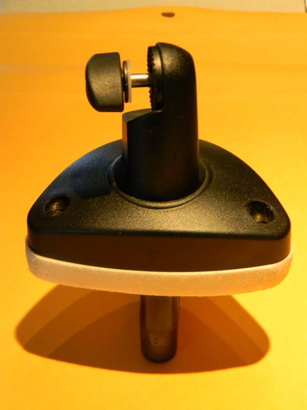

Found them. This was the original mount I made, that allowed me to rotate the plotter around if you were sitting under the dodger to see it.
Since then I have moved it down between the two support pipes on the guard, just above the compas... (no photo of that yet.)

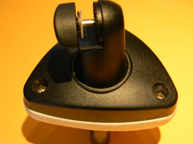

I like your mount. I have the same chartplotter. Was the clamp a purchased part or did you make that too?. If you made it, is it out of wood...plastic...aluminum?
Aug 24, 2009
444
Catalina 310 Sturgeon Bay, WI
The mount (black part) is a standard $6.00 split rail mount. I made the white plate from some scrap Starboard. That way I could sink nuts into the 1/2" board and have blind fasteners on both the supplied swivel mount and the clamp. It I can find the project photos (changed computers this last fall) I will post. Total mount was under $10.00

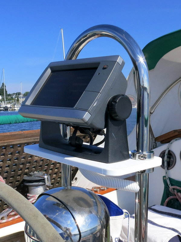

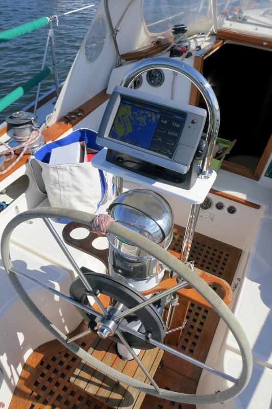

Here's some instructions for a nice mount: Edson 4, 5, 6 & 7" Plotter Mount ;)
