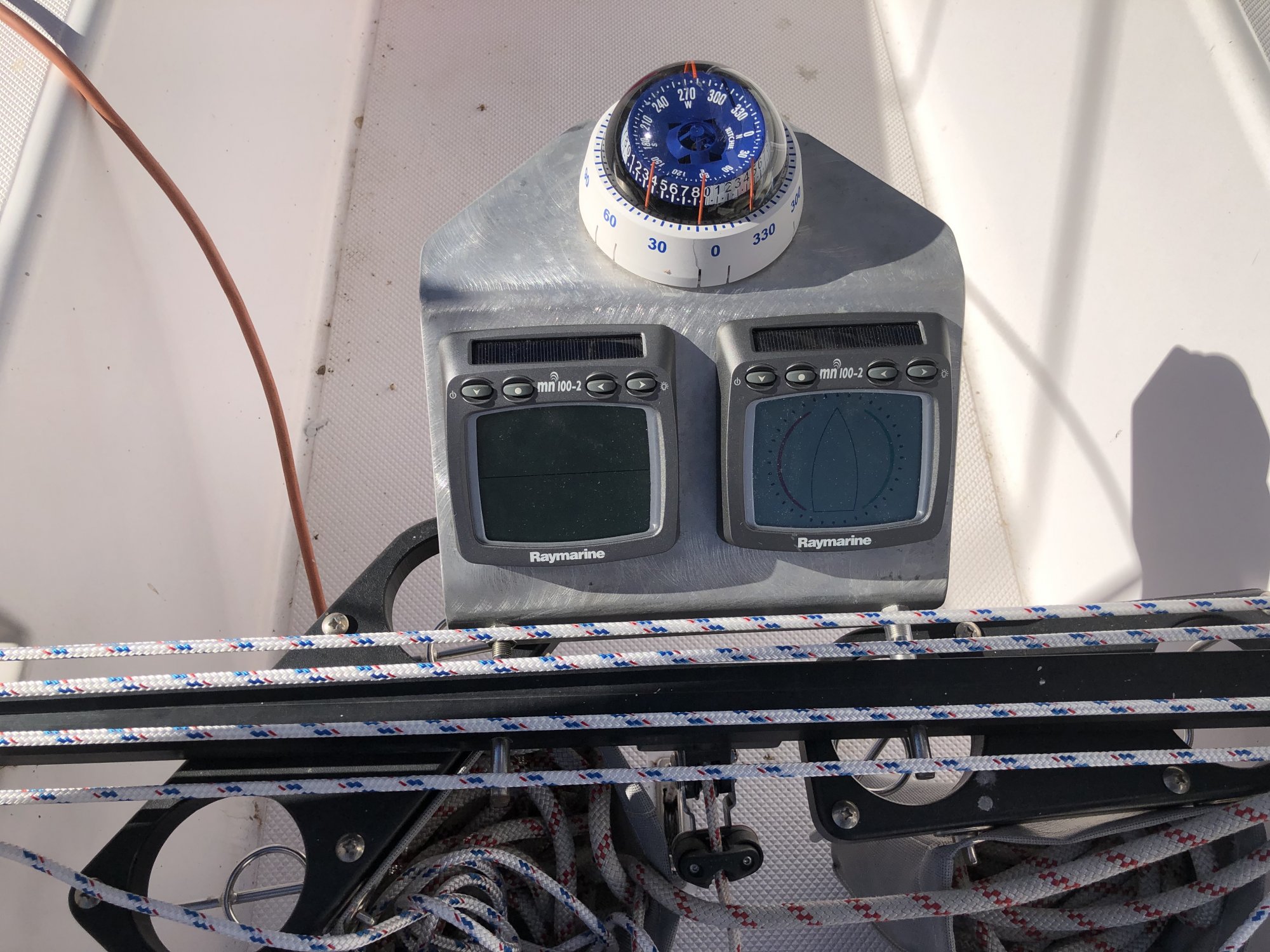

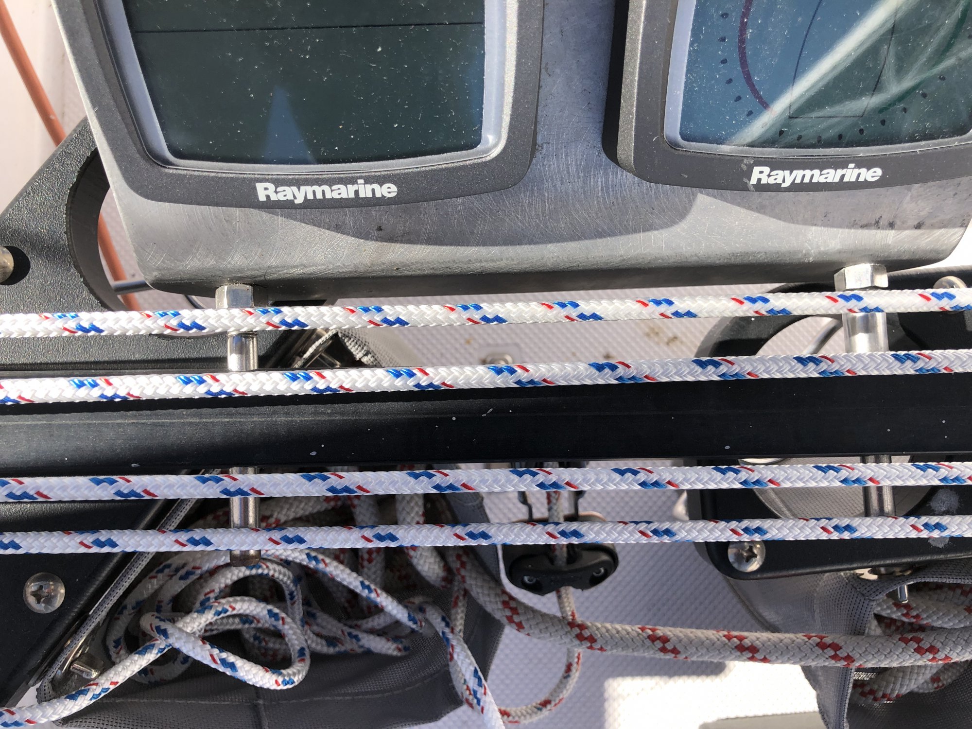

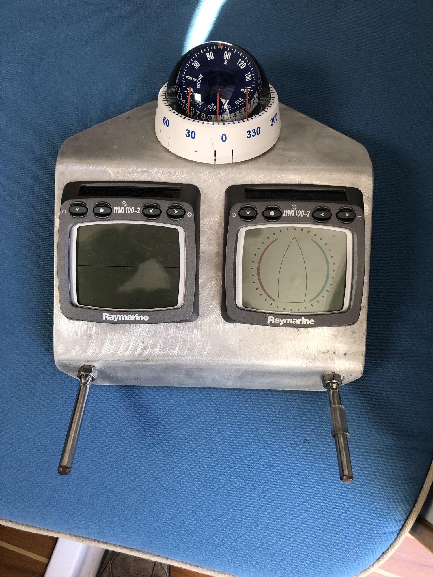

The first owner of my boat built a mount for the traveler. I am going to the boat today to winterize. I will get some pictures and post them this evening.

This is very helpful. Thank you. Two questions: I'm assuming this is angled sufficiently such that the main sheet doesn't interfere with the mount? Also, how is cabling handled? I wonder if it can be run on the underside of the traveler to keep it out out of sight?
Yes, it is angled enough to not interfere with the main sheet. My instruments are wireless and battery/solar powered so there is no cabling. If I added a chart plotter to it I would probably use some bulk head connections under the traveler.
I think if I was doing it myself I would look at some of the Ram Mount options. You could probably configure one of their mounts to position the screen in front of the traveler without having to drill the traveler or bend up an aluminum bracket.

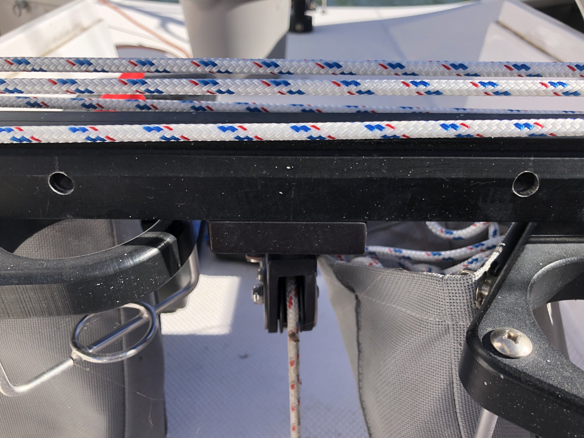

MIne is on a swing mount in the companion way. Yes its can be obstructed but I would worry about killing my self or other crew members if it was protruding from the traveler... Besides given the size of those holes any concern about weakening the traveler by taking so much metal away for the mounting bolts

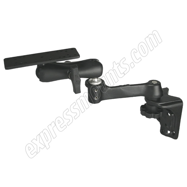

How about something like this mounted just in front of and below the traveler? It would be easy to remove the chart plotter and swing out of the way when you didn't need it. I wouldn't want one mounted in the companionway where you can't get to it from the helm position.

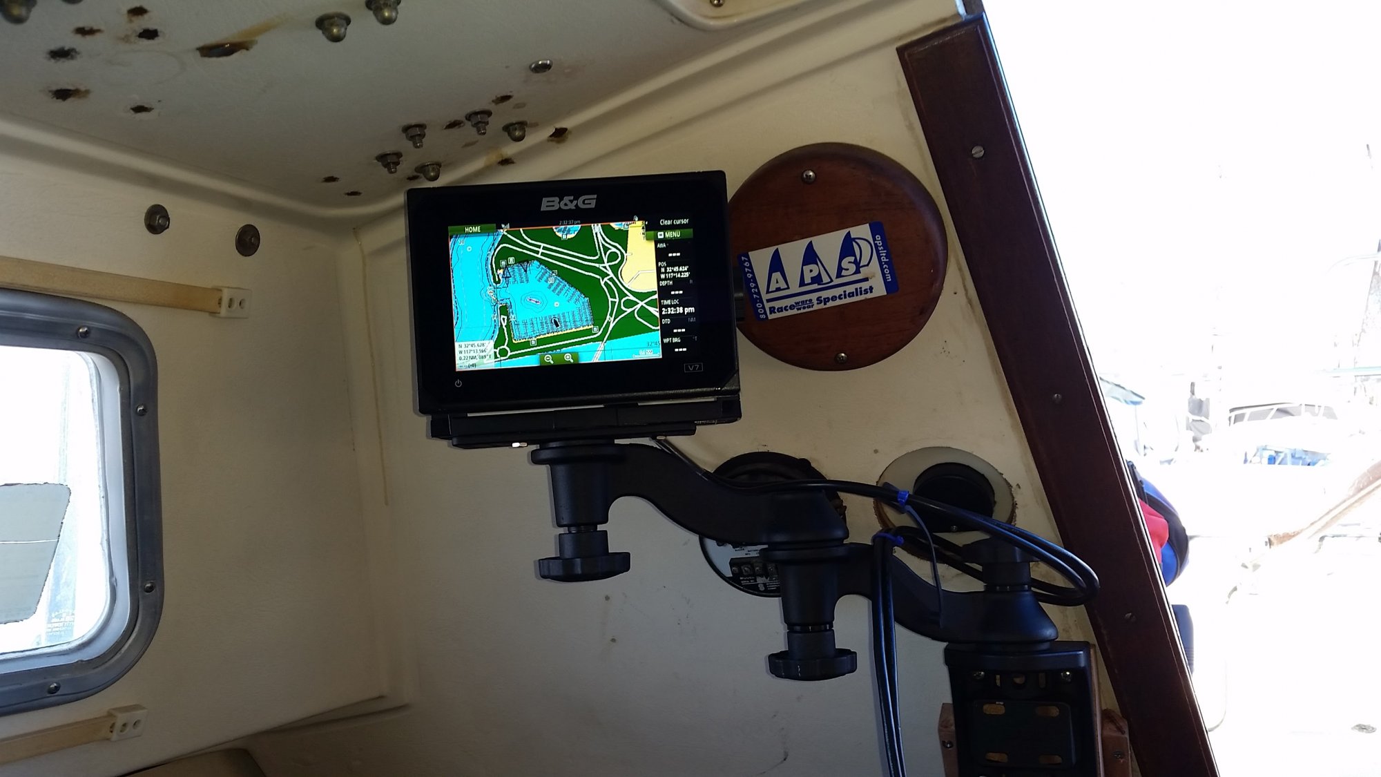

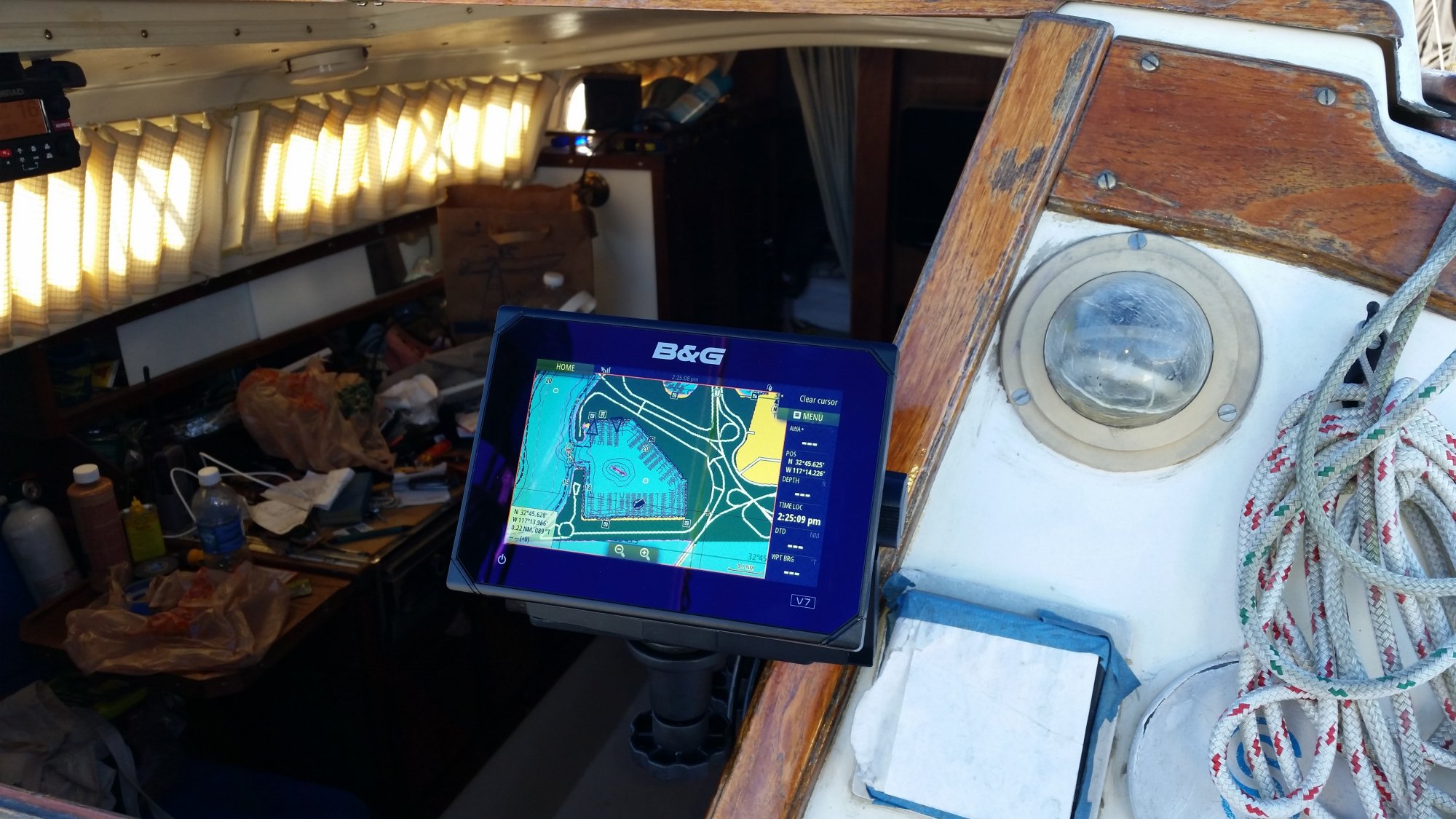

On my boat you reach the unit from the tiller, but on your boat, the long cockpit and relatively small cabin, may place it out of reach. Simple enough to determine by sitting at the tiller and seeing if you make the reach to 5 or 6 inches from the bulkhead. The double swing arm allows for a number of useful positioning options.
Found these old pics to give you an idea... but I have a regular C27 and the cockpit is much smaller than your 270 sport. Only way to tell though is to get to the boat for some test fitting. Good luck.

Mine is mounted on the swing arm. If you sit behind the Traveler reading the stats on the Face of it depend on your eyesight. I can read the numbers if I have my glasses on and other crew, much younger with better eyes, can read it with no problem.

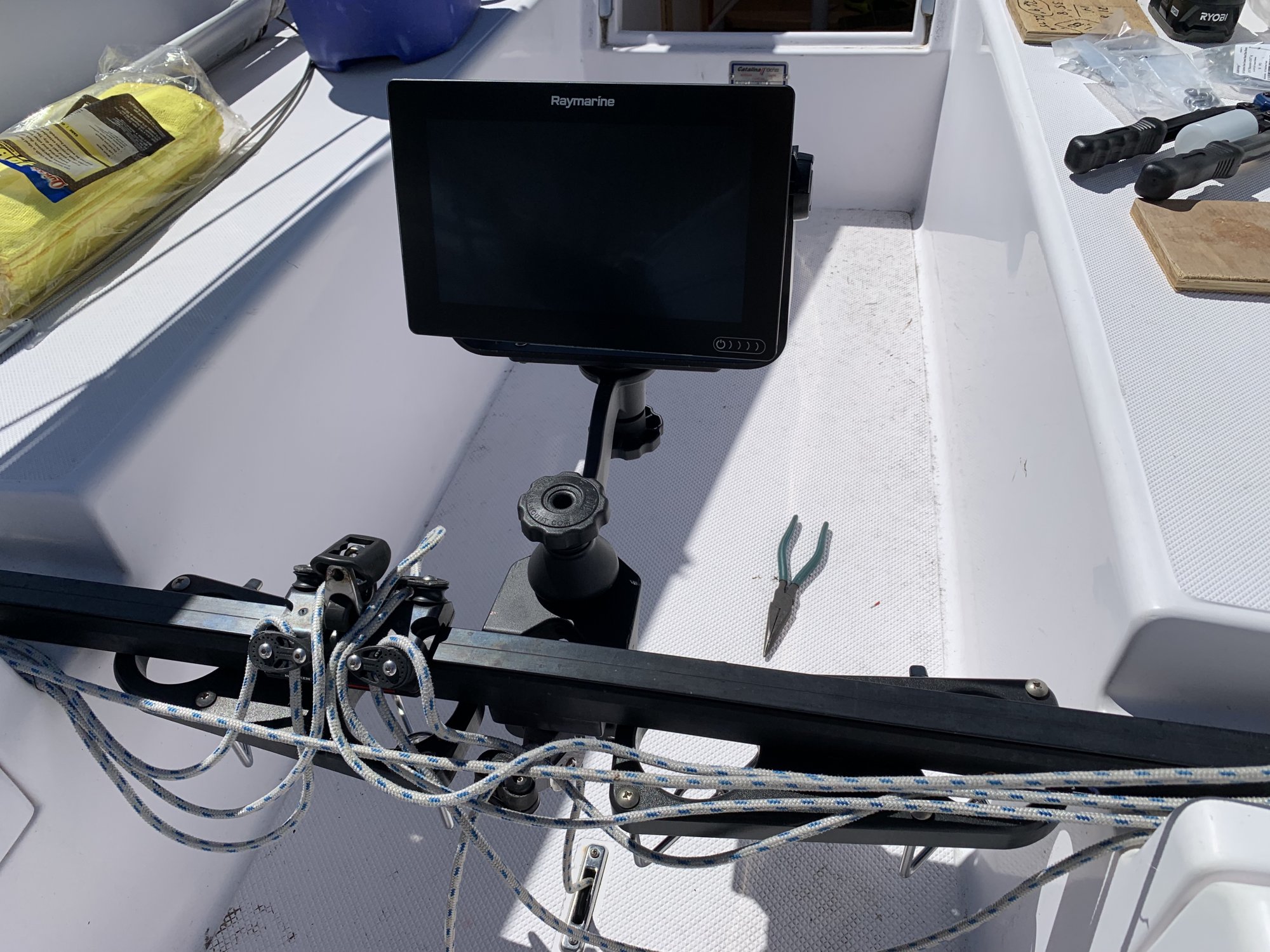

I'm adding a chart plotter to my wish list. Curious to know if anyone has installed one and where it is located. I've seen one mounted to the right of the companionway opening but that seems too far away and will get blocked by guests. I recall seeing that someone had created a mount so it could be located on the traveler. Has anyone done something like this? Any other ideas?
Just a follow up on this post. I ended up mounting my new Axiom 9 chart plotter to the traveler (see picture). I used Weld Mount 8040 adhesive to mount two weld mount #10 studs to the front vertical face of the traveler (thereby avoiding drilling any holes in the traveler). The Weld Mount stuff is amazing and has great holding power. I bought a Ram Mount swing arm which I've attached to the Weld Mount studs so I can change the position of the chart plotter as needed. I'm going in the water in 3 weeks but I think this is going to work out great. The mount in no way interferes with the function of the traveler or the rotation of the cup holders. Ran the cables through this Blue Sea System CableClam on the starboard side of the traveler.
