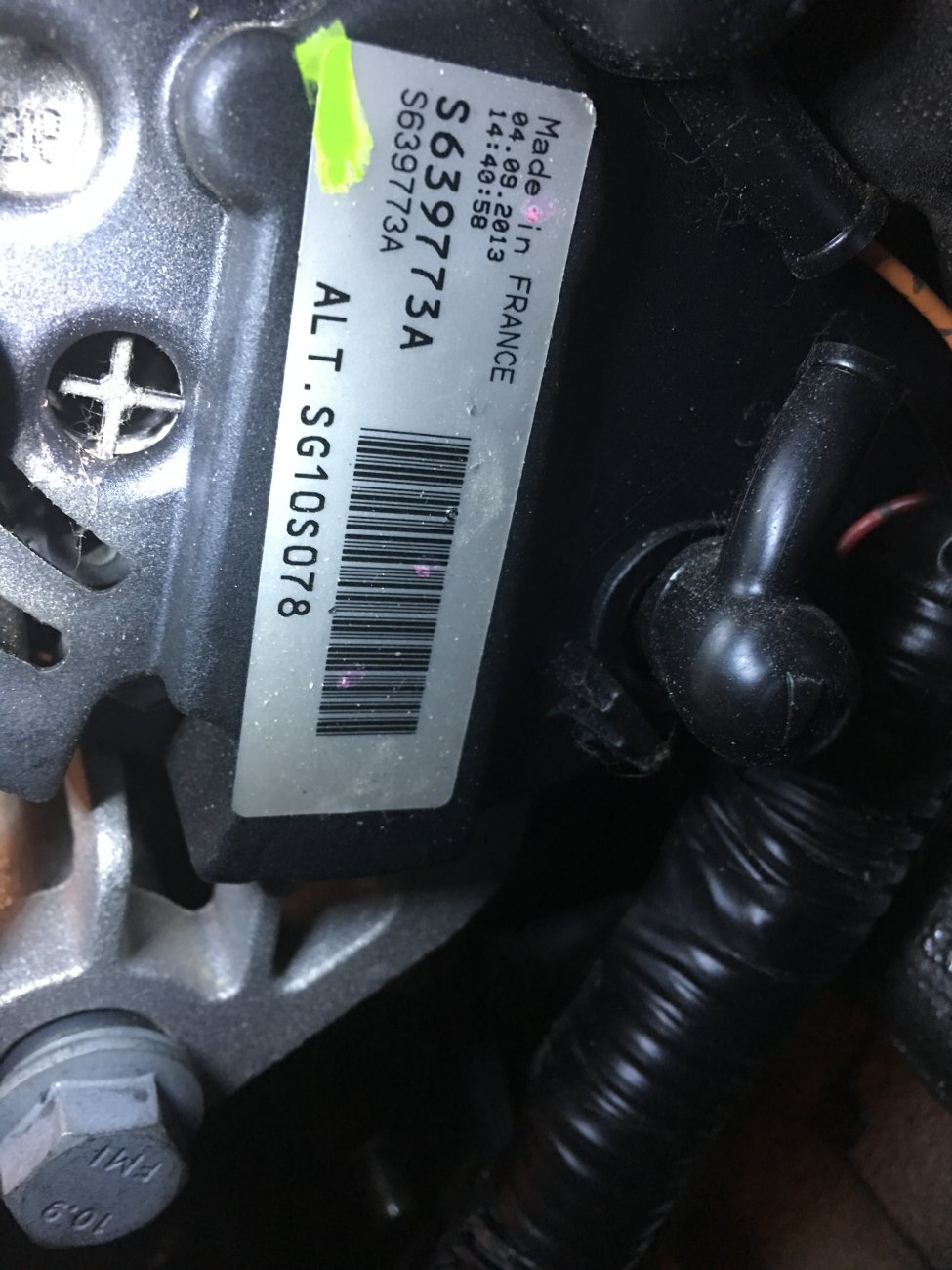

I was able to check my notes from commissioning and they indicate that I actually have a 120Amp Alternator but I can't find any references to my regulator. Everything was 2016 factory stock (circa August/September 2015) and while I can certainly contact Catalina via my dealer I figured I'd check here first. Can anyone confirm what the specs are for this alternator and what the stock regulator specs are for a 2016 Catalina 385?

This is a Veleo 120 Amp internally regulated alternator. Search the internet with the model number (S639773A).
https://www.autopartswarehouse.com/...ies-and-components/alternator/valeo/vle439398
The search also shows up a lot of Yanmar references and since the alternator is Yanmar gray....

Your regulator is internal and a typical automotive type. The good news is there is a kit for that alternator, to covert it to external regulation. It is a pretty easy job to do and gets you into external regulation for much less money than a performance alternator and external regulator... All you need is the conversion kit and a Balmar MC-614H or ARS-5H...
Yanmar / Valeo External Regualtion Conversion Kit
