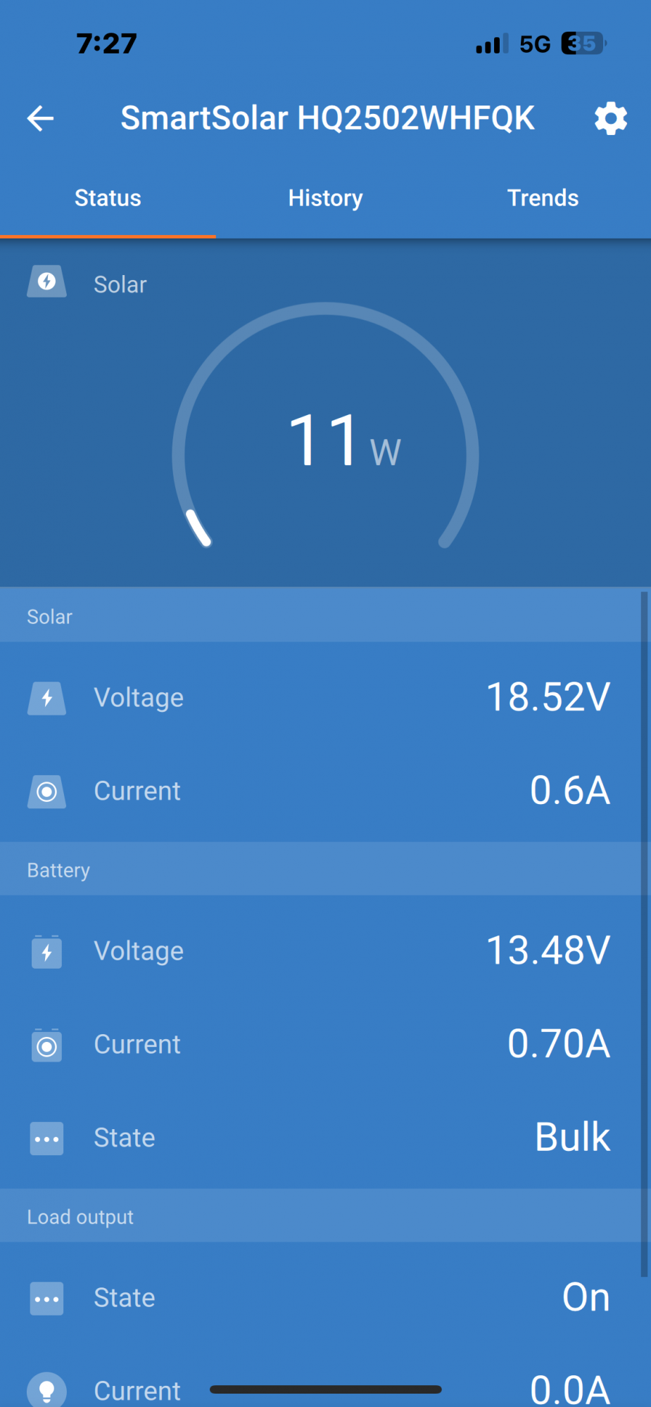

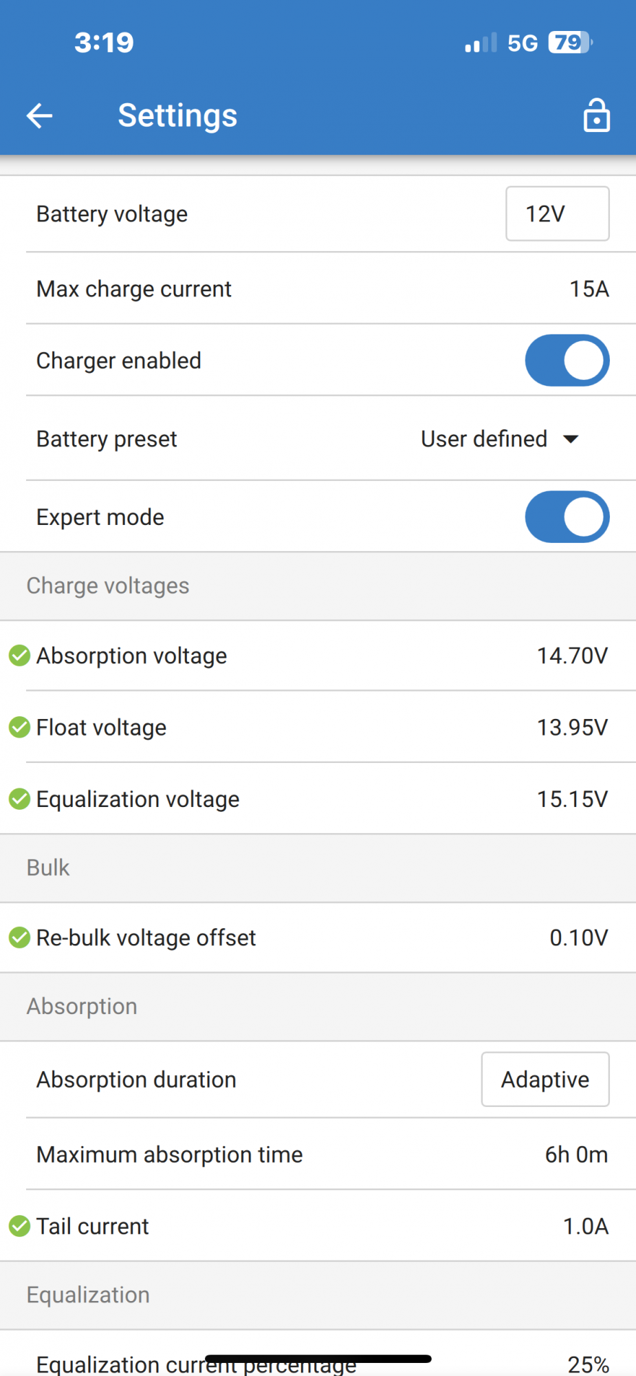

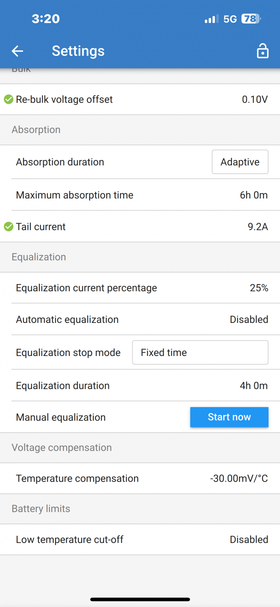

I have a 2S2P setup of 6v 230Ah East Penn batteries for total 460Ah of 12v. I have attached 2x50w panels (I will be adding 2 more) via a Victron SmartSolar MPPT 75/15 controller. I’m confused regarding what my tail current setting should be, (and any other settings to account for). Victron documentation states 4% of bank Ah, but that would be 18.4A, and I have yet to see the charge current surpass 7A when in full mid day sun. What am I missing?
Also, should I be accounting for my alternator and/or shore power charger output when setting charge voltages on the controller?
Attached are screenshots of my controller settings.

4% is the typical tail current setting for the battery monitor to synchronize to 100% (in Lead Acid batteries). The charger tail current (if you use it) would be different. It would depend on your battery. Lifeline defines a fully charged AGM battery as one at absorption voltage with 0.5% tail current. But if you have loads (and no networked monitor) you may never reach 0.5%. In this case, the absorption time setting would trigger the transition to float.

So how do I configure my settings to ensure I don’t overcharge or otherwise damage my batteries as well as get optimal charge from the panels?
We’ve been connected to 30A shore power for 24 hours now, the batteries are well charged, but my Victron controller still shows charging in the bulk phase.

The screen shot shows your panel producing very little power, only .6a @ 18.52v. This voltage is too high for your batteries, so the controller brings it down .7a @ 13.48v, that is all the power available to put into the battery. The definition of Bulk or Constant Current stage is the charge source is putting all of the available power into the battery until the voltage rises to the Absorption voltage (14.7v). That is what the controller is doing, so it is in the Bulk/Constant Current stage and will remain there regardless of the actual amperage being produced so long as the voltage stays below the Absorption voltage. It is acting entirely as it should in this low light situation.
Your MPPT IS A 75/15. Max output would be 15 amps.
Two 50watt solar panels
Max amps = 100 watts ÷ 12 volts ≈ 8.3 amps (under ideal conditions like full sun at solar noon)
