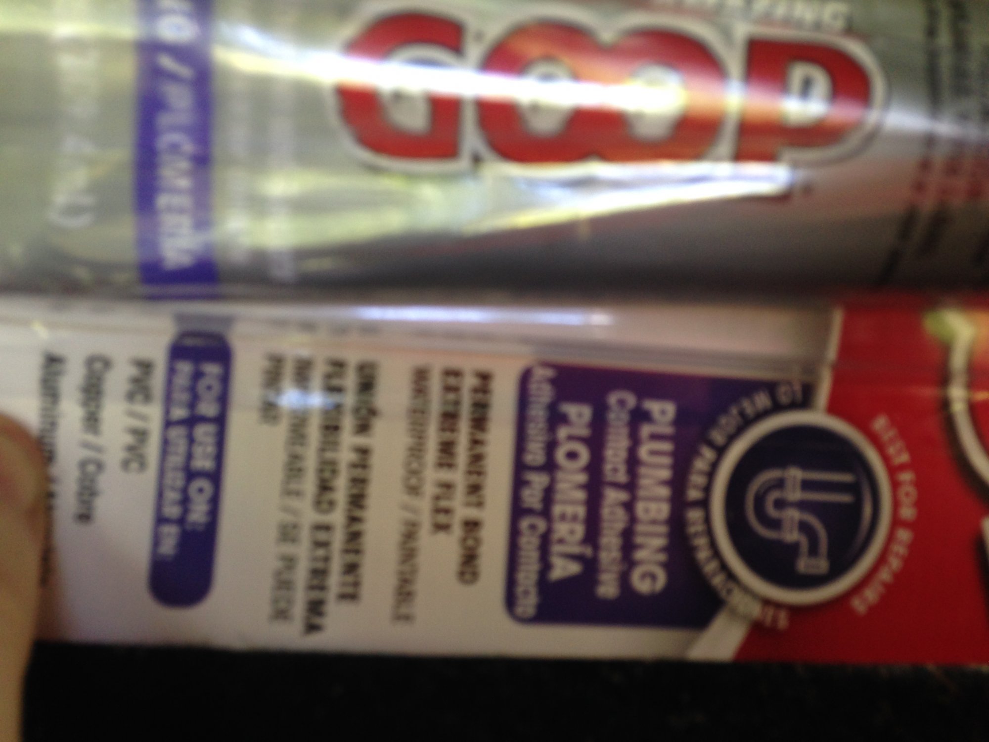

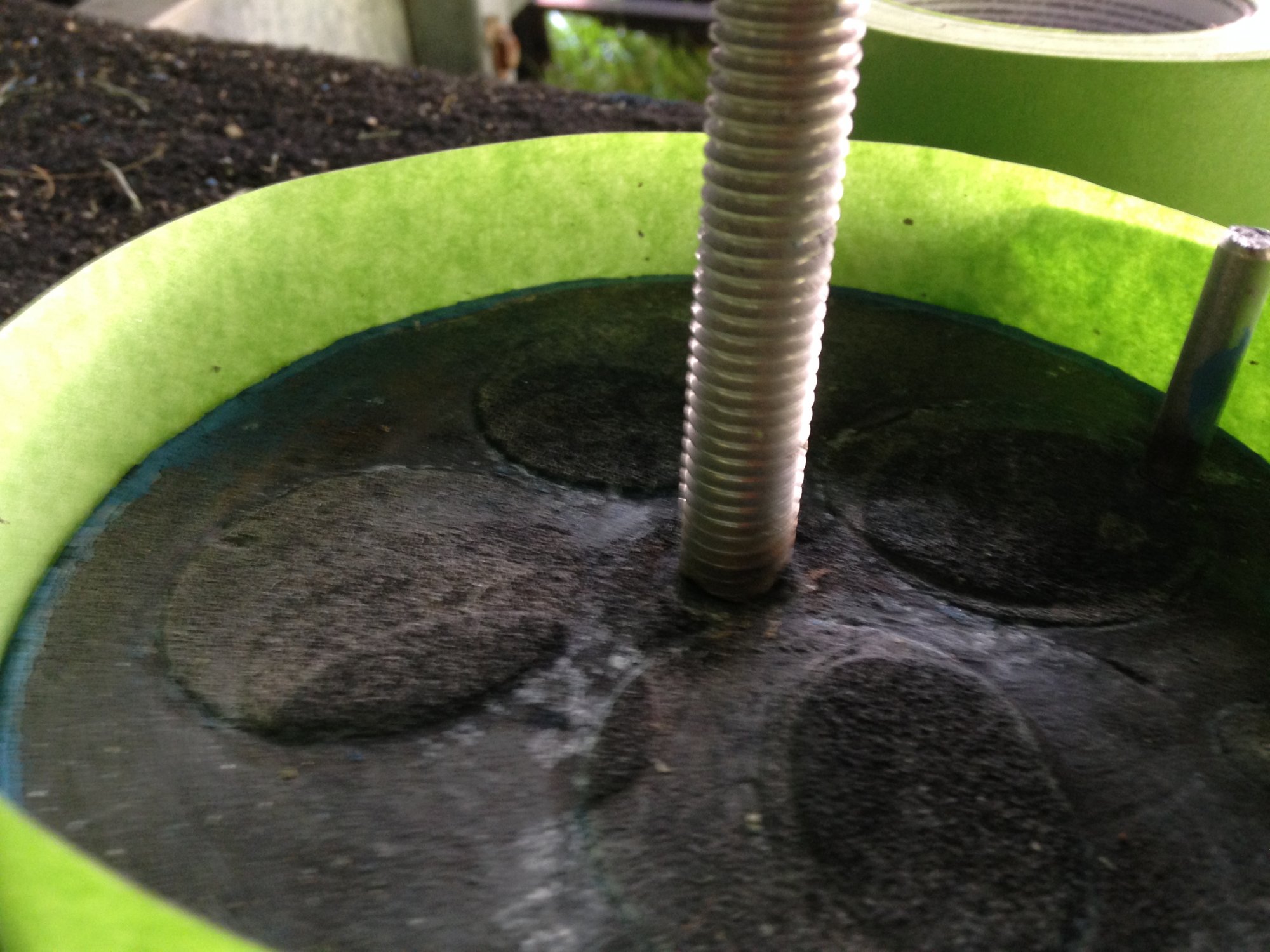

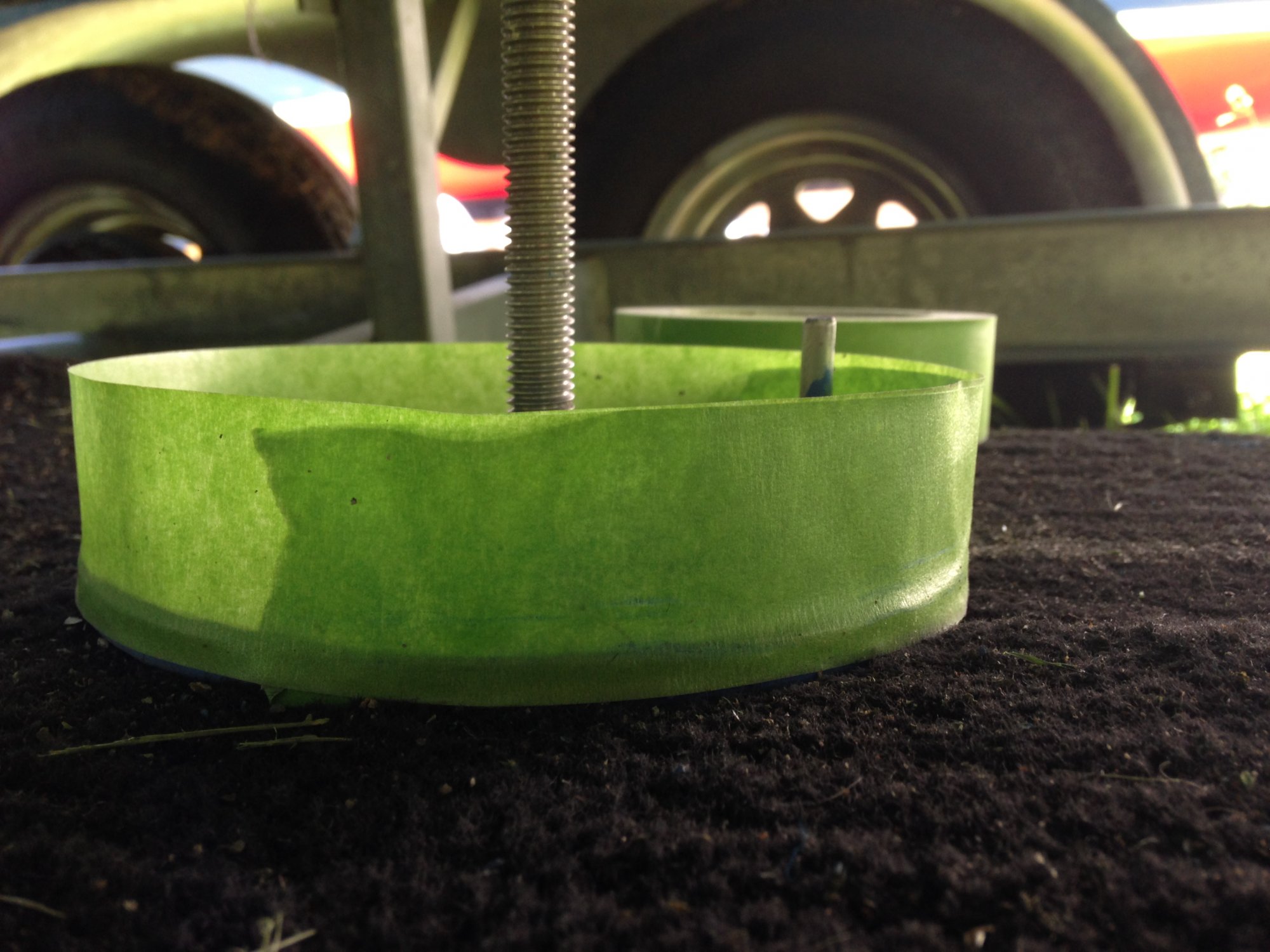

I have the same set up on my H26. I crawled under the trailer and made a "damn" around the valve cover using masking tape. Then poured some "goop" into the reservoir and let it harden up. It has been three years and still holding strong.

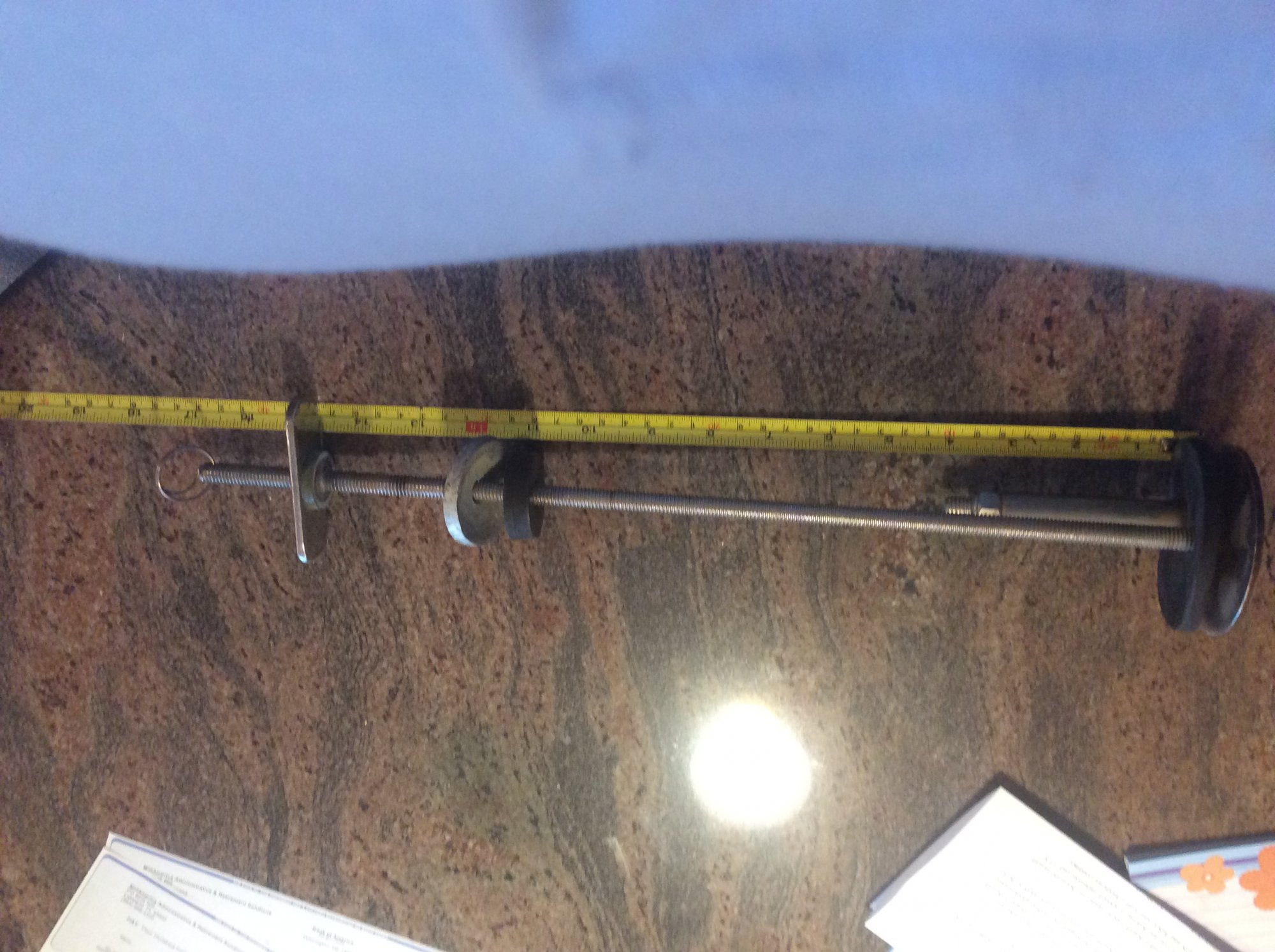

The picture I posted showing that the shaft was 16.5 inches is of a Mac 26S shaft that I had left over.
