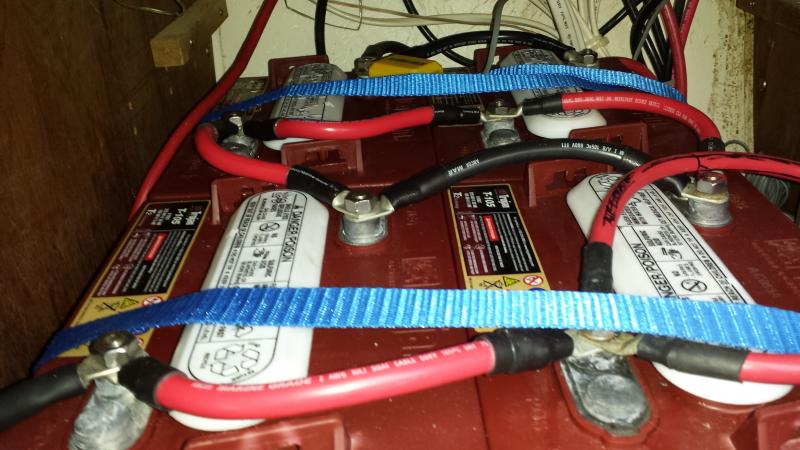

I've seen a lot of posts back and forth about battery choices, alternators, etc.
I did switch to 6v last year. I put 4 under the Nav Table.
As a house bank, it's tremendous!
Chris
