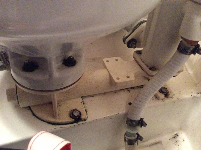

I have read all the links sent by Stu and I see that the head bolts pattern is not standard (should have guessed that too...). Has anyone ever found out how to access the other side on a Hunter 31?

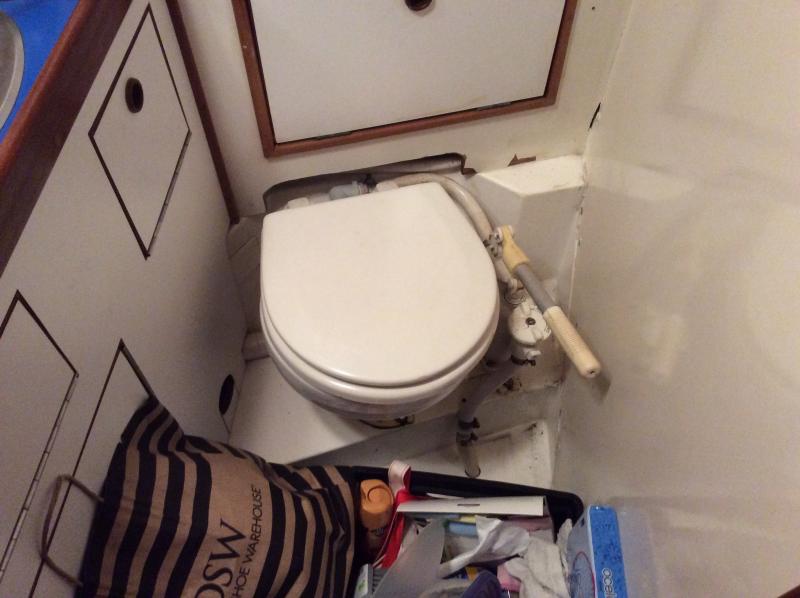

I am adding two pictures of the current head. Not sure if I have enough space for an electric head with a pump. I will do a lot of measuring before starting buying a new head.
Thomas,
I suggest you go back and reread my links. Head Replacement 101.
The bolts are LAG bolts, there are NO nuts below.

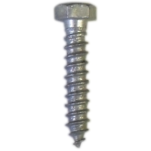

I did read your post but I was not familiar with "lag bolts" and misunderstood what they are.
For anyone else reading this, this is what a lag bolt look like.

Your toilet is a Raritan PH II...rated best manual toilet in its class for nearly 30 years....and hands down, the best manual toilet still in production in the US..keep it lubricated, rebuild it about 5-6 years, it'll last 20+ years. Trust me, it IS secured to the head sole with lag bolts (no nuts...they back out..no below-the sole access needed). As for the bolt PATTERN, there is no "standard" configuration...when switching out toilets, there will always be holes or fill and/or drill unless you replace with the identical make/model and the mfr hasn't ever changed it.
Your bowl may be green, but it's porcelain...it'll clean up. I'd keep it and replace the pump and base, which will give you a brand new PH II for about half the price of a complete new toilet. The online store here sells it...the part # is PHIILBA.

Peggie, as always, is right. Sorry, I missed blowing up your pictures, good head. The LBA is what you should get. Some of what Peggie mentioned are in the links I provided before. Good luck.

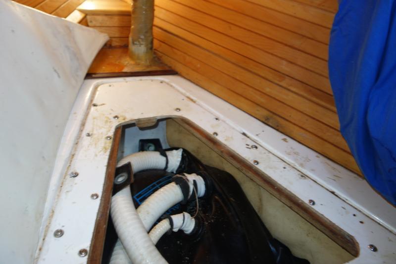

For added fun one of the previous owners opened the top of the holding tank with a jigsaw and put a bladder in it. The tank seemed "under pressure" so my first step will be to check the vent and try to pump it out. (Attaching a picture).
After reading what Peggie had to say about bladder tanks I think I will consider trying to fit a traditional holding tank in that space (will take measurement this week-end).
Another option would be to re-convert it into a real holding tank but that might be hard because they probably made huge holes to get the pipes in. I will look into that too.
I strongly recommend that pull that whole mess out and replace it with a new tank....AND hoses! Your best source for a tank is Ronco Plastics (no relation to Ron Popiel and his VegoMatic)...the make TOP quality rotomolded water and waste tanks for a very reasonable price and have more than 400 molds...over 100 of which are non-rectangular. And they install fittings in the sizes, locations and quantity specified by the customer when they make the tank. I believe you can order through the store here at a good discount off their already very reasonable price. Download their catalog Ronco Plastics Marine Catalog and then get with me privately to figure out what size, shape and location will work best for you.
