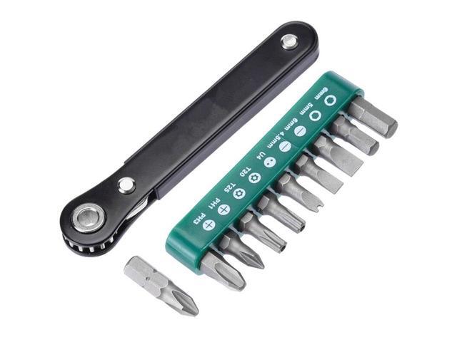

I like these 90 degree screwdrivers:

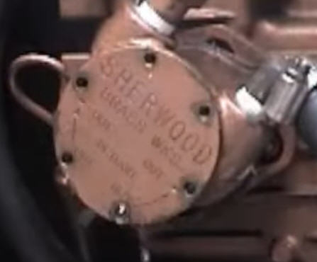

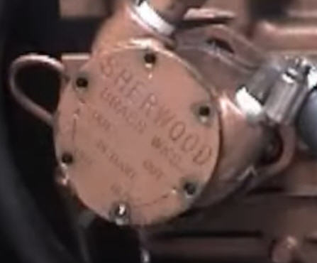

Your image is of the wrong pump. You need to look at the left side of the engine (based on the image you took). On he side where the oil dip stick is protruding.

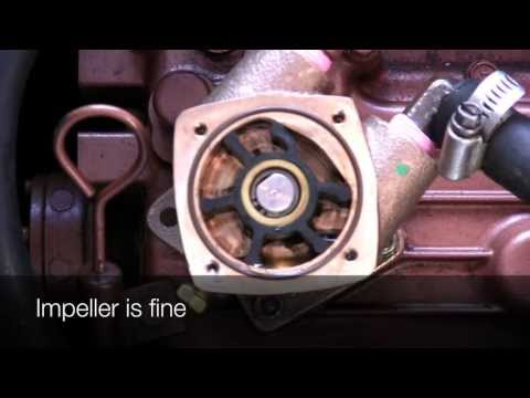

Here is a picture of the Sherwood Water Pump.. and the impeller. This one is ok.

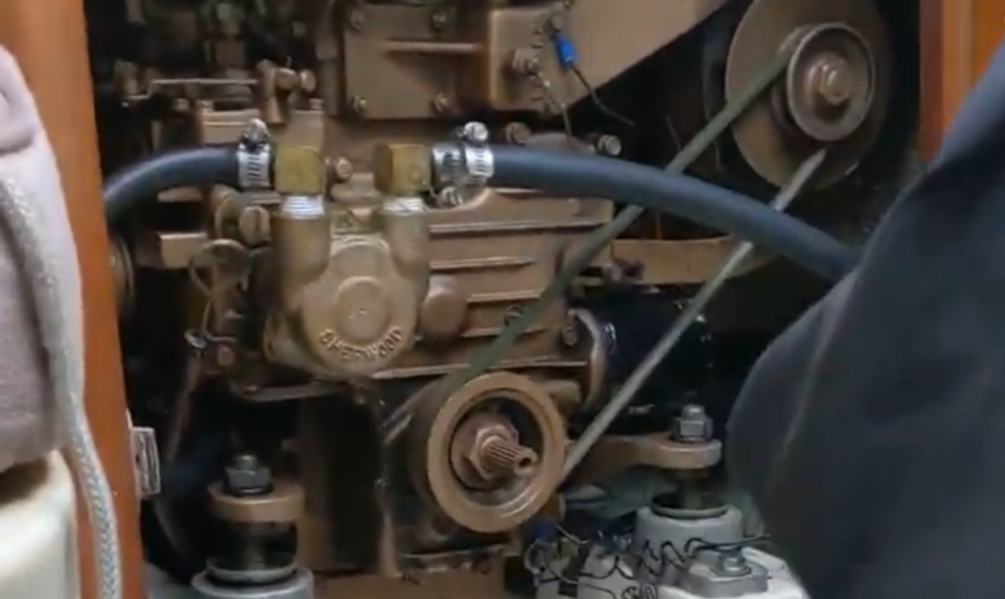

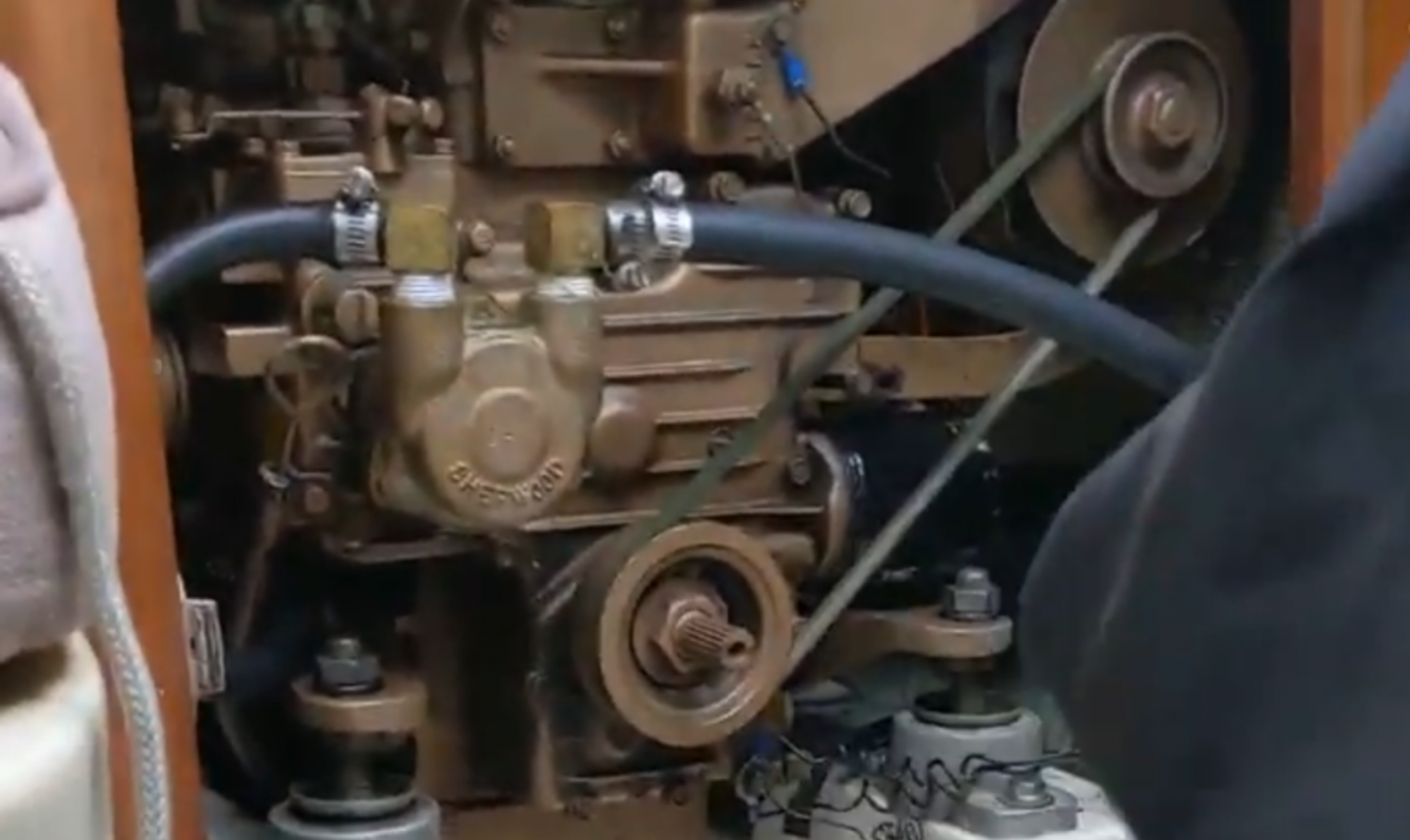

Hey John, My picture is of my engine (not a stock photo) with the new(er) Sherwood. Apparently, Sherwood changed the design of the pump at some point. Here is a photo of the old one. Looks like we've both been watching the same YouTube videos. The old one had the screws on the front plate to make changing the impeller easier but the newer one has the machine screws accessible only from the back. The general consensus seems to be that the Oberdorfer is a better pump and cheaper too.
