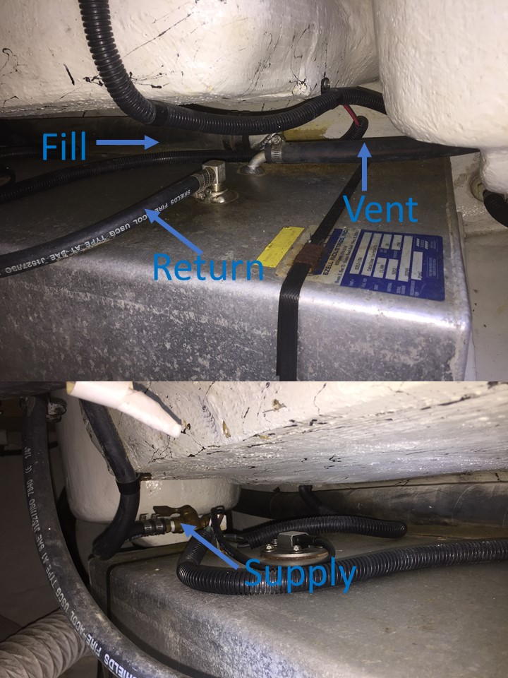

Thanks go to PaulJ for his great photos of the fuel tank. I should have realized that the outboard fitting is the supply line. Once, while motorsailng, the wind picked up and we heeled to port sufficiently that air was sucked into the supply line, and the engine died. It's plain to see now why that happened. Wonder why Catalina didn't reverse the lines so that the fuel pickup was closer to the centerline?

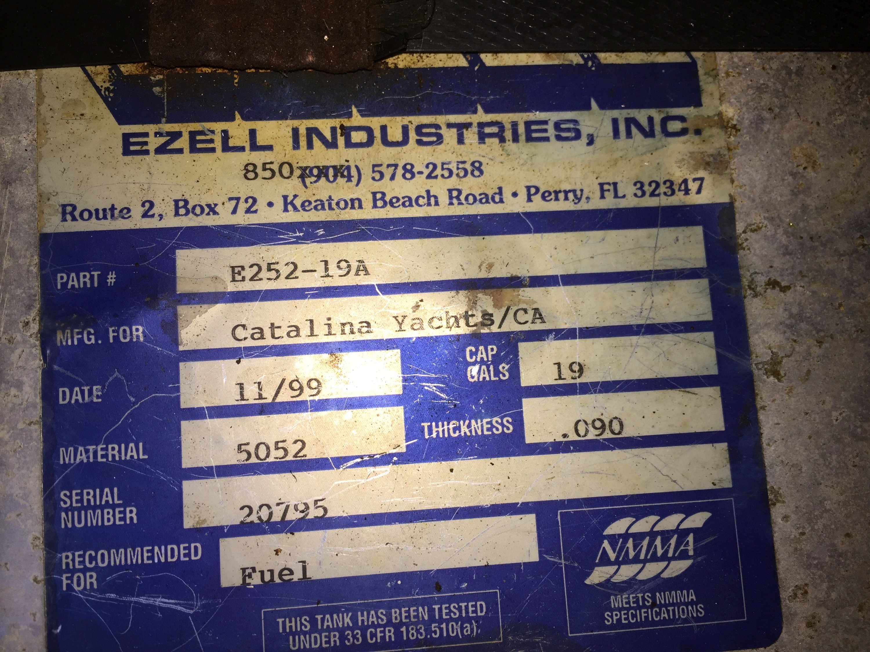

Finally crawled in the back and took some pictures. Looks like the early C310s had a different tank, mounted differently, but maybe the same manufacturer? Paul's is shifted to port, against the holding tank; ours is centered. Paul's valved return fitting looks to be centered; ours is more to port, with no valve. Paul's is painted; ours is bare. It also looks like access to the sensor is easier on Paul's. I've seen a brochure that says the fuel tank is 27 gallons, but ours is only 19.

That is definitely a way different tank than ours. I wonder if it was a replacement done later?
Date on the sticker is 11/99, so it's original. I'll bet the one on Bob's hull #1 looks like ours. I'm sure they switched tank types sometime between #31 and your # 65.
Nov 18, 2010
2,441
Catalina 310 Hingham, MA
Maybe. But I also find it interesting that it says "CA" after the Catalina. I am pretty sure that all the 310s were made in the east coast facility. I wonder if they found a problem during commissioning and this was the fix .
