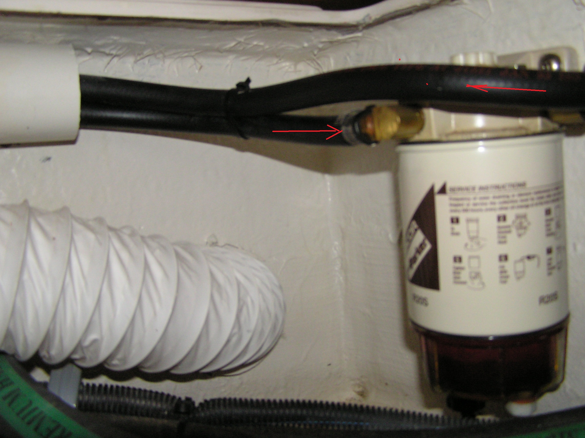

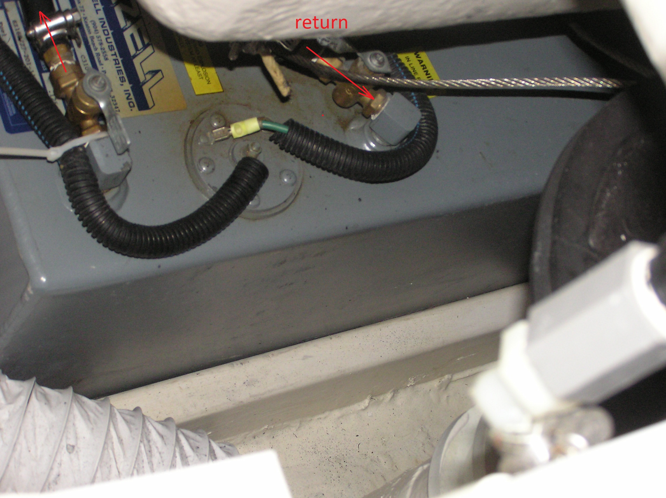

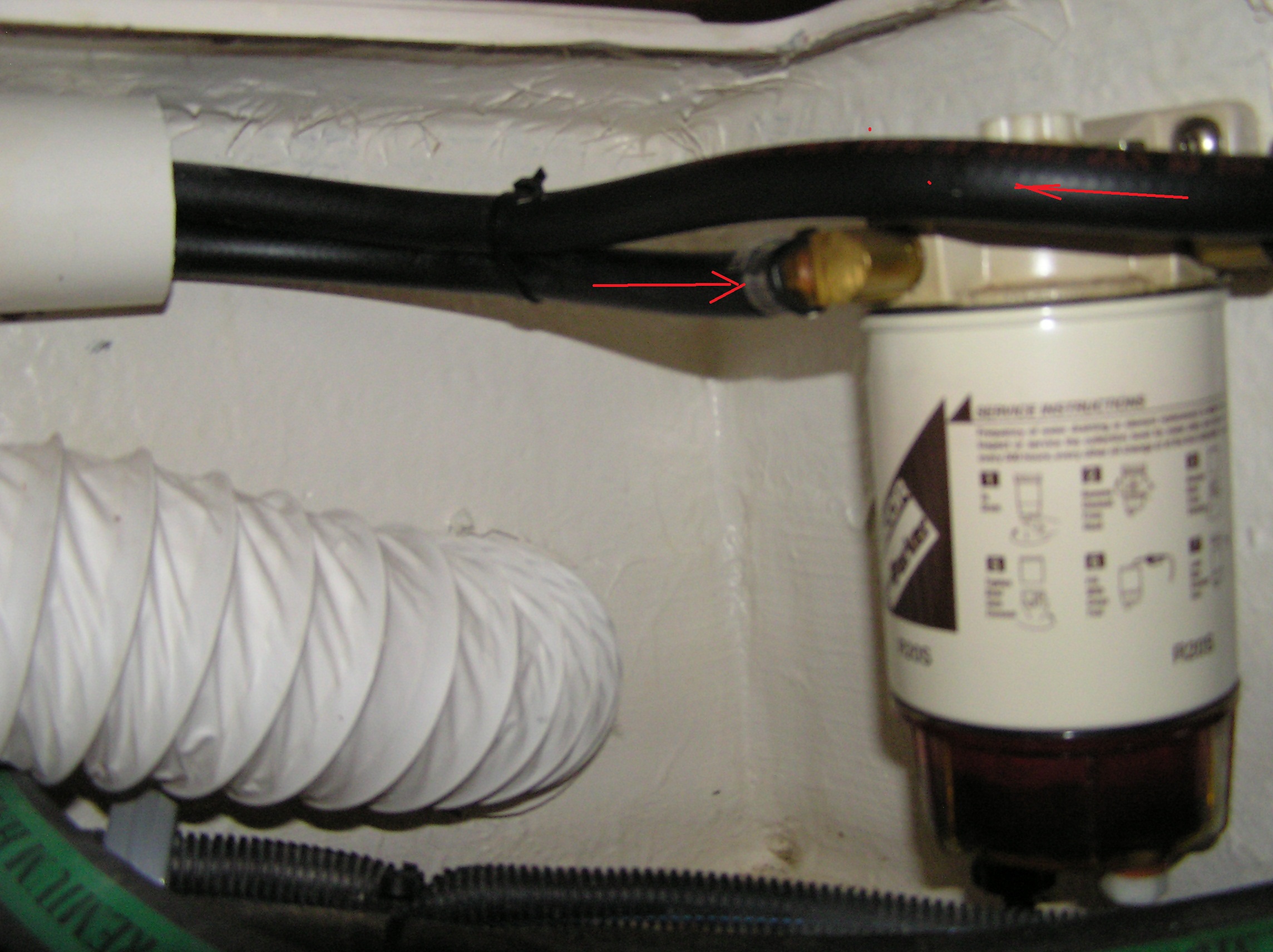

I have changed the fuel filters on my catalina 310 numerous times. I am familiar with how to do it, but have a new issue. Normally I close both valves on the tank one would be for the supply to the engine and the other for the return. Since the engine is gravity fed from the fuel tank if the valve or valves are not closed fuel would continue to run if you did not close the valve or valves. My question is when looking at the tank, looking toward the stern there are two valves one to the right of the fuel sender and one to the left. The one to the right is easy to get to and turns very easily, the one to the left of the sender is harder to get to and does not turn very easily in fact I am afraid I will break the handle off if I continue to turn it off. The questions are do you have to turn off the return valve and is it the one to the left of the tank.

I've never closed the return line on any diesel engine I've owned. Not sure which valve it is on your engine but it should be easy enough to follow the fuel line from your filter to the tank and see.

Mark. Only way to know for certain is to trace the lines.
You may be able to start the engine and see fuel returning to the tank (if the tank is plastic and see thru).
You could tell if you start the engine. Close the easy to turn valve and see if 1. Fuel starts spraying out all over. Oops that is the return line. 2. The engine stops. That is the intake line.
Or you get some PB Blaster or penetrating oil and work the non functioning valve till it is free.
One clue, I would think the side with the internal long hose to the tank bottom is the intake and the short hose is the return side.

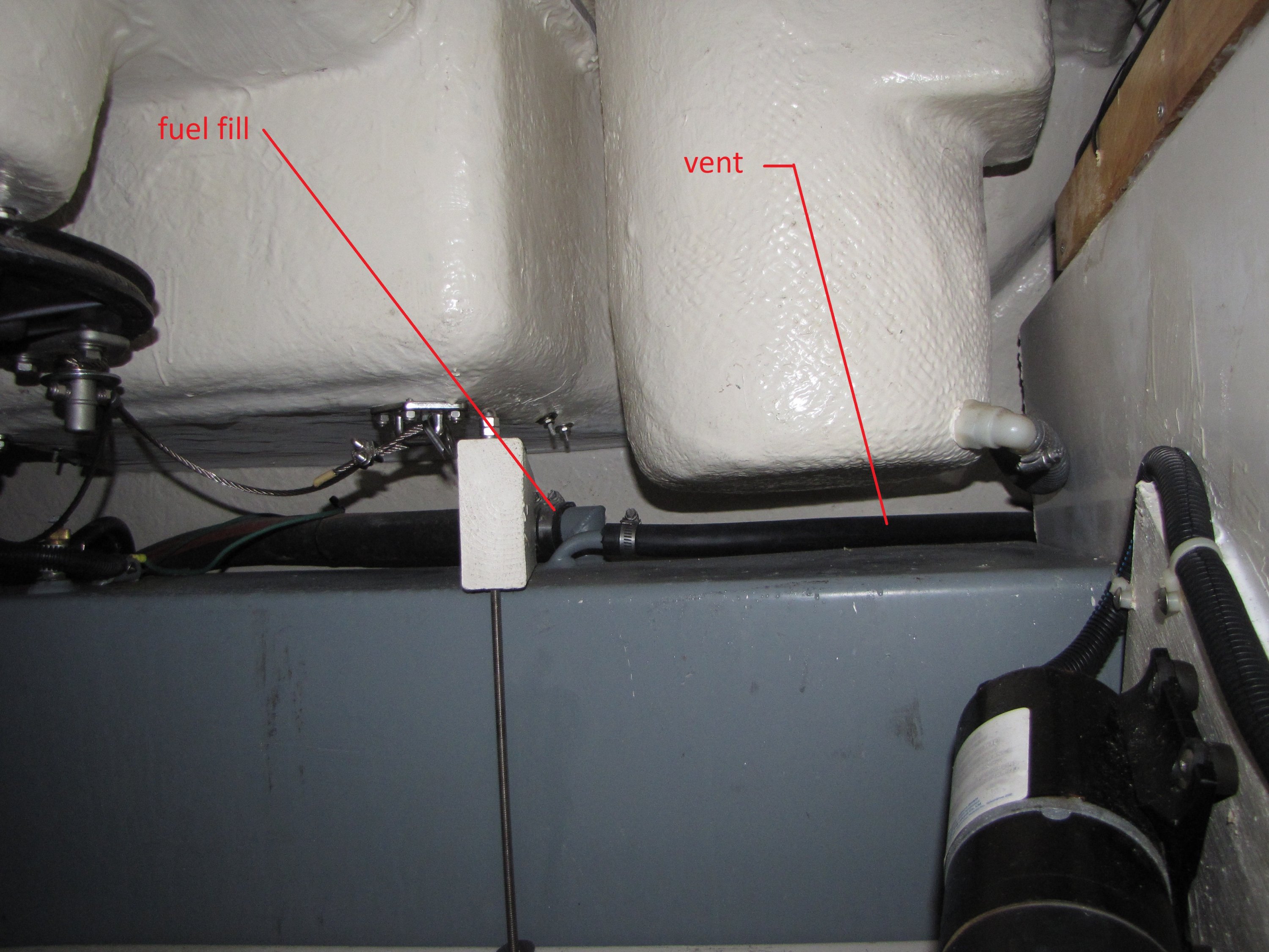

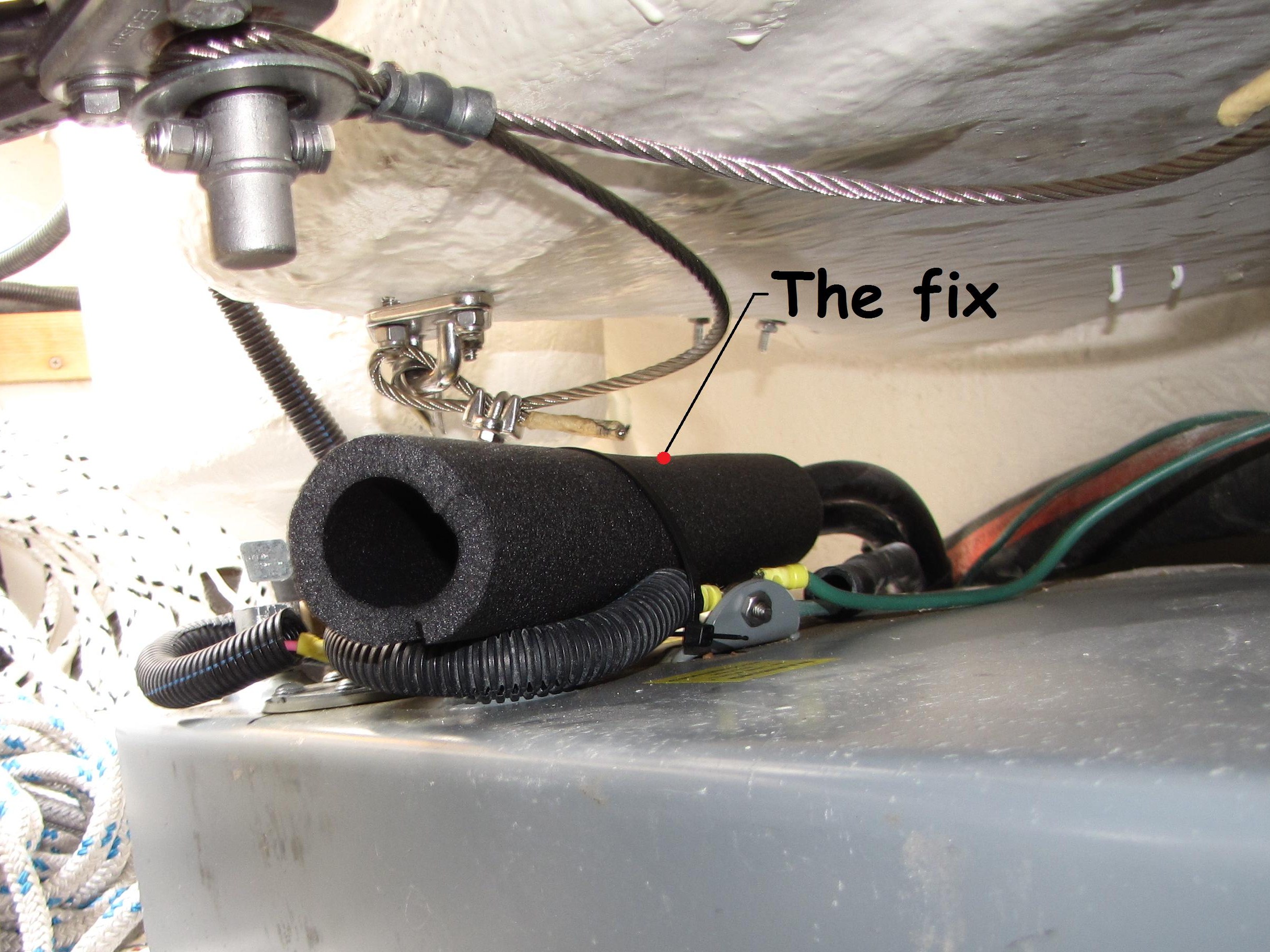

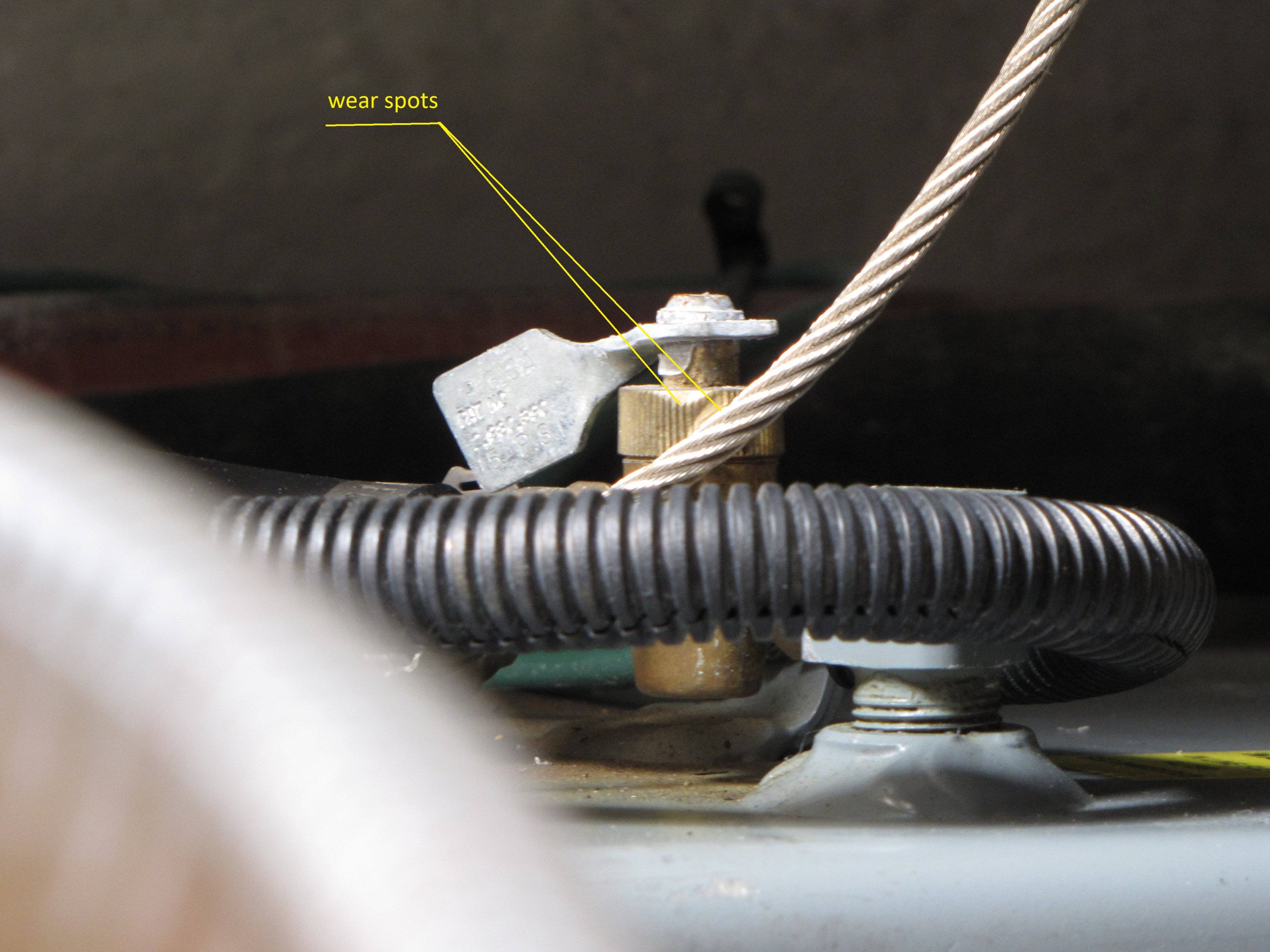

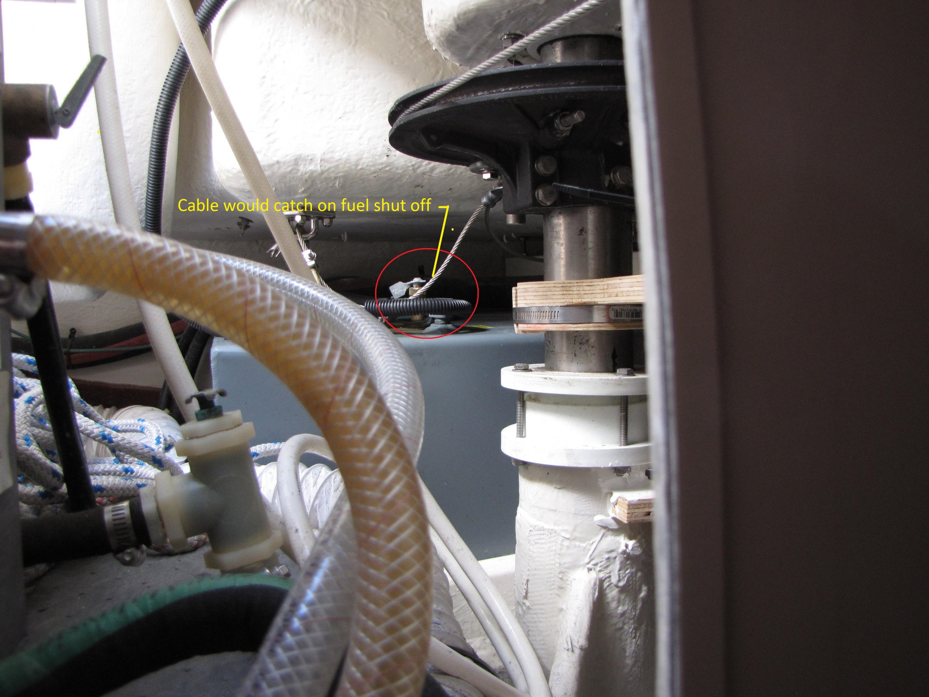

@paulj That is what I am talking about. Way to go. What a clear and easy to understand set up. Liked the way you resolved your issue.
:worship: you get a crew giving you adoration.

Thanks again for everyone's advice. I finally did what I should have done in the beginning, I lubricated the valve and it now turns very easily in fact I may need to tie wrap it so it doesn't vibrate closed. It was the supply valve.

Is yours the same color as PaulJ's? His looks painted; ours, hull #31, is bare aluminum. I'll have to check this weekend if we've got two valves, or just one.
