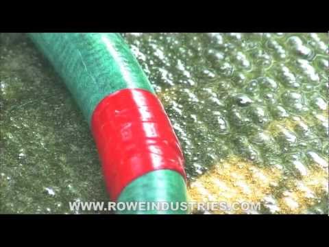

If the connections are accessible, which I'm sure they are, attach the new hose to the end of the old hose with very strong tape, like Gorilla or a tape designed to attach to rubber hose, and pull it through.
Remove any snaggers i.e. hose clamps and zip ties.
Wrap the tape on with many turns, but not too thick in one spot.
Like the picture. Except pretending that's 2 hoses attached to each other. Also you'd need tape longer down both ends of the hose to ensure it stays attached.
You'll have to analyse the hose route in your boat to determine if this is feasible.
