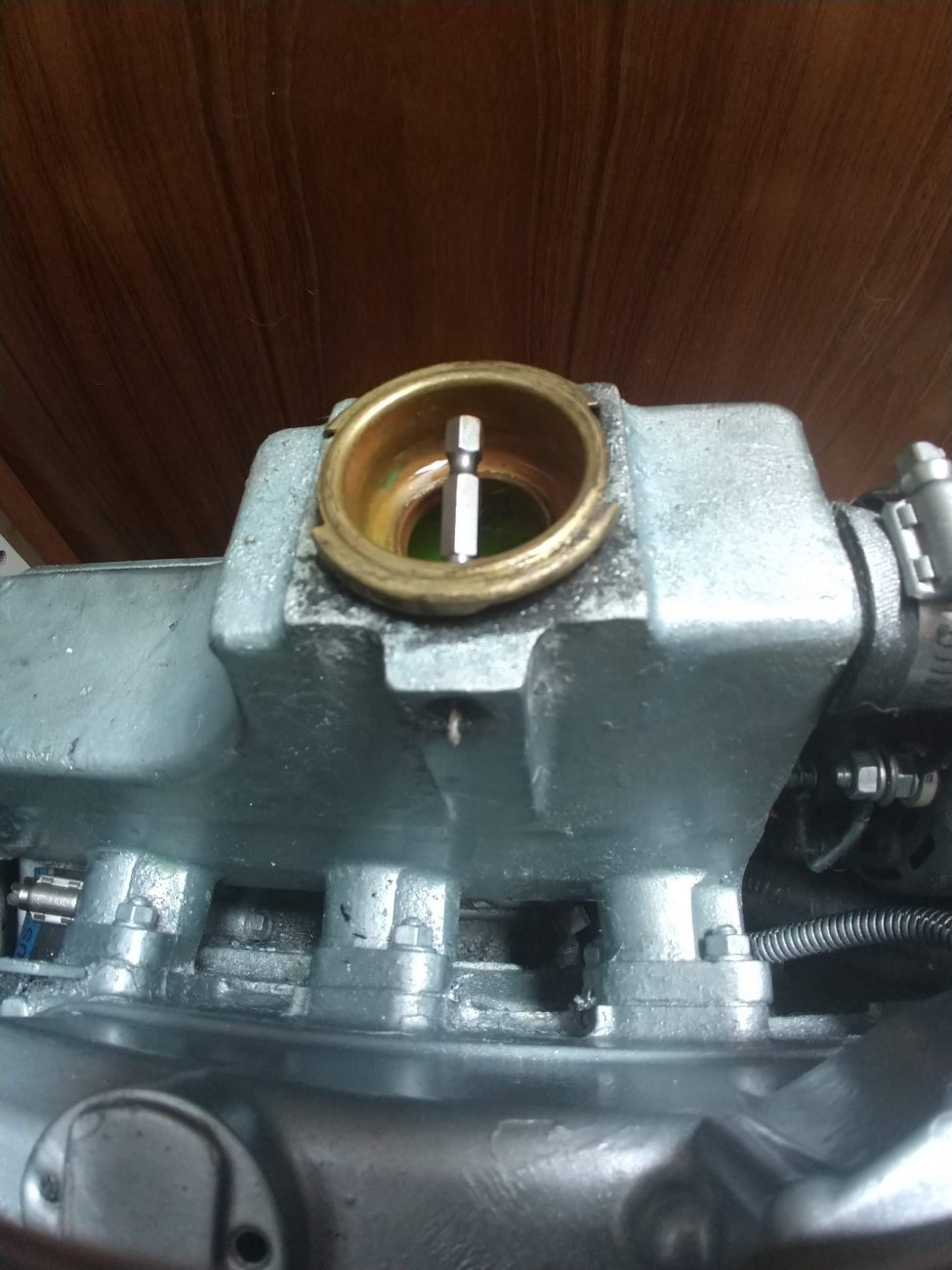

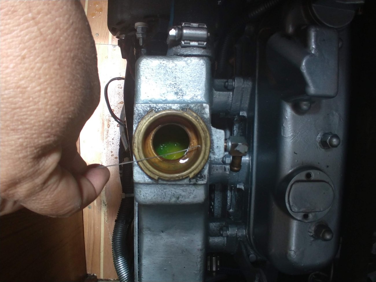

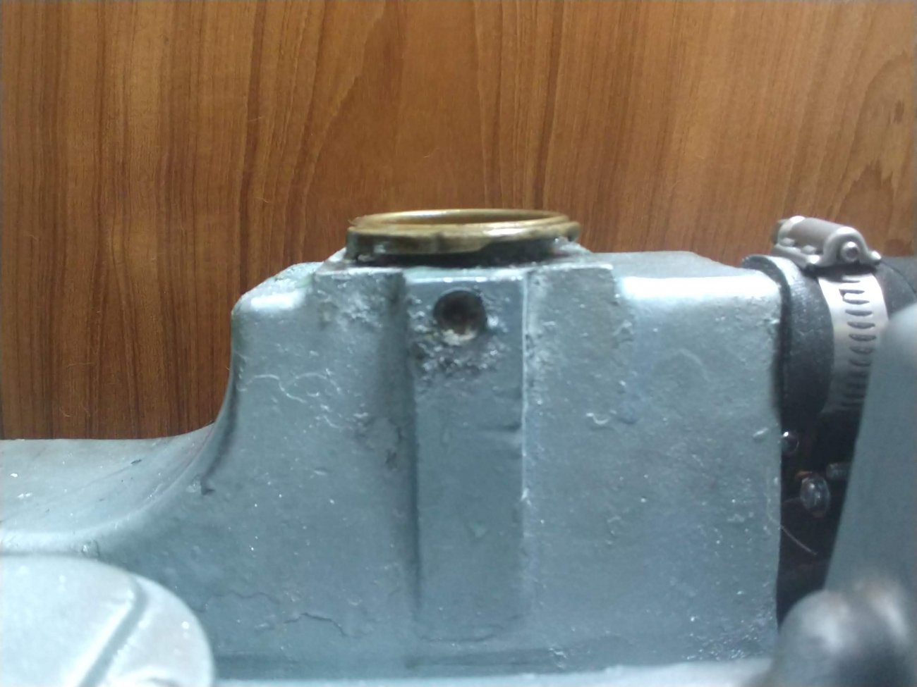

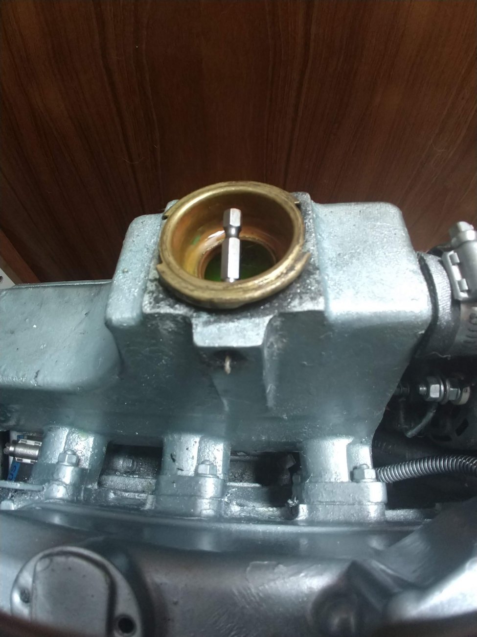

Something interesting I found a couple of months ago. The engine was getting a little warm but the coolant level in the tank wasn't changing. I found that the hole that goes from the pressure cap to the coolant tank was blocked. I used some small drill bits turned by hand to clean it out.

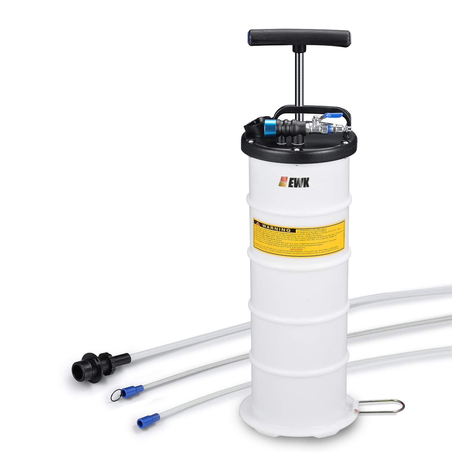

I have a 6-qt manual oil extractor (rather old) left over from my motorboat days. I empty the reservoir on the bulkhead with a couple pumps of the extractor hose. I then put the extractor hose in line with the hose to the water heater, give a few pumps, and let it fill up. The only mess is the fluid that come out of the water heater one before shoving the cain hose inside. That is taken care of by a small plastic cup and a few paper towels.
Interesting. I’ve got two small oil extractors, so I could try that. Of course the antifreeze would get contaminated with oil which might make it harder to dispose of properly.
