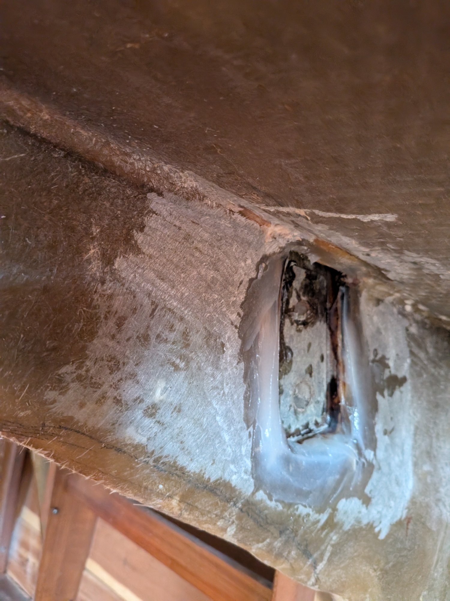

This was the most time-consuming and frustrating part of the project. The chainplates were bolted to 4-inch-thick fiberglass “knees” (struts connecting the hull to the deck) and embedded in the fiberglass itself.
Caption: Chainplate embedded in fiberglass after bolt removal, before cutting.
Caption: Fiberglass cut away to free the chainplate, showing the messy process.

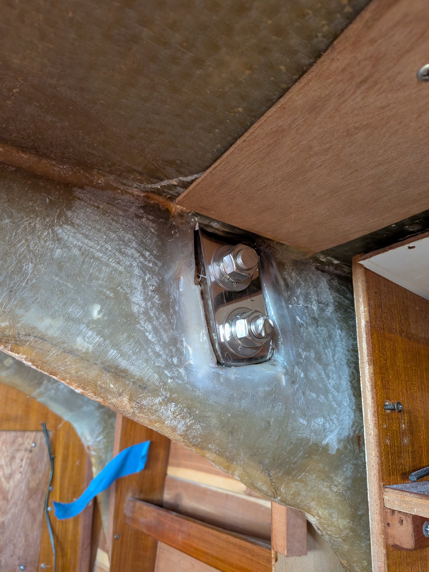

Cutting the fiberglass weakened the knees, so I reinforced the cut areas with new fiberglass and epoxy resin.
Step 5: Installing the New Chainplates
The new plates were positioned, marked, and removed to drill bolt holes. I double-checked alignments to ensure a secure fit.

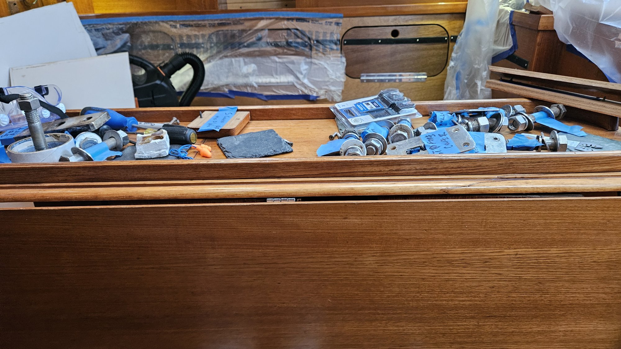

- Process: The cabinets were beautifully crafted with no glue in the joinery, which was a relief. I was worried about damaging the wood or stripping screws, so I opted for a hand screwdriver instead of a drill. This slowed things down but ensured no damage to the fasteners or wood.
- Tip: Label every piece meticulously! I used painter’s tape and a marker to number each of the 80+ distinct wood pieces for reassembly.

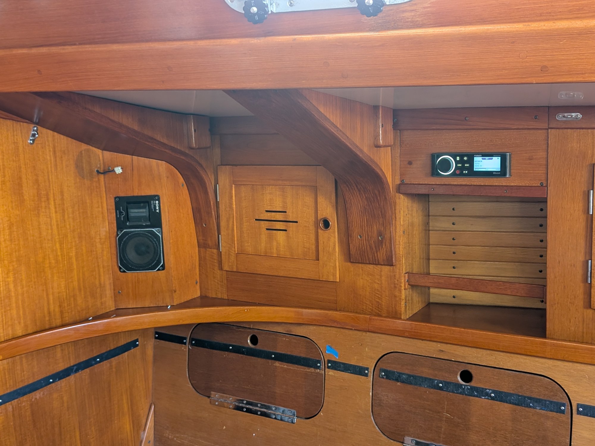

Here is a picture before I started removing cabinets.

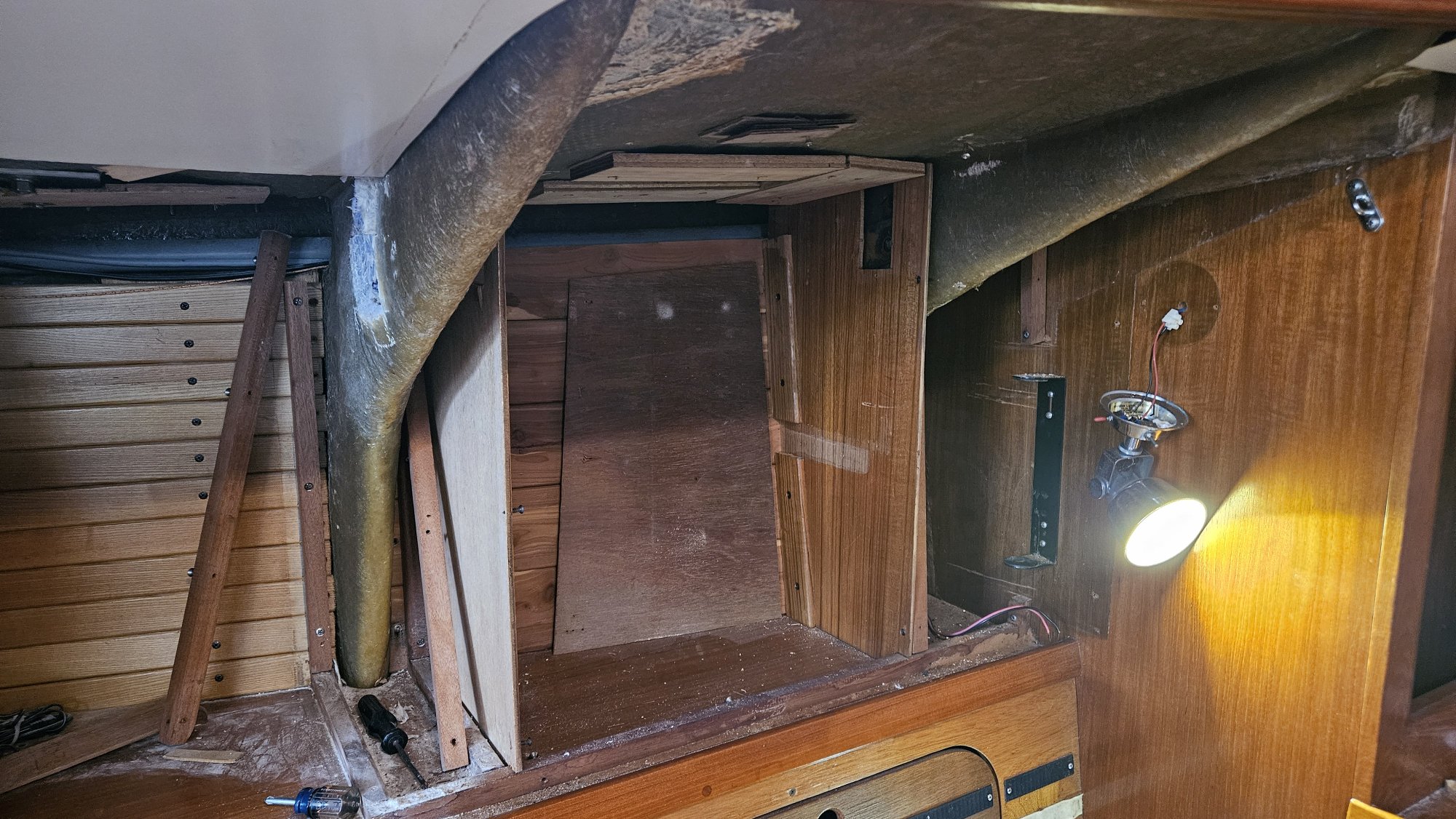

Here is a picture with Cabinetry removed, exposing the chainplates and knees.

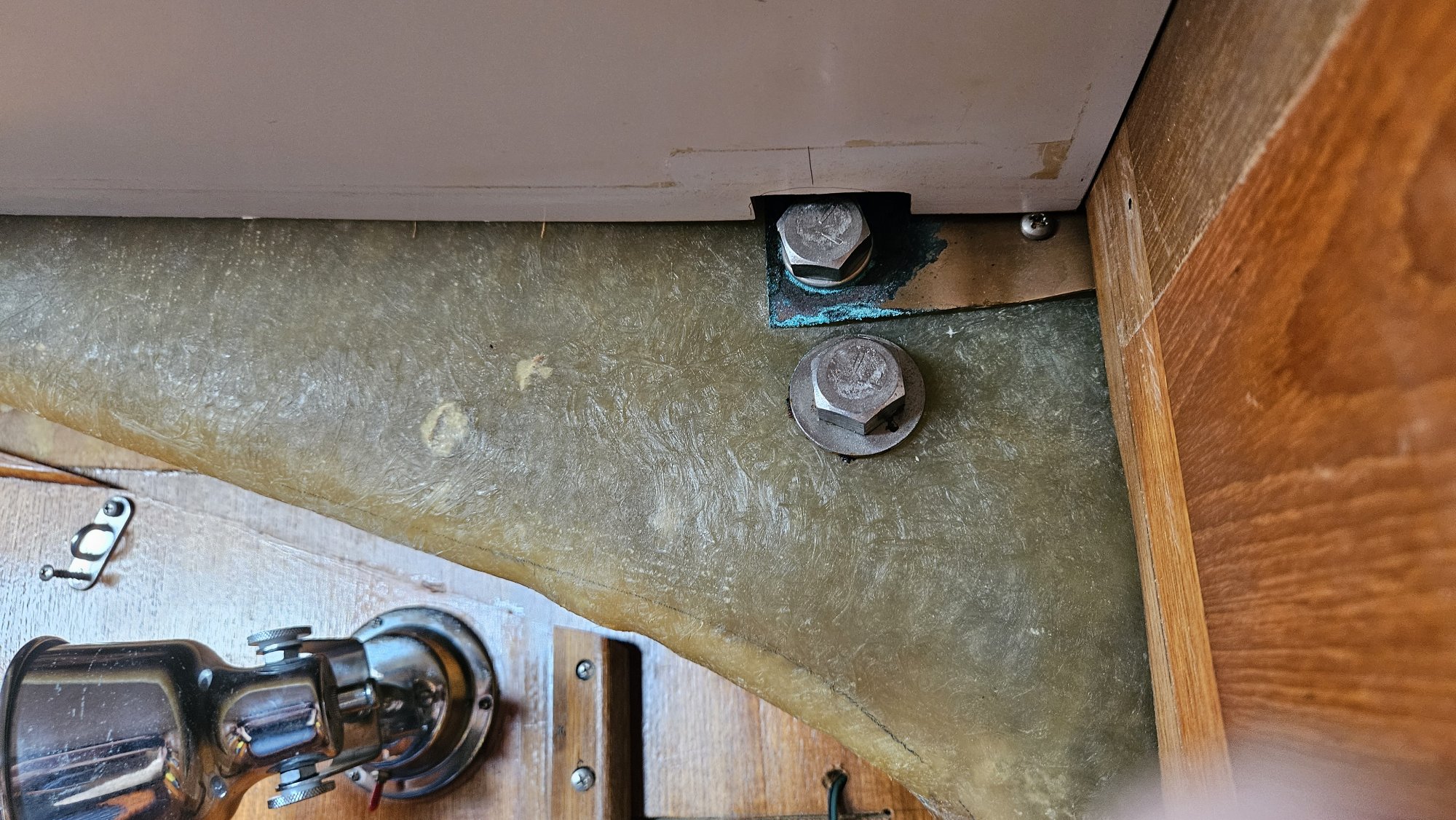

- Initial Attempt: I removed the bolts easily enough, but the plates were glassed in tightly. I applied DeBond Marine Formula from above and below, letting it sit for 24 hours. Hand-pulling didn’t work—the plates wouldn’t budge.
- Escalation: I rigged a portable car jack with a chain to pull the plates. The plates were so secure that they bent the jack!

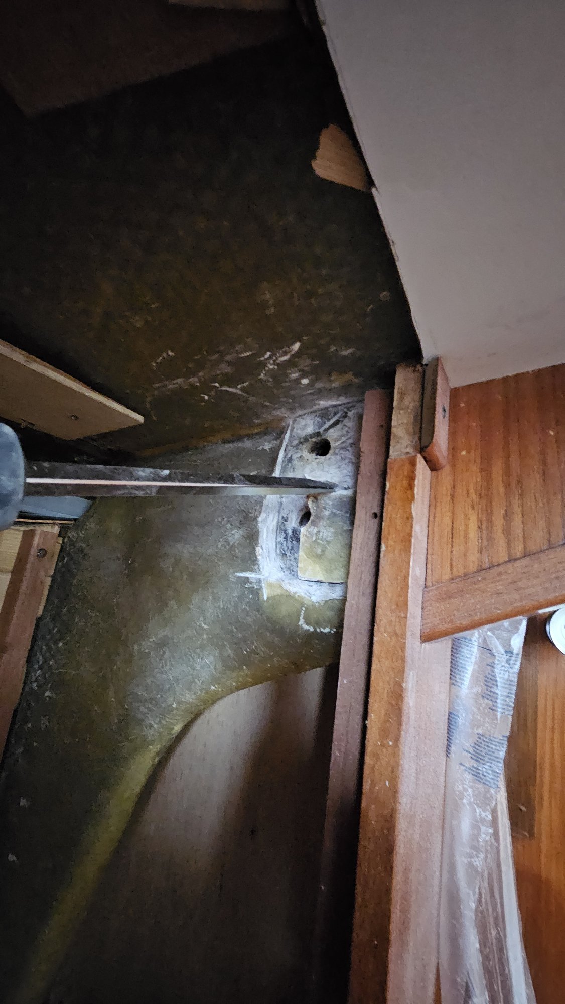

- Cutting the Fiberglass: After consulting the marina’s service manager, we decided to cut the fiberglass to loosen the plates. I used an oscillating multi-tool with carbide metal-cutting blades. The aft plates were accessible, but the mid and forward plates required hours of awkward positioning, swearing, and sweat—“boat yoga.”
- Safety Note: Fiberglass dust is hazardous! I used an N95 mask, safety glasses, earplugs, and a shop vac to minimize the mess. Despite masking off areas with plastic sheeting, dust got everywhere. Ensure good ventilation and full protective gear.

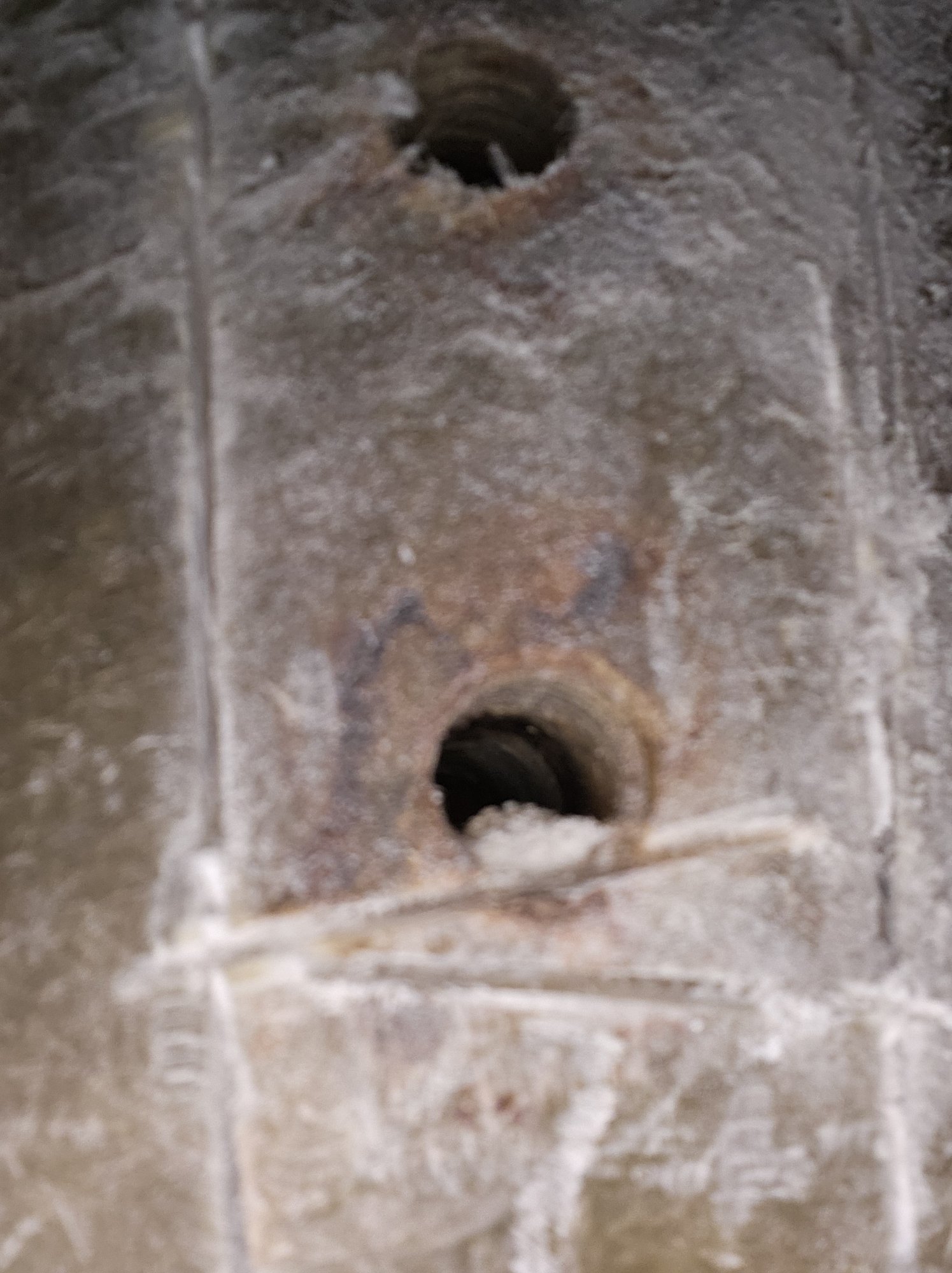

- Final Extraction: After cutting, I used a heavy-duty floor jack to lift the plates. They moved an inch at a time, requiring me to knock them back down with a hammer and reapply the jack. This was tedious but eventually freed each plate.
Caption: Finally free! The chainplates after extraction.
- Materials: I used woven roving fiberglass cloth and West System epoxy for its strength. I applied multiple layers around the cut edges to restore structural integrity.
