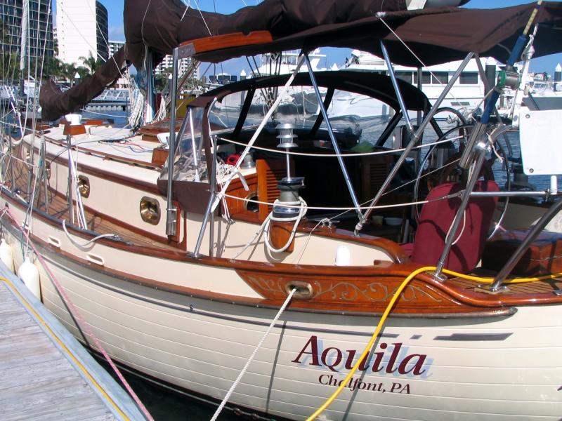

Here's an example of the modern 2-part + 2-part coatings. These pics show what such looks like after 8-10+ years of sun exposure. The only maintenance that was done was an occasional 'quick' clear coat overlay (1 day) and an occasional 'power buff'.
The coating here is Honey Teak; but, Bristol Finish will have equal results. With both, the 'trick' for long lasting service is THICK coatings so that you get sufficient 'build' so that the UV filters can protect the upper layer of wood cells so you dont get 'lifting' due to the 'UV burn'.

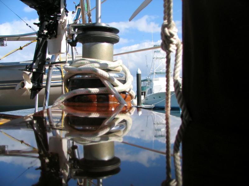

The pic of the winch / cap rail is what such looks like after 'flat sanding with 1000 and 1500 w&d paper' and then power buffing.
I can live with an every 10-12 year 'complete re-do'.
