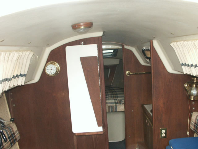

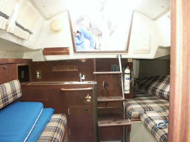

When I bought our O'Day 26, the interior was a mess, with rotten bulkheads. I removed all woodwork, replaced what was damaged, and then started cleaning the old stuff that was still good. I used Don Casey's mix of water, laundry detergent and bleach. Soaked it in good, brushed it with a stiff brush , rinsed and dried by the wood stove. Then I went one step further to try to match the old to the new. I soaked in a solution of oxalic acid and rinsed and dried. Then sanded enough to take off the raised grain and soaked in a homemade solution of 1 part solvent based gloss polyurethane, 1 part boiled linseed oil and 1 part mineral spirits. Soak in just like stain, and after no more will soak in, wipe with a linen cloth. When dry, lightly sand and do again. when the solution starts to "stiffen" wipe to a nice satin finish. Now the only maintenance is a yearly wipe down with lemon oil.
