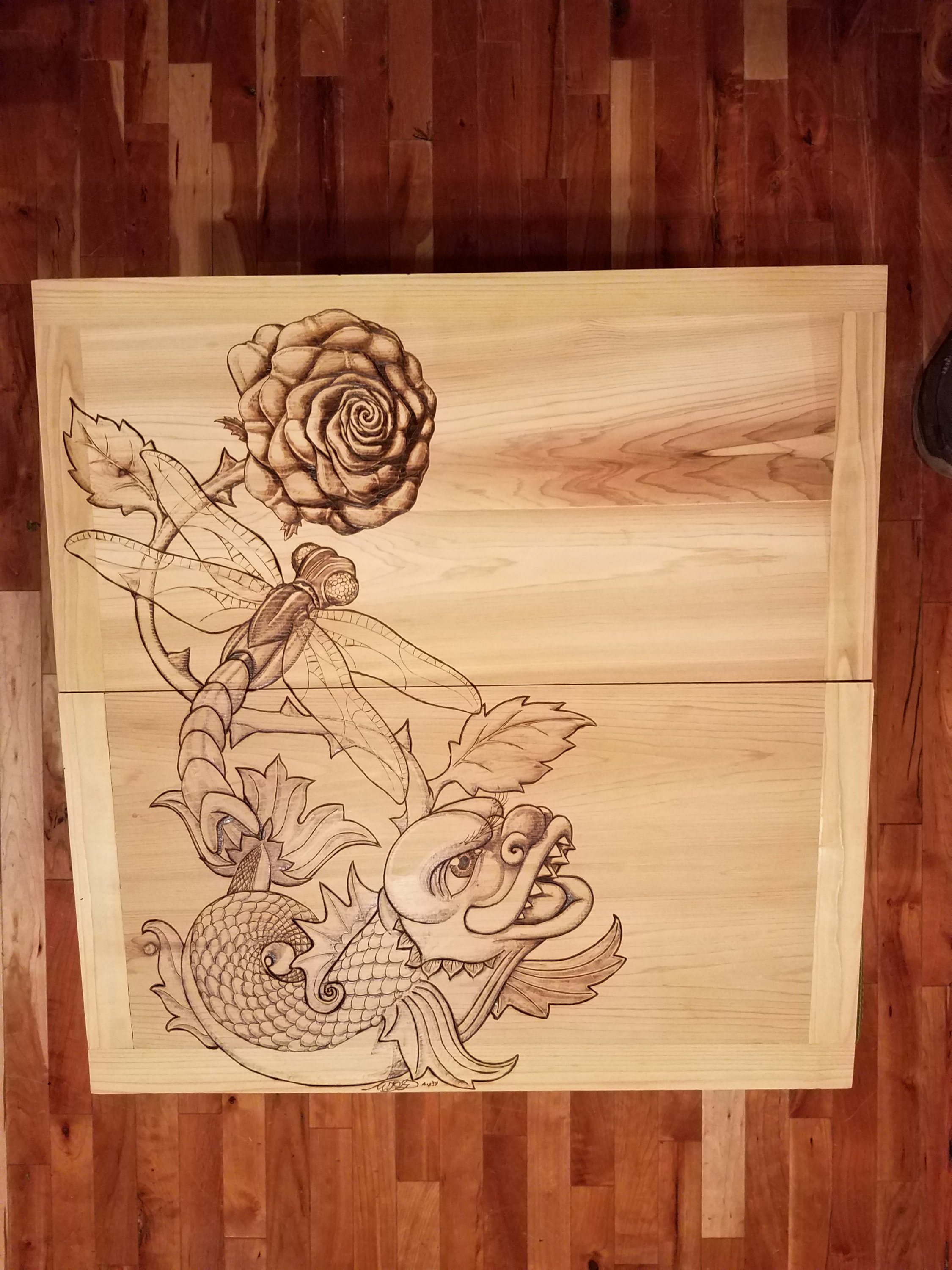

I've been a cabinet maker most of my life and recently started making art enhanced wooden parts like doors and hatches. Check out my new wood burned hatch boards I made for my boat Dragonfly. It's my profile icon. My new art.

Very nice Art Work, and a load of valuable wood finishing information. Thanks Will.
Oct 19, 2017
8,169
Thanks for the compliment. I wrote up and posted the hatch board project on the mariner association web site. Didn't know how to get the pictures to post inline with the text so it turned into 9 pages of separate posts, just to keep the images associated with the right paragraphs. If I figure out how to do that here, maybe I'll repost it on SBO.
