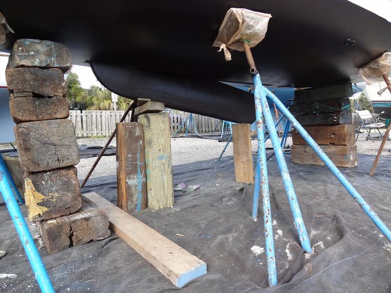

Regular guy;
May I suggest if leaving the mast up other than taking the mast up and down, keep that forestay attached. I have seen a mast fall when the wind took it down as the owner left the mast up just using the mast raising as an attachment to keep the mast up for sometime. I saw this in your picture. In addition, I would not suggest anyone going on board when the boat is on the stands. Call me being cautious as I like to see folks safe and around. A+ for using 8 stands sir.
Jan 18, 2014
238
Hunter 260 Palm Coast, FL
Regular guy;
Hi Dave,
Your concerns for the safety of us when working on the boat is appreciated! In this particular picture I was in the process to relieve the pull of the forestay on the deck shell by taking the mast down; some sealing work had to be done. I will try to phone; hope the number got still works.
