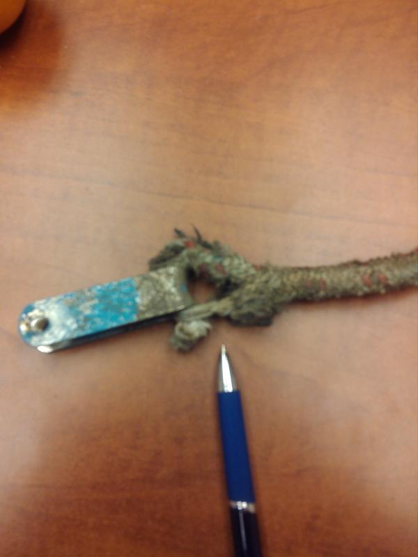

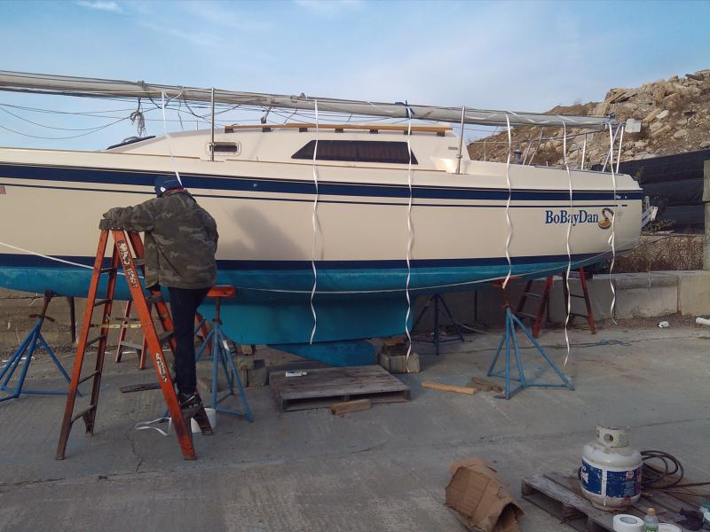

I wanted to share this photo of my '84 O'Day 26 centerboard pendant. I bought the boat 4 years ago and never had a problem with the centerboard. I didn't know how to check it out but I was worried about it. After following the helpful advice of Joe (sailtrinkka) on this web site I put the boat on stands and raised the keel about 18" off the ground so that I was able to lower the centerboard enough to look at the pendant. As you can see the pendant only had a few threads left on it. Boy am I glad I checked it out. It is a simple enough fix: order a new pendant from D&D, attach a chaser line to the cockpit end of the existing pendant and pull it through to the bottom of the keel. Then attach the chaser line to the new pendant and pull it back up to the cockpit. Wonder if I can get another 28 years out of this new pendant?
