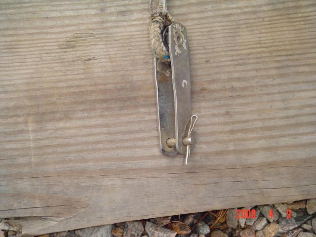

Does your centerboard pendant line have a long shackle on the end like mine?

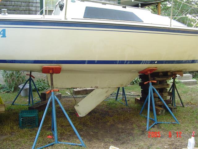

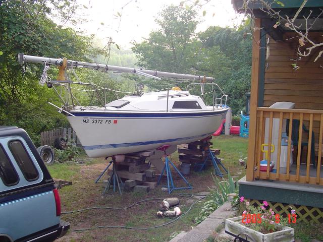

Thanks to all who have responded. Especially the pics of the boat on stands as mine is. appears that I can kick out keel blocks and drop centerboard enough to install.
Jack
Jan 24, 2005
4,881
Oday 222 Dighton, Ma.
Jack
Make sure that you shore up the hull under the stern and bow with wood blocks as I have done, just to be on the safe side. I was able to raise my empty 222 with the sailboat stands, even though I know full well that boat stands aren't made for this purpose. With that that said though, I used four of my boat stands in the stern of my friend's OD 26, plus a hydraulic jack under the bow, and poppets caused the hull to oil can a little. I was able to raise his boat off the trailer so that we could move the trailer over to have the keel sit squarely on his trailer's keel board. When dealing with this kind of weight you need to take every precaution by having backups in place, just in case something goes wrong. In the event that the string parts in the tube and you need to fish another tag line through, there's a small sheave that the pendant line goes through way up inside the centerboard slot. The pendant line needs to go through that sheave. The backup plate and the nuts and bolts for this sheave can be seen in the cabin at the soul plate where the tube and hose enters a hump. Good luck!

Yes it does.
You're all set then. Some of the O'Day 25s have a wire to rope attachment at the centerboard. I guess there were years when the O'Day designers did a lot of experimenting on their boats. If you have the shackle, chances are you probably have the sheave up inside the centerboard slot. It is attached to the top of a smaller slot up inside the keel slot.

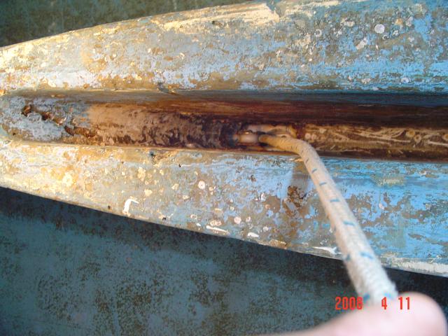

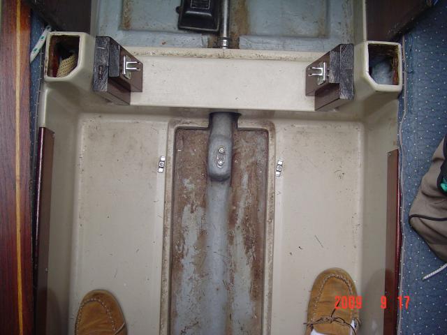

You may be able to do it Skip. We have a 1975 O'Day 25 in my YC. In fact, I sailed it up from the Cape to our club for a guy several years ago. The board on yours is no heavier than the ones on the later models in spite of the fact that yours has a metal winch cable. Rudy claims that you can get away with braid line in place of that cable. If you look close at the two pics that I provided above. One shows the inside of the keel slot where you can see the rope going through the single sheave, and the other shows my companionway mounts with the step removed and a pipe entering into a small fiberglass hump. Looking at the hump, you can see a small backing strap held in place with two bolts and two nuts. This hump is actually that small enclosier at the top of the inside keel slot and those bolts with the plate are what holds the sheave in place. If you have the room under your cabin sole to construct something similar to it for your boat, you may be able to do it. It would just require a longer pipe and a sheave. It would take careful planning though. If this isn't possible, maybe you could do it externally somehow with sheaves. It's worth looking into.

It would probably be a good idea to try to get the boat in a position where the keel is exposed so that you can let the centerboard down and see the pendant line connection on the board. I remember diving down under my friend's 1975 O'Day 25 with one of the guys in the club with SCUBA gear on, to free up his stuck board. I had brought an old hand saw from home to let him use to free it up. When he got it free, it swung down pretty easy and I hefted it with my hand, but I don't remember paying attention to the cable connection on it the board. Anyway, it's important to know the type of connection to the board, as well as the width of the board, and the depth of the keel slot. If you have the clearances to do what you want to do, I would start at the keel inside the cabin and work my way back to the cockpit. I think there's also a short rubber hose connected to my pendant line pipe. My pipe is thin walled stainless steel I think, and it connects to a thru-hull fitting in the cockpit companionway step.
I think that when they first started building the O'Day 22 keel/centerboards, they located the pendant line pipe so that it went directly from the cockpit companionway step, down into the cabin to the centerboard slot and connect to the board. When they came out with the O'Day 222, they added the sheave and was able to get the pipe coming down further back and close to the molded interior of the cockpit, out of the way to make room for a 48 qt. cooler. This was the prime reason why I made my step so that it is removable. With the step off, I'm able to get a 50 qt. cooler in that area without removing settee cuisions to get it in there.
If you happen upon someone who has a later model O'Day 25 or 26, maybe you could talk to them about it and get a good look at it if they would permit you. Personally, I think it can be done with some careful planning-- one way or the other. If you're successful, please post some pics. We get a lot of inquiries about this subject on the forum. One guy on the forum was able to do it with sheaves mounted in his cabin and the pendant line exiting out through the Starboard companionway bulkhead. Good luck with that!
