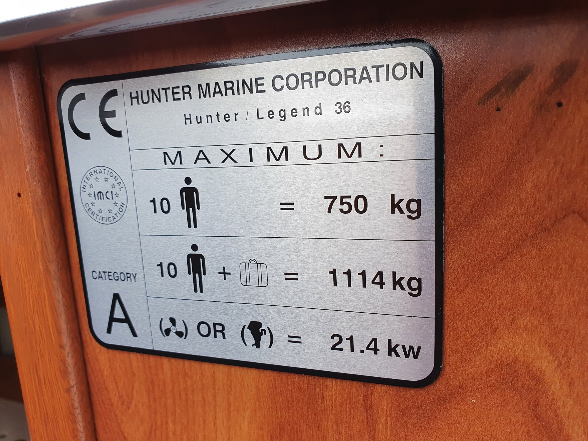

Hi Folks,
I'm about to buy a Hunter 36 with a Twin Keel. Now the seller sends me the CE certificate and in this, the boat is 4 cm shorter and 10 cm narrower than in the manual. It is also in category B and on the yacht the sign is category A. Do you have an explanation?
greetings from Germany
Michael

Hi Crazy Dave, in 2 days I sign the contract. Then I know more. Actually I have only the plaque in the boat ( see pic)
The Certification is B. It´s a Legend? I have no Idea, hope that the paperwork have more information about where she was builded

Problem is that the HIN number start´s with US, not GB.
If the vessel was builed in Great britain they have "GB" as first, not US,
It seems that a couple of vessels was built in GB but started with "US" in the HIN-number, is only a guess

First you advised twin keel. That style keel was made only in Great Britain. The. Plate shows a CE as A. The two page document shows a hull number starting with GB-LUH.
GB for Great Britain. LU for Luhrs Corporation and H for Hunter. Yes it was built in England.
