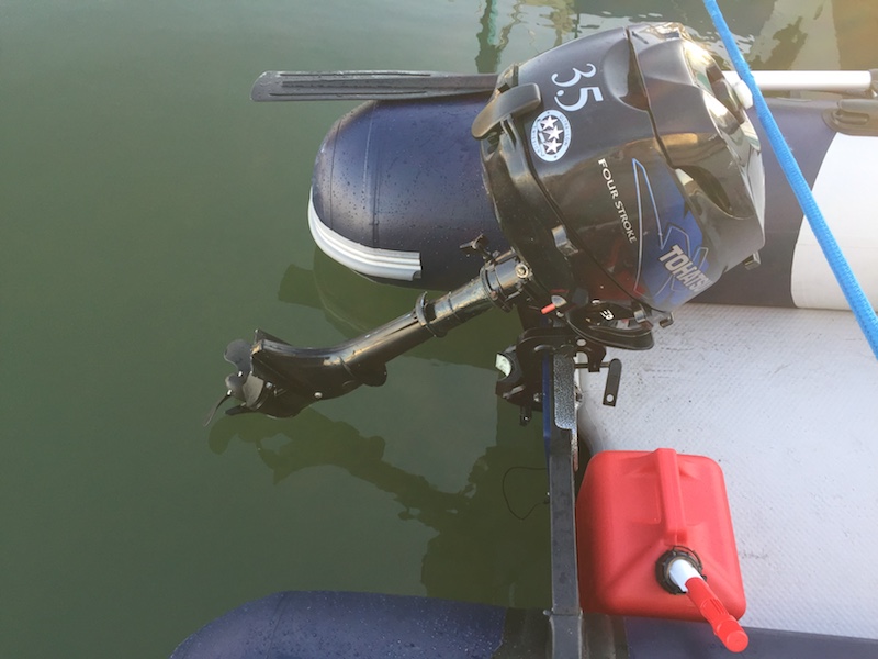

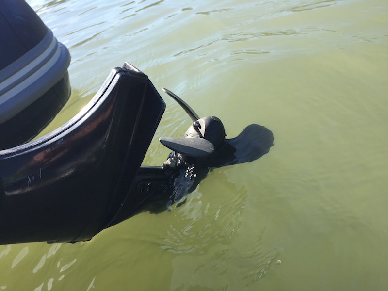

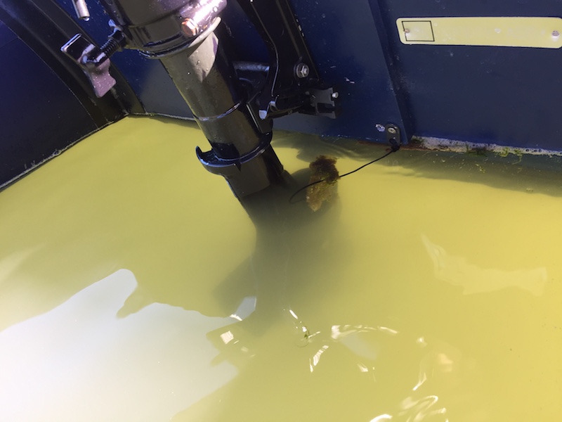

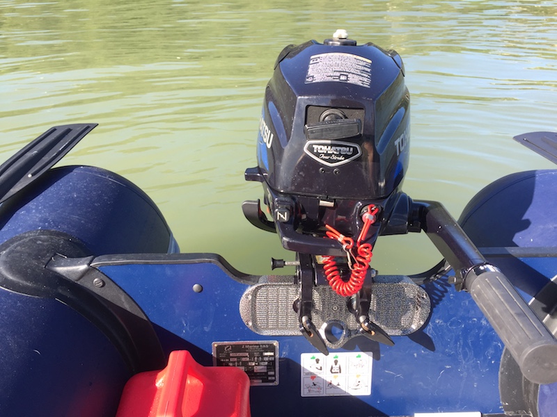

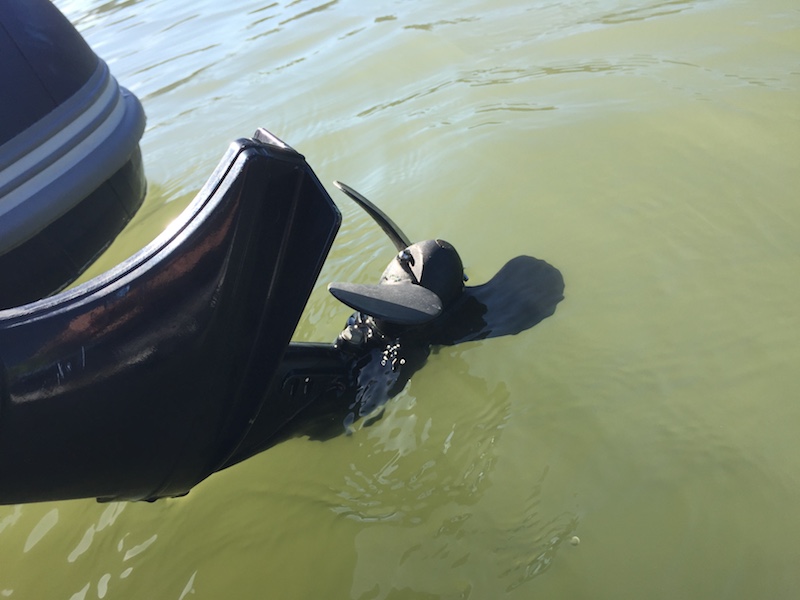

Hi there,

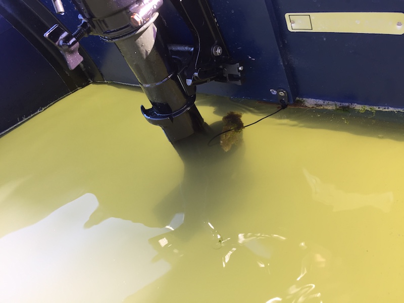

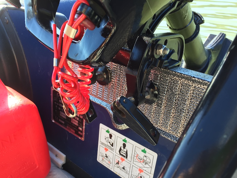

I have a ten-year-old Tohatsu 3.5hp 4-stroke mid-length shaft that cavitates like crazy as soon as I get on step on my 8' zodiac Zoom air inflatable. Adjusting the shaft tile to fully vertical helped a bit, I've tried mounting it higher and lower, and the propeller is apparently original with no adjustments available. Any thoughts? The prop is at least 3" under water.
Thanks!

Is it sucking air from the surface or actually caveatting? Sucking air is normally prevented by the horizontal plate above the prop. If there is a bur on the lower end that disturbs the water it can provide a path for air to get to the prop. Actual caveattion is caused by the pressure behind the prop (forward side looking at the boat) blades getting lower than the vapor pressure of the water and the water turns to steam. Note that caveattion does not normally cause loss of thrust but does erode the prop as the steam bubbles collapse and water hammer the prop while sucking air will let the motor rev up as the prop is running in air. Look at the low pressure side of the prop for pieces of paint missing, usually along the outer edges.

Sounds like the motor shaft is too short and does not accommodate depth of the hull and associated dead rise angle.

That could be. The shaft is the mid-length version and the dinghy calls for a short shaft, so if this is so this is surprising. The prop is several inches under the water, as shown in one of the photos.

Yes. When you speed up the hull rides higher in the water. It's a shaft length problem. If you could lower the mounting point (such as notching the transom where the motor sits) it should improve.

That motor looks like a standard length motor. Ken Cross says to cut your transom down and that is probably what you will have to do. Cavitation as almost always a prop too close to the surface. Porpoising of an 8' inflatable is usually caused by improper angle. Put your motor into a water barrel and submerge it exactly the depth it has while on the transom with it in gear to verify our contentions. As Ken points out though: this can't simulate the rise of the transom when moving. I think the barrel test will cavitate anyway. Chief

I guess it is a matter of how it is being used. I have the same boat with a wood slats floor and an inflatable V rib in the bottom. When the boat is on plane it will rise up in the water a couple of inches and that would be enough to get your prop too close to the surface of the water. I purchased mine to get to shore and back and carry provisions and never get it on plane nor have had any cavitation problems. Used to run a 5HP Tohatsu but replaced the heavy engine with one of the last 3.3HP Mercury two strokes engines to be legally sold (19 lbs.). Have you tried shifting your weight farther back? At 8' these boats were hardly intended to be fast anchorage cruisers.
That is very helpful to hear that the boat may rise a couple of inches, and it makes sense.

Thanks for that. The PO said that it was a "mid-length," but maybe it is just a "short" 15" shaft. Do you know exactly where to measure it? The dinghy manual calls for a "short shaft."
I just bought this boat brand-new and I am very apprehensive about cutting the transom! Maybe a motor with a longer shaft? Shame because I got this one for $400 and it's an immaculate fresh-water only motor.

It is a black plastic prop with no signs of wear.

Caveatation would erode a plastic prop in short order so I'm thinking that looking at the lower end while on plane might show where the air is getting in to ventilate the prop. Should see a stream of air "clinging" to the lower end and leading to the prop
