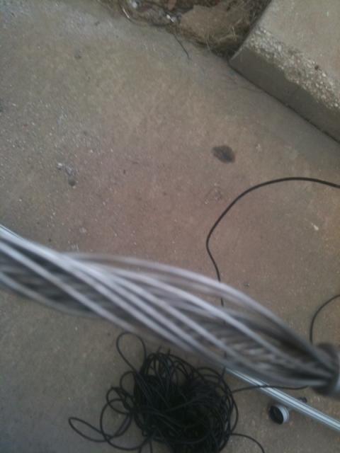

While deciding to give Jacob's Dream a complete face lift with awgrip paint from keel to maast step, I figured while she's undergoing that, I should step the mast and replace/check all lectrical and halyards on the mast.
The mast had been on for so long that they had a real hard time seperating them. The crane picked the ENTIRE boat up seem like 2 ft before the mast serperated from the step. My heart was jumping when i heard it go. Sounded almost like a shotgun blast. Close inspection afterwards revealed what looked like 2 or 3 tubes of 5200 around the step.
But what was scary is the shape my foil and headstay were in for the hood roller at top . Seems like halyard wrap had taken its toal .
Could not have picked a better time to replace it with a new harken unit 1 system than while she,s on the ground.
