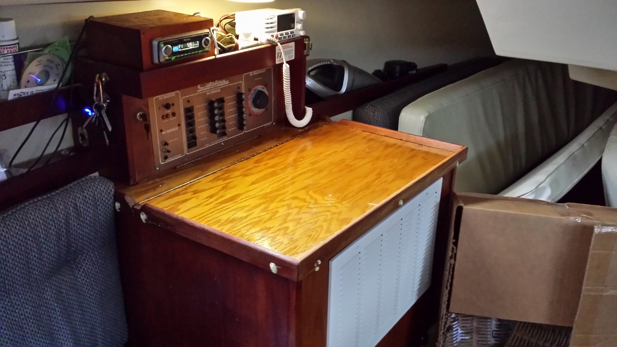

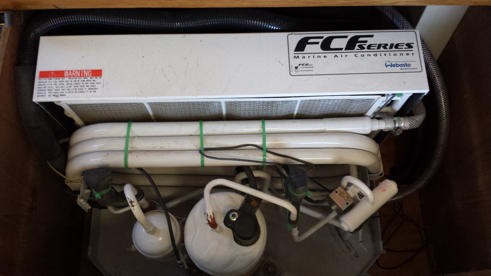

We have a 1985 C30, not a 28 and are located in Atlanta GA. We installed a Webasto FCF marine A/C in the Nav Station. Relocated the batteries to make room for the ducting. Originally had a 24,000 BTU unit that was too much, changed to a 16,000 BTU unit. Takes longer to cool, but will hold it once there. It is a reverse heat unit, so keeps the boat warm in winter as well. Ducting priamily goes down the starboard side under the settee and vents are in the cabin self, hanging locker and v berth. Added a venturi to drain the condensate, took over the macerator output for the A/C inlet (On a reservior, no discharge allowed.) and drilled an outlet above the water line. Did watch a dockmate heel his boat over in his slip to drill a new water inlet for his A/C. Pictures are of the 24,000 BTU unit, 16,000 unit is smaller and fits better.
I've seen several boats using window units, most were poorly done. I would guess the window units in the companionway need to be removed and stored to go out sailing. I replaced two 100W rigid solar panels that weighed 20#s each because it was a pain to have to remove them from the lifelines, I would imagine taking a window unit in and out will get old quickly as well.
