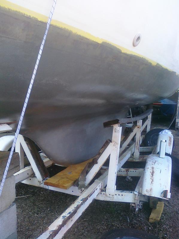

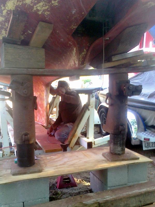

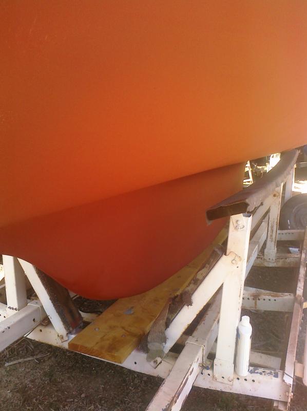

When I redid the bottom on the Luger barrier paint was recommended. I had the bottom sanded down to the original barrier coat and it wa worn through to the gel coat in some places so I applied a coat of barrier paint before the copper bottom paint. It was not expensive and went on quickly. It is the silver paint in the pictures.
Moving it from fresh to salt water may not be an issue. I understand the opposite is true in moving from salt to fresh.
The C27 I picked up in PA has the dubious honor of having blisters above the water line. The boat was partially sunk for what looks about a year. There are bisters on the freeboard but the bottom is fine.
