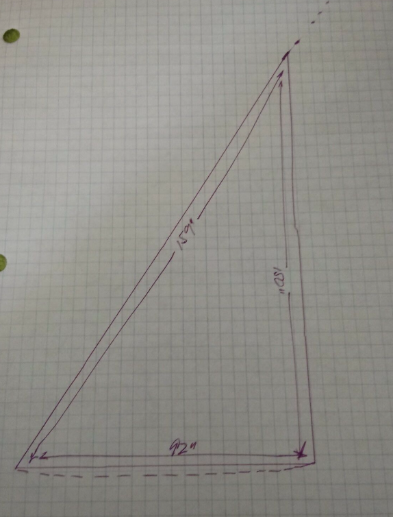

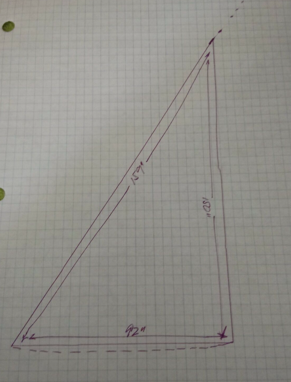

Your measurements compared to the I,J data for the boat.
I = vertical height. SBData 20 ft. 240" your size at 150" would have the sail a bit short of the height of the triangle.
J = the base SBData 6.5 ft. 78" your size at 92" would put the prosed sail shape at 110%. A bit beyond the mast on the foot of the sail. This would not be a bad foot length.
On a square foot size comparison. The Catalina Measurements indicate a jib sail at 65 sqft. The size in your drawing would be a sail of 47.9 sqft.

Hello,
I have a question. Would this size jib fit Catalina 18?
NO, absolutely not. It is the wrong shape; Just knowing the "I" and "J" isn't going to help you much if you don't know anything about sail measurement. A mainsail will have 90 deg angle at clew, but a jib, or any headsai ford that matter, will not.
Here is a link that will show you how measure sails. It also has your Capri 18 in its database with all dimensions and a quote for a new jib.
It is important that you take the time to learn the basics with any sailboat issue, from rigging and sails to anchoring, plumbing, electrical etc.

Dear Joe,
Thank you very much! Yes, thank god its winter and I can take my time learning, getting advice and doing some research. Your link is incredibly useful!
