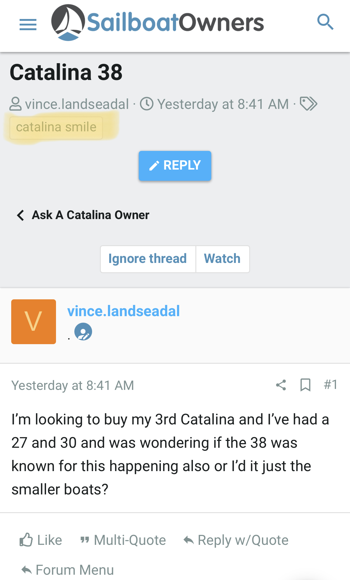

Possibly... Good Catch Holmes. :clap:
Perhaps why Vince has not come back.
It is always good to bury the lead.

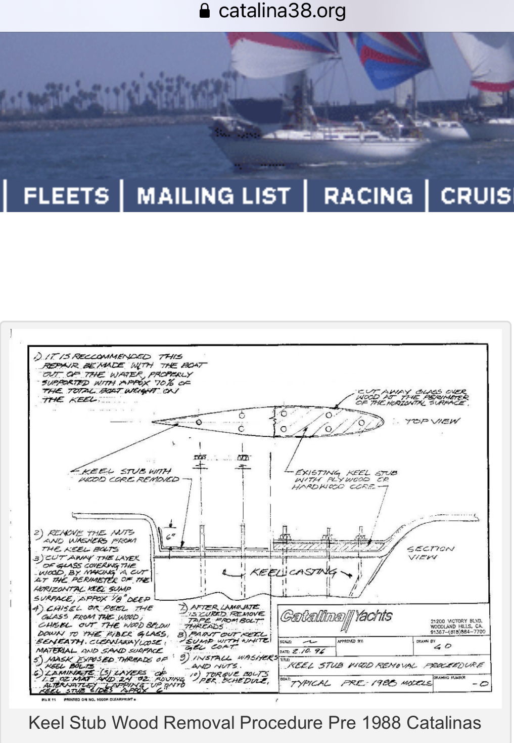

Assuming this is really about the “smile” I found this in the Cat 38 link that @Stu Jackson posted. It would seem that at least some of the 38’s had wood incorporated into the keel “structure” so it would seem reasonable that the smile would likely occur on those. Lots of info on how to address the smile on lots of boats from that era so I’m not sure what the concern is???
