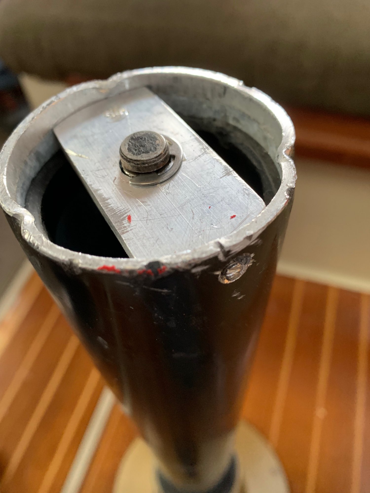

Here is a photo of the Aluminum centering support I made to replace the plastic piece.If it’s impossible to push down like Stu describes, the top plastic centering support is probably broken. Unless the internal strut is centered in the tube it won’t collapse.
