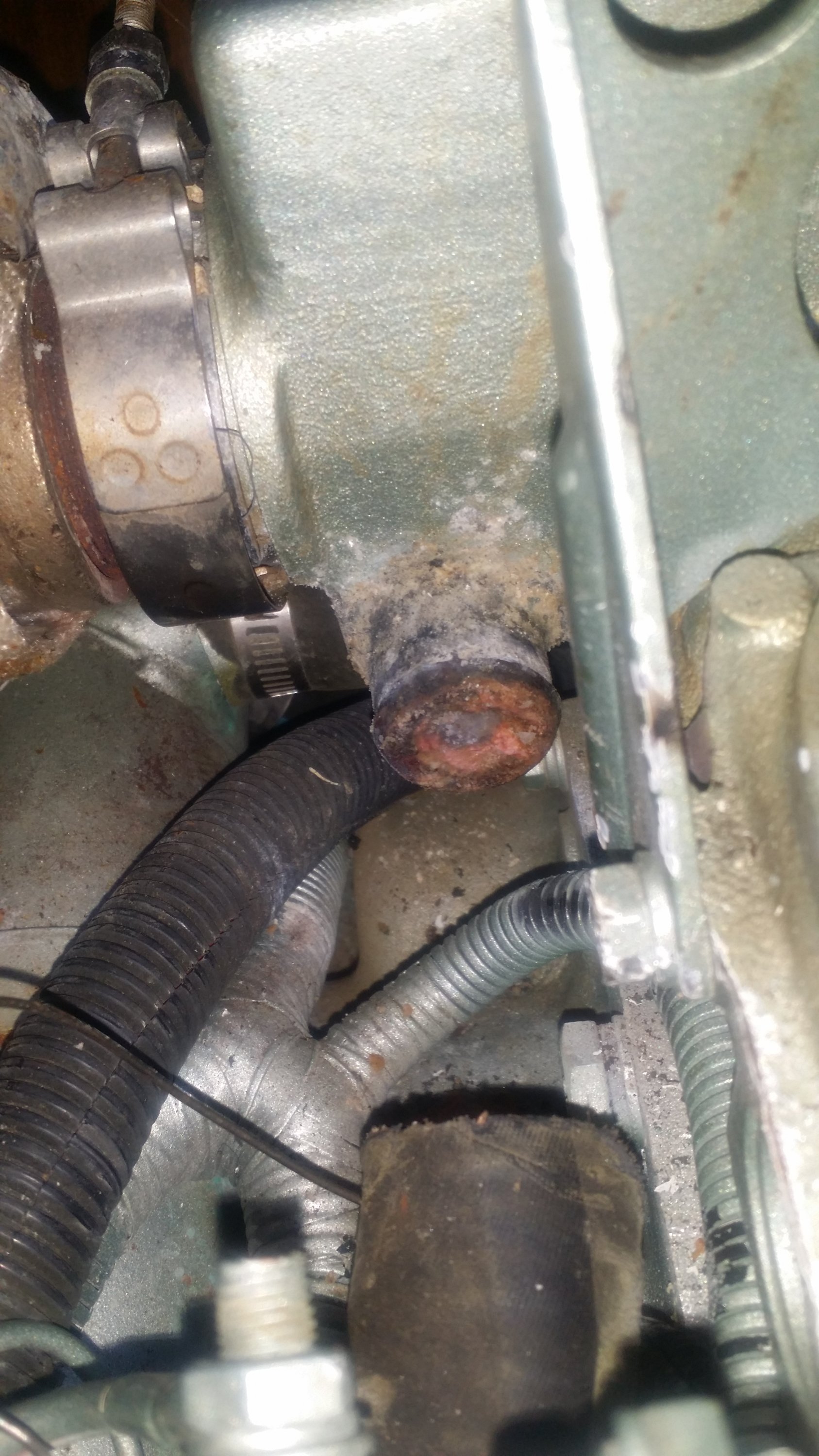

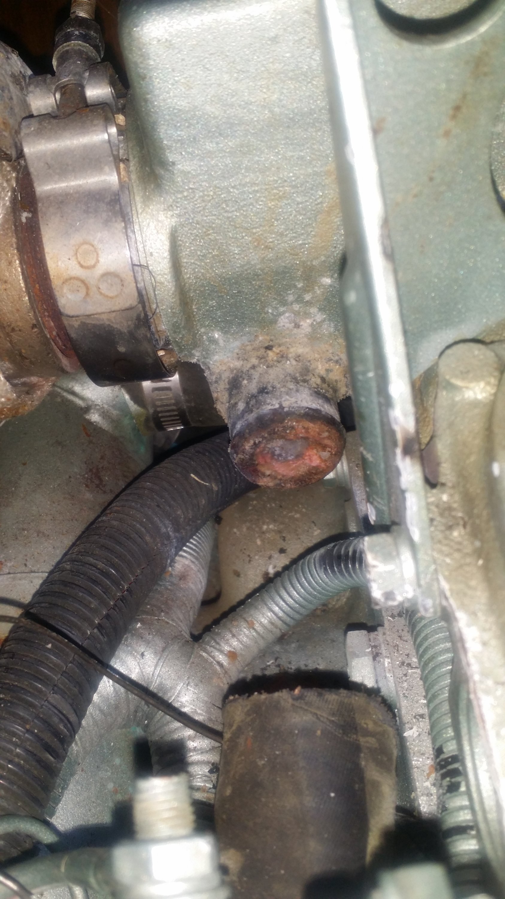

Removed the hose between the heat exchanger and the manifold. See the photo below. The manifold intake is totally blocked. Guess regular flushing the closed water circuit would have prevented this.

Yes. That's a clog. Sure enough.
If you got a spark then an electrical circuit was shorted. Some how you matched a wire with a positive charge to ground. Was the key turned energizing the circuit? That would be the way one of your sensors could be energized to cause a spark when you grounded it with the saw.
Did you need to reconnect any wiring after the sawing? Intermittent can mean the ground of one of your sensors is not securely connected. Could be old wire that has frayed at the connector. Could be a sloppy connector with a stray wire not secured within heat shrink. Could be a mismatched screw on a switch that holds the connectors to the switch but loosely.

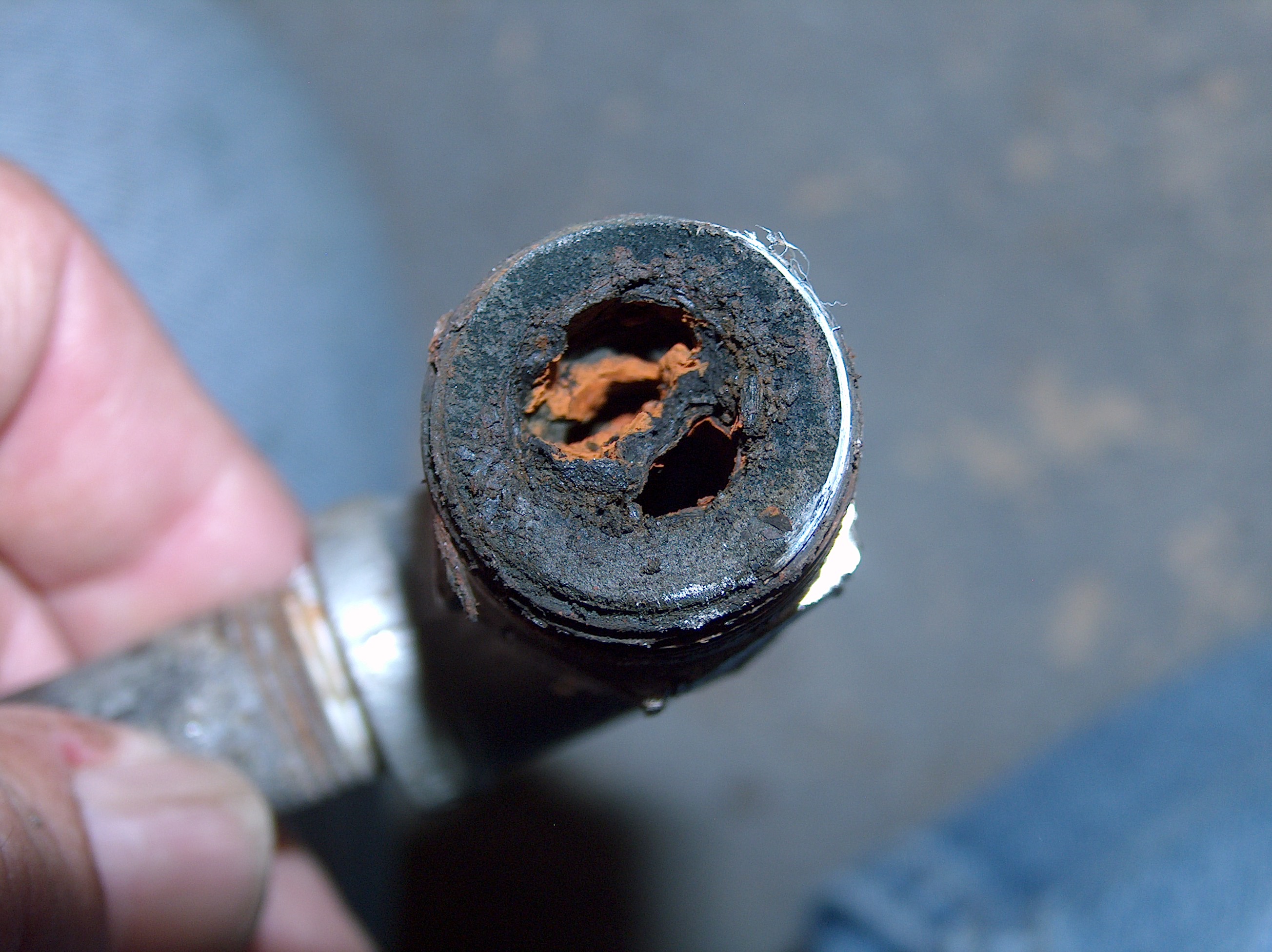

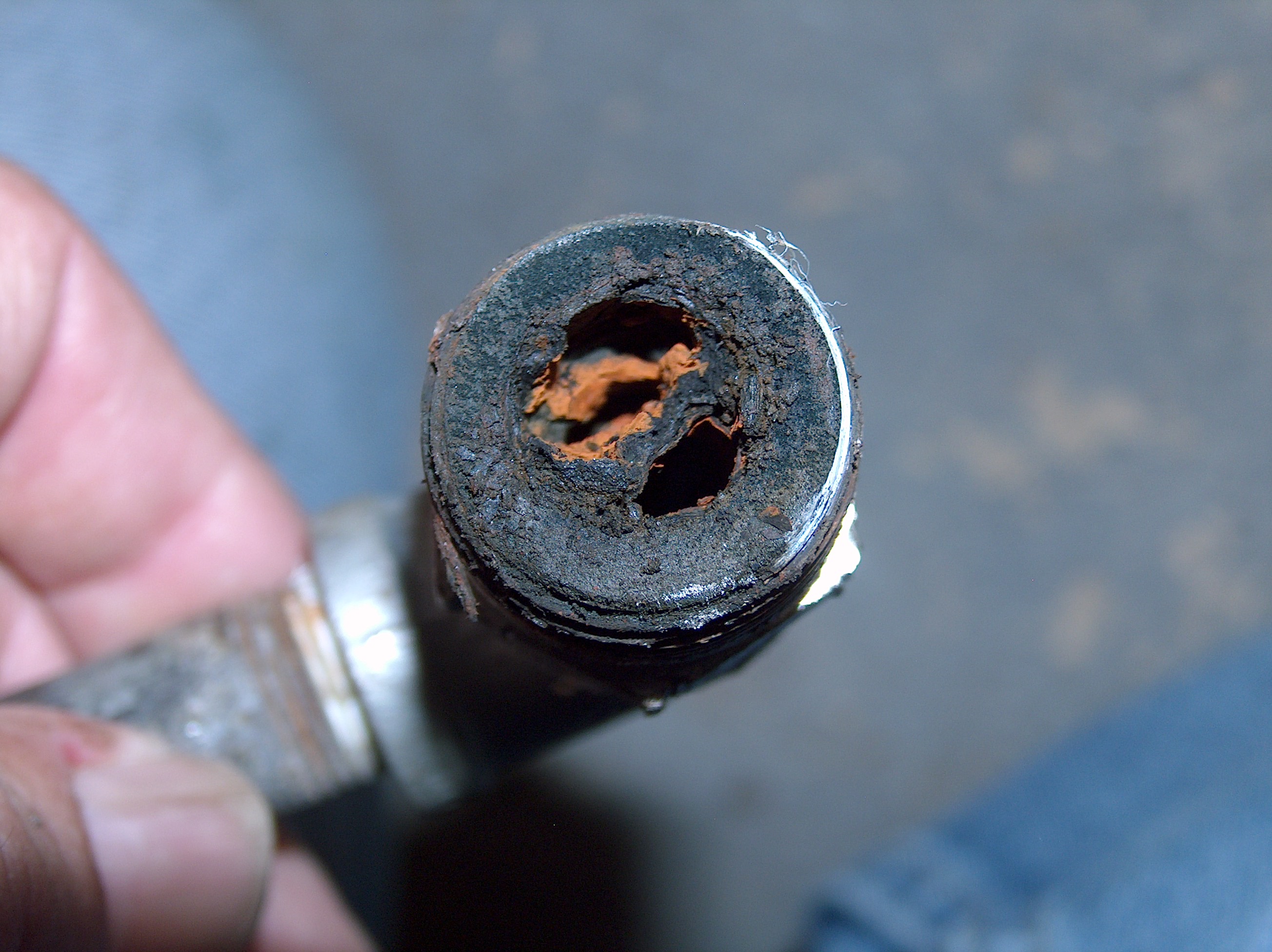

Here's what we found while removing the transmission. This is the raw water intake fitting to the exhaust riser. Surprising we didn't have any overheating issues other than a slight rise in temp while running at WOT
24,938
I have to believe you had a little bit of pressure inside your engine coolant system. Gives new meaning to "takes a licking and keeps on ticking"..... till it doesn't.

Y'know... you make a good point there! I'll bet that's why my raw water pump was seeping water from the bearing this past season!!! Can't wait to see how it works this year( I'd best be getting back to that transmission rebuild:poke:

Removed the hose between the heat exchanger and the manifold. See the photo below. The manifold intake is totally blocked. Guess regular flushing the closed water circuit would have prevented this.View attachment 132876
That doesn't look good. How often are you checking the zinc in the heat exchanger?
You should be checking the zinc every month at least. In Boston I could get a whole season out of a zinc. In the Caribbean it's around 5-6 weeks. I check mine every two weeks.
Based on this picture, I would remove the heat exchanger and take it to a local radiator shop for cars. Have them soak the exchanger and then pressure test it.
If it tests fine then put it on and flush the system multiple times with fresh water. Then fill with antifreeze and bleed the system. Look at the C34 tech wiki for how to bleed the system. I use the Mainesail method with replacing the thumb screw with a ball valve and hose barb.

Damn JK...you're WAY above the times! We still have the old Sherwood pump with carbon bushing! No seals beyond that. Still have one more new bushing to use before doing the Oberdorfer upgrade, but this one's still pretty tight! It always has seeped a few drops here & there, but lots more in 2016. We'll see how it goes with the new exhaust elbow & fittings. Otherwise, everything else in the system is clean.
You make a good point about the HX zinc. Because the P.O. did virtually no maintenance, we had to replace the HX when we got the Merry Bee 16 years ago. At the time I didn't know what that little brass plug was for cuz' there wasn't anything on the inside:yikes:
