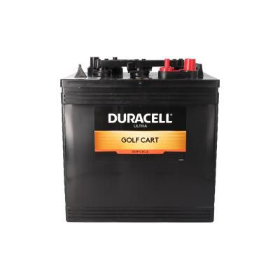

We have a 2000 310 and yes we have a port lists. We also have 4 6 volt golf cart batteries and tools and other supplies in the port storage, total weight around 400-500 lbs. When we need new batteries I'll be changing to Fire Fly this will reduce the weight by 160 lbs also check around as most of the storage on the 310 is on the port side so it not just batteries.

I have had Tess Too tie up along side a few years ago and at that time the listing was no more that what we have, about 3 deg. Like I said before the main storage on the 310 is on the port side and knowing this we try and place any heavy objects on the starboard side ( fill the fridge with beer and have 20 lt of wine, food optional).

As an avid 310 fan there is one flaw I don't like that Catalina did. Your large lazarette, large settee, batteries and holding tank are all on the same size. In theory they balance out with the galley. But it's very easy to stuff the storage on the port side full and have very little to offset this. The starboard settee storage is smaller. Depending on how full you have the dry storage, fridge and cabinets in the galley you might not be balanced. Being that the boat is for sale my guess is all the galley storage is empty.
On a cruising boat I offset this by having two 5 gallon cans of fuel, a 5 gallon can of water and a kayak on the starboard side. This is to offset all of the weight from my tools and spare parts (my battery bank only weighs 60 pounds).
I suspect that you will find that simply loading the galley and moving a few items around and you will find her balanced.
