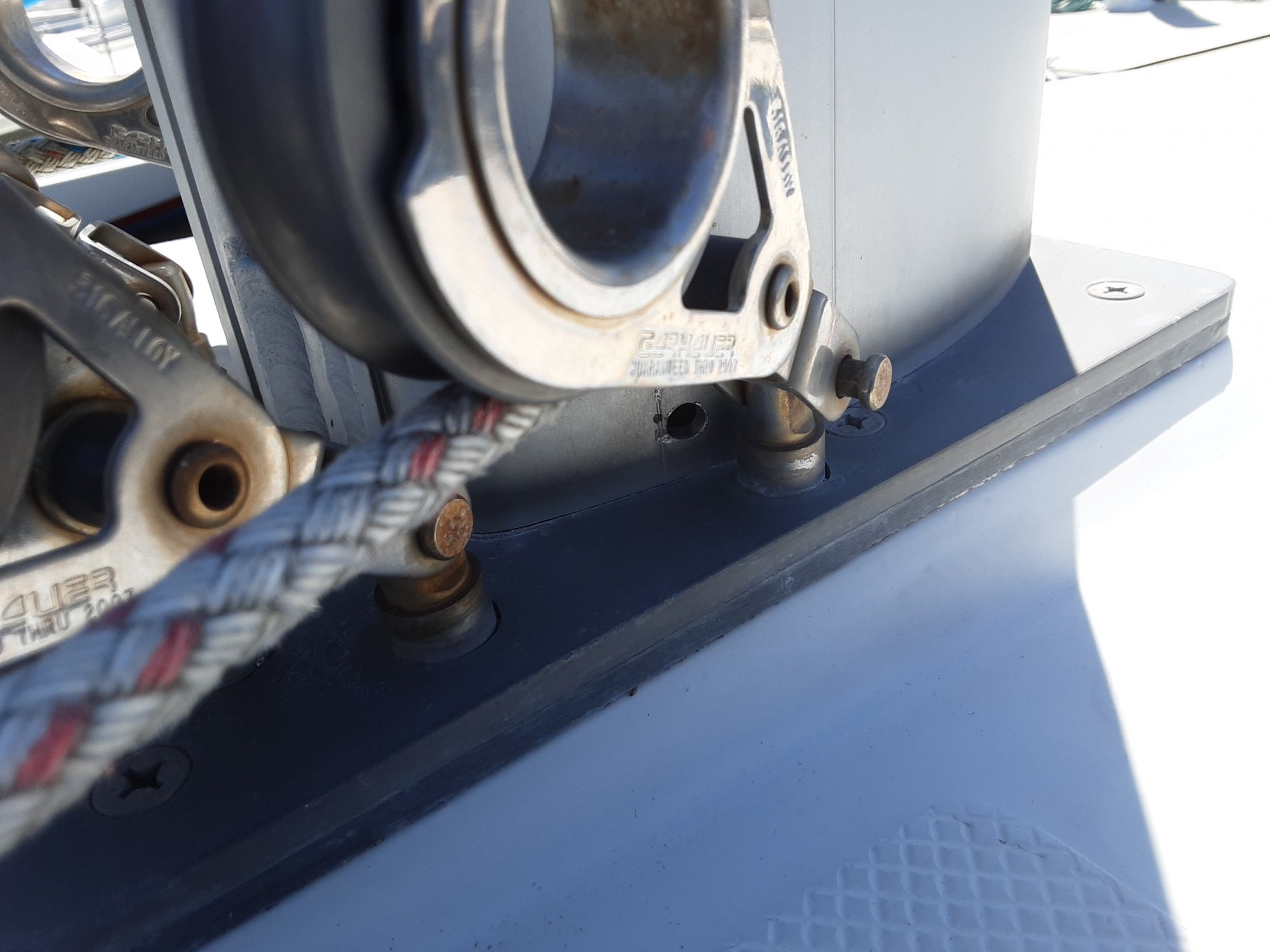

I drilled a hole in the bottom of the mast that solved the problem.
I tried a hole, didn't work. The rain comes down so hard, it fills above the lip inside the base of the mast before it can exit the hole. I'm afraid to make the hole larger than its current 1/8"

I believe I drilled at least 1/4", but will check next time I get to the boat.

Perhaps my hole is too small to do the job.

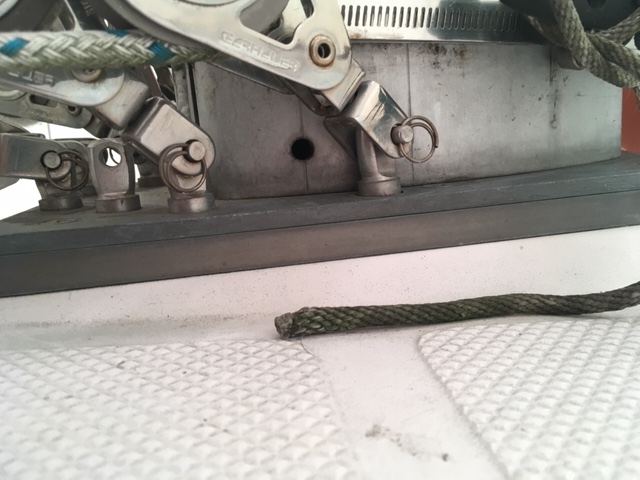

I think it is 5/16"
Thanks for the picture. A couple questions, (1) would it help if the hole was lower on the mast, ie: closer to the base? and (2) do you have 2 holes, one on each side?

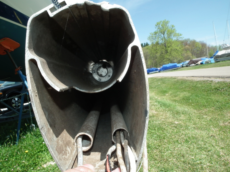

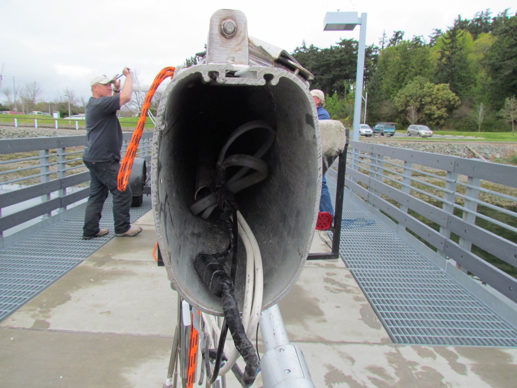

Thanks for the photos. When you demasted was their something in the hole that was acting as a barrier? When I was trying to run a wire for a new wind gauge it was getting blocked.

Photo is of the furling Charleston Spar mast. Note the conduits taking the wires to the top. Perhaps this was your trouble. Note: not a picture of my mast. I downloaded the picture from this site.

No just the one hole. Not sure how far the tube protrudes out of the deck, but mine may be a bit higher thus the hole is lower and drains before the water level can top the tube.

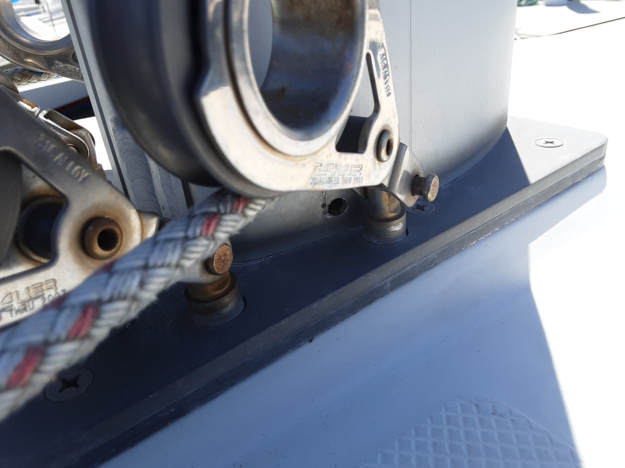

Here is a picture of the 1/4" hole that I recently drilled in the mast base. After a rain storm there was no noticeable difference in water in the bilge. Another hole or give up? Not sure...20200422_134022.jpg

Here is a picture of the 1/4" hole that I recently drilled in the mast base. After a rain storm there was no noticeable difference in water in the bilge. Another hole or give up? Not sure...View attachment 177964
bob
My experience after drilling a 5/16 hole was the same. No difference in amount of water in bilge after rain.

Have you positively identified that the water is coming from the mast base? It should show up in the front section of the bilge first. You can further eliminate sources by taking a rag and put it under where the wires come out of the tube and see if it gets wet.

Another diagnostic trick is to draw a line border with chalk in the bilge or other suspected leak source, and observe where the line is broken. Good luck!

Definitely coming into the front section of the bilge but have not tried your idea. Will give that a try.

On the Charleston Spar furling masts, there is a direct channel from the large opening housing the turning screw down to the bilge. Any time the wind/rain is from the aft quadrant, water entering goes directly into the bilge.

If you determine it is coming from the mast. Your hole may have to be bigger. Another variable is how high the wire tube projects into the mast above the deck.
I"m on a mooring so any time it rains with wind it is directed from the front of the boat. If you're in a slip that would not necessarily be the case, driving the rain from the stern would direct more of the water into the mast slot.
