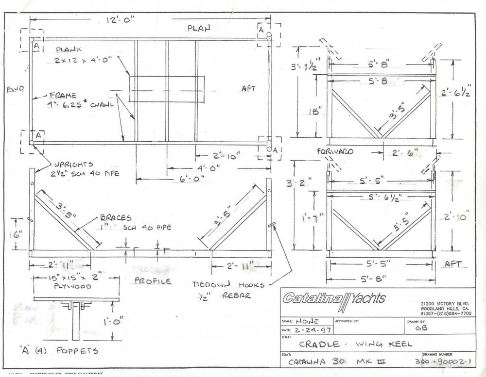

Hi All:
Hope your getting a lot of sailing in. I would like some feed back on the Steel Folding Cradle used for the Cat 310. I have a picture of the one that came with the manual shown below. It says Catalina 30 III. Now will this be usable for the Catalina 310? Mine is a Wing Keel. One other thing there seems to be such a discrepancies in drafts. From 4 - 4" to 4 -10".???
My boat is #247 2003.
Cheers
