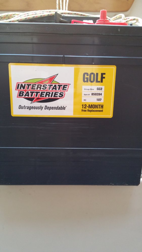

I just got 4 235A (20hr rate) GC2’s for $620+tax but they were FLA.

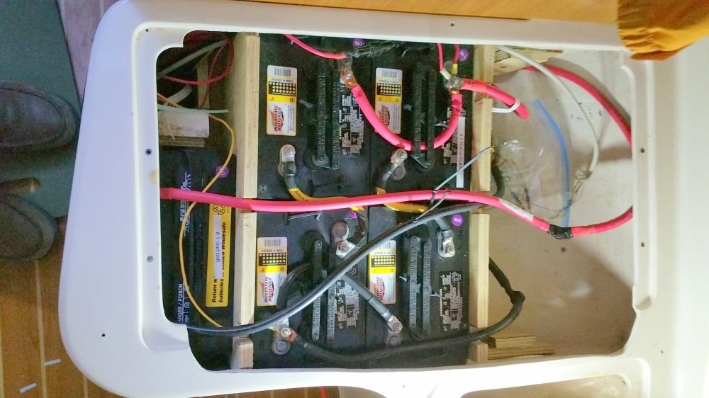

@paulj. Get some MRBF fuses in there. Also what is under the tape on the red wire on the right side of the pic??
Read 1/2/both on Mainesail’s forum.
