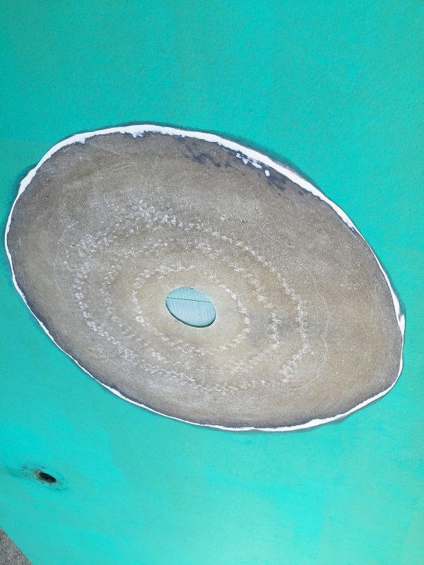

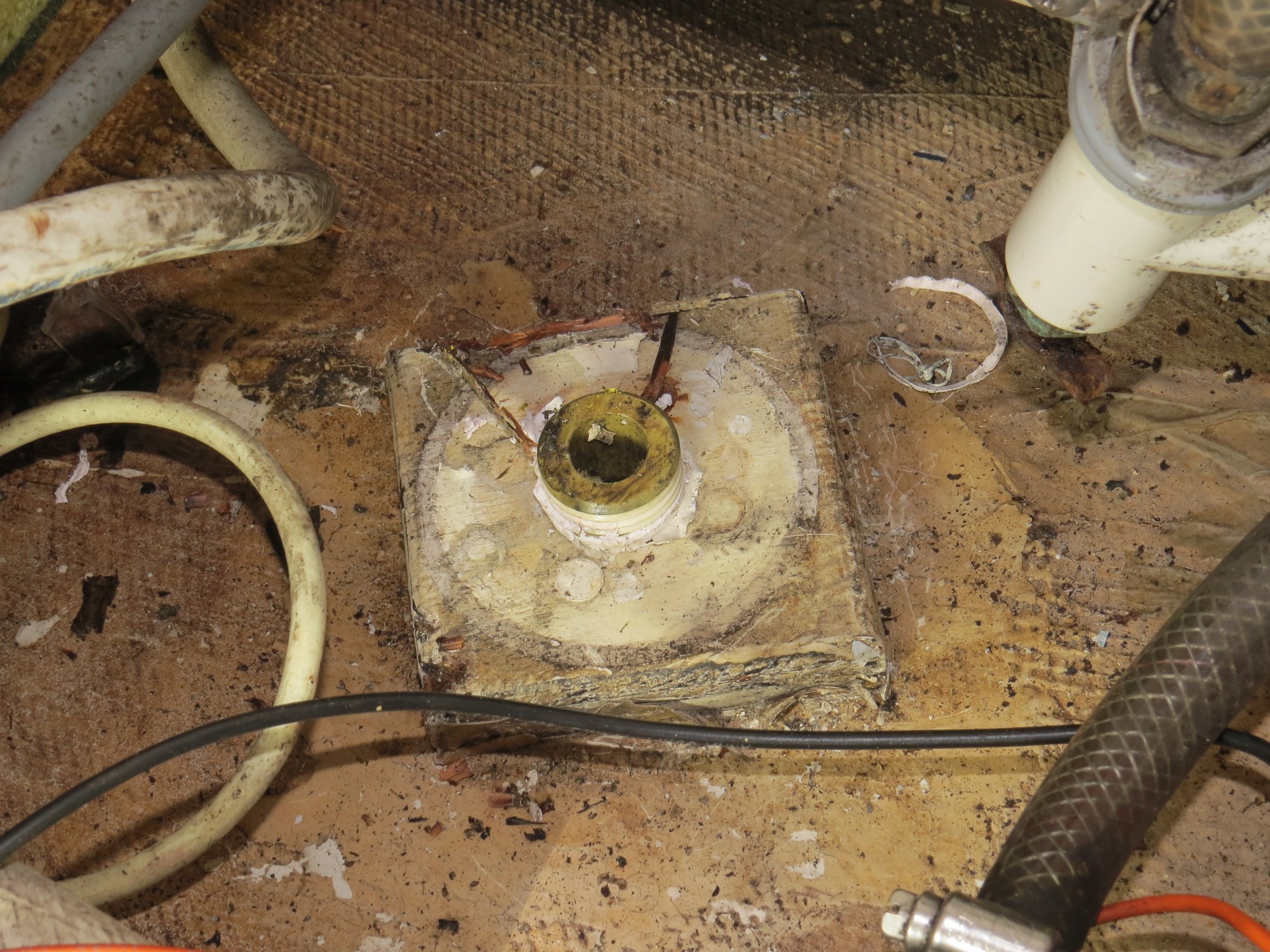

Here are a couple of pictures showing the rotted backing plate before and after removal. I am just sealing off the male fitting with epoxy putty, making a new backing plate, and screwing back on the old valve. Better to let a little grey water from the sink go into the bilge than a lot of sea water
Where are you planning on putting the epoxy putty? If you’re making a new backing plate and still having a valve, why would you want gray water into the bilge instead of out the valve? As others have suggested, letting the gray water into the bilge will make a mess that will take lots more time and dirty work to clean than fixing it now.
